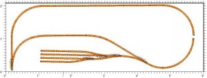

Just got back from the LHS and bought all the track and a book.
The book: Atlas' "Introduction to N scale railroading"
My layout plan: N-2.
I flipped it upside down because I want my yard down at the bottom left. I think this layout has ALOT of potential for expansion off to the left where the end bumpers are.
I've finally decided that I am going to model the California/Central Pacific and Union Pacific together. Steam of course. I can already see the Sacramento River and the Sierras on this plan...
What do you all think?
It's a perfectly good little layout, but are any of your turn radii smaller than 9 3/4"? Are those foot markers on the graph?
If your turn radii are too small you will not be able to run engines with trucks that have more than four wheels. Larger steam engines generally have larger trucks, ie. 2-6-0 Moguls or 2-8-0 Consolidations - and then you get into the really big ones.
Yes, those are 1' markers. I drew this in XTrkCaD from the Atlas book.
They are mostly 9 3/4" with a couple 19" in there. My newly bought Bachmann 2-6-2 UP engine is going to run on it initally, hopefully without a problem?
I would really like to run at the largest a 4-8-4 with 8-8 tender. Will 9 3/4" not work for one of those? I'm not sure if they even ran on this line, but I'm mostly in this for fun and not really too concerned about exact replication. (At this point anyway)
The 2-6-2 probably won't have any problems, but the 4-8-4 ??? I don't really know. Before you buy one, see if a dealer can put it on a tight turn for you in the store. That's a lot of money to spend on an engine you end up putting on the mantlepiece for decoration.

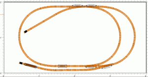

I ended up adding 25"X72" to my layout to form an "L" shape and I am going to connect off the outside siding from the previous layout. My only problem is the little gap at the right of this new layout. How do I get around that?
Also, what do you all think of this? Does anyone have any better suggestions? (I'm sure there are plenty of better suggestions)
If you use flex track instead of sectional track, you won't have that gap, and you will eliminate most of your rail connections which eliminates potential bad connections. The yard will function better if the balloon track (return loop) is tied into it which would allow a run around track so that a road locomotive could bring a train into the yard, uncouple and move out of the way for a switcher to break up the train. You could probably get a bigger yard in by using the center of the balloon track for the yard, maybe make the tracks you drew into an engine terminal, there might be room for a turn table and small engine house in that area. I'm not sure how much space stuff takes in n scale since I model ho.
I like the first one better because it has a longer mainline run. Is the crossing a cross over or an over under? I would consider eliminating the inner loop on the lower left quadrant, it doesn't seem to serve any purpose. Instead I would put some industries for switching interest in that area. In the yard at the top, put a switch right where the track comes out of the curve at the top left just past the crossing and bring it around to the inside of the mainline loop to create a long yard lead. Then put your yard where it is with another crossover in the end for a run around track to get an engine out. I think you would still have room in that area to bring another track off the yard lead to an engine facility near the yard.
I was thinking for that first one that it would be an over and under. The yard at the top would be a ground level backed up to the side of a cliff or something and the track would be running along the side of a mountain above it.
That other double loop track already exists and I don't want to change it (very much). I'm not very good at this planning thing, and all I know is that I definately want continuous running. It would be nice if I could get that yard to attach back to the main line again because I really hate seeing engines running backwards.
Then you won't like the second one. It has one return loop, so trains that turn using it can't turn around again without backing up. This would be acceptable if this were an out-and-back/continuous hybrid, but the yard would have to connect to the main the other way for that to work.
The first plan has the longer continuous run.
I hope you all aren't getting too annoyed at my constant changes and requests for opinions.:oops:
I think I am really too new to this hobby to be trying to plan such a complicated layout so early. I learned how to use RTS since XTrkCaD only allows max. 4x8 layout. Here is what I came up with most recently. Will flextrack connect up with atlas snap-track simply with rail-joiners just like snap-track to snap-track? Is a newbie with flextrack a quick route to disaster? I only think I need flex for the inner/upper level main line where you see the gap.
