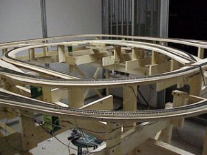

Well, I have asked too many questions, and since it's Thanksgiving I thought I'd share my progress on the layout. I started it in May 2003. I used code 83 and code 70 Shinohara and 7 #6 and 1 #4 turnout onto a siding. My rail is spiked into true-scale pine roadbed ontop of 1/2" ply subroadbed. I used all Tortoise motors in conjunction with DS44 Stationary Digitrax decoders so that I can throw or close all turnouts on my handheld unit (this is fun!). My train room is 12x12 and the layout is 8x8 and I am planning coming off with a 2 1/2 by 10' "L" for more industries and turnouts.
So, here's the photos!

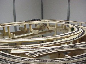

Layout Photo 1
It's in a horse tack room. At least I don't have to feed it.

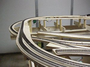

Layout Photo 4
A tortoise ... well worth the extra work to install!

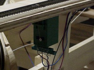

Layout Photo 5
I used "edge connectors" on my switch machines to make soldering and troubleshooting a breeze ...

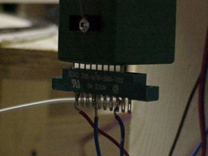

Layout Photo 6
They disconnect so you can solder your leads on the bench rather than to the Tortoise itself. Much easier.

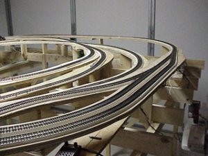

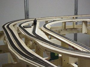

Layout Photo 8
Track is solid and trains run great - using a Athearn Genesis USRA 2-8-2 for testing. Steam gives you the best feedback on track quality. I recommend making sure of this before moving on.

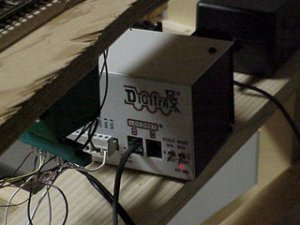

Layout Photo 9
For my rail power I am using the Digitrax Empire Builder. The last photo - thanks!

This is my first HO layout, so I really appreciate the kind words from all of you so far. Hardly a craftsman! The only other layout I have done was N scale on a 4x8 board using Atlas sectional and DC power. I lost interest because it was single dimensional and using all of the Atlas buttons and sliders was confusing. DCC is alot easier once you adopt and understand the basic concepts.
I really enjoy buidling the joist and riser benchwork. It fun to change elevations. I will use the cardboard strips and plaster towel method (Dave Frarry's Book) to start the scenary. Last night I was experimenting with weathering the track. I used "roof brown", "rail brown", flat gray, and flat black (very sparingly). I thought I would have to mask the tops of the rails, but I was able to wipe of the paint off the tops.
