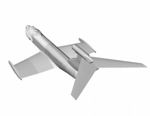

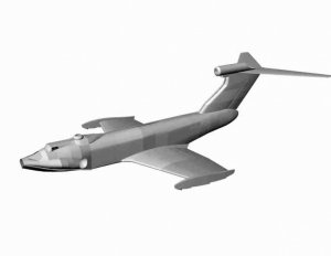

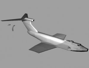

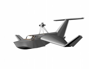

Being a vintage audio tube amp/preamp collector, I cringed at the last statement, but then reality set in. Do you think you could post your supplier for the micro servers etc. that you are using? I also am designing an A90 Ekranoplan and am very tempted to make a R/C version of it, or of the smaller ESKA, both which eventually will be released in paper. (the Rot of the Rudder on the A90 is off, I know and am working on it:mrgreen:).

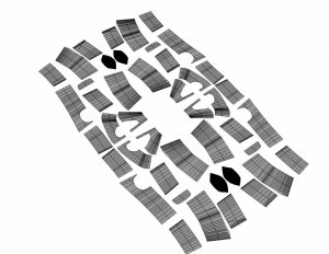

Beautiful - what CAD are you using? How do you flatten your 3D forms to patterns? I still haven't found an inexpensive CAD that really helps me much. So, I still design by successive cross sections which I connect with linear shot lines which I split into facets which I reconnect on a 2-D surface. It's all automated (my own programs), I just digitize points and print the patterns from vector files. I've had to learn a lot of conical geometry over the years. Every airplane I design is intended to be air worthy and a fairly quick build. If you look at my other thread on this forum you can see examples of my work - including a 12' by 6' SAAB Gripen fighter jet, which is a display model exception to my rules.
I have purchased from HobbyKing.com and HobbyPartz.com and have had good experiences with both. Shipping can take a while, but the overall saving are impressive and the quality of the parts has been good so far.
I use Rhino 4.0. I was a machinist for 16 years (among too many other trades) and programmed 4 axis CNC machines, and made all the fixtures and tooling for these machines at Sikorsky Aircraft. In Rhino4, you can make the profiles, which are called "Rails" and connect them with a line, or curve, which would in that operation be called a "Profile curve", and then you would use the "Run 2 Rails" Command and create the part. If you use a straight line between the profile curve, you can then "unroll" the developable surface. It is important to keep this in mind because a curve as a profile curve could not be unrolled as it would be a compound curve. I have attached the nose of the craft, unfolded, not rendered, to give an idea of what is going on. The nose section is doubled, this model's nose section will take some patience to make, but all parts fit.. The picture is a practice fit made of the unrolled pieces you see. They all fit. I make it practice to 'unroll' every part before I move forward.
A fully working version of Rhino4 can be downloaded. After 30 saves, it loses the ability to save but still can model. It is a great way to learn the software. If you are a student (or know someone who is, hint, hint) you can get it for a fraction of the price! Really really cheap.:curse:twisted:

Very fine! We get to the same pattern place (yours look very familiar) but by very different software means.

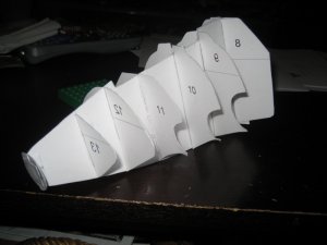

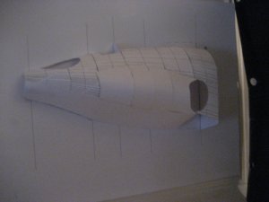

Traditional card modeingl approaches don't work well for me. I tried to fly commercial card stock kits as a kid, but found them to heavy, too fragile and too labor intensive to risk. So, I had to innovate on my own. No home computers back then - I actually made a lot of pretty decent looking and reasonably functional models entirely freehand, using a ruler, a scissors and a bottle of glue. Crazy really, but I didn't know any better and I stumbled upon a lot of tricks I still use. I really learned a lot about how paper works.
I use very light weight paper and pay a lot of attention to internal structure. At the same time work hard to keep construction simple, quick and easy. Most of my designs resemble modern nuke subs - you build each fuselage element separately and pop them together at final assembly.
My father ran a small engineering business specializing in one-off wind tunnel models for the big aviation companies. He also did some radar x-section models for the early stealth AC, but I never saw any of those (double secret highly classified). My brother is a 1st gen CAD/CAM engineer and he brought the firm up to speed on this technology. Tough way to make money, the new technology made everything very fast, but lowered profit margins. It displaced a lot of incredibly skilled old school machinists.
I'll have to look at Rhino. I've tried the freeware SketchUp and was impressed, but the unfolding tools are a pay add on.

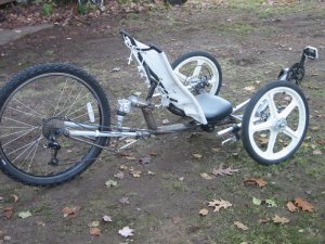

Got sidetracked, I have trouble riding a bicycle, so I figured I would try and buy a recumbent trike,until I looked at the price. So, I made one. In my prime, this would have been a weekend project, but it took me a month. I have attached a picture. Disc front brakes, rear suspension, air shock. Cruises easily at around 20 miles an hour. My own design. It is made out of .050" wall thickness exhaust pipe stock (mild steel). Canondale Bicycle Corporation donated to me around $3000 dollars worth of accessory components to help me with my projects. Very very nice of them! My recumbent bicycle only weighted 10 ounces more than their aluminum one, mine was steel! They were impressed, then handed me boxes of parts. I have attached a pic of the trike. 24 Speeds. Your arms are straight down and if the trike tips on a sharp turn, you automatically lean into the turn, pulling that side down,very functional. Still very hard on my lower Spine though, unfortunately. The Ackerman and castor and camber of the wheels was calculated out on Rhino4. The steering knuckles are extremely heavy duty Heim Joints and I machined aluminum hubs for the plastic wheels, pressed in road worth bearings and mounted the disc brakes to them. All parts were machined from square stock T6061 aluminum and the only ready made components are hardware, bicycle parts, such as derailleurs, chains, sprockets, etc.. Frame was fit using a tubing notcher and Mig welded by me. It also, (obviously, by it's Rue Goldberg appearance), designed using the "form follows function" methodology:p
Next project will be a Velomobile, with electric assist( actually, pedal assist, I plan to circumvent the law!).:twisted:

Yep, old school machinist! Beautiful piece of engineering & craftsmanship. Weighs in at? 20 mph is pretty impressive, wonder what you could do with a fairing?

I feel like I am really ruining your thread, I am so sorry. The trike weight has escaped my mind. It is comparable in weight of any commercially available trike, probably a little lighter. The seat came off of a recumbent bicycle and the seat framing is made of aluminum. The mesh for the seat came from a fabric store, the same stuff used of furniture, quite strong. Aluminum bicycles are actually too rigid (Canondale's anyways) The large diameter of the thin walled tubes does this. I have a friend, Frank Strnad, that makes incredible bicycles. He uses .010" thickness frames and does not believe in aluminum for his custom bicycles. I have not seen him for a while, as I moved from Ridgefield (snooty little town) but he is an incredible person. He sold me his Miller Econotig for $300 bucks, it is virtually brand new!

My trike weighs in at around 30 lbs, a little less. It is a lot, but not that bad for a recumbent trike.
