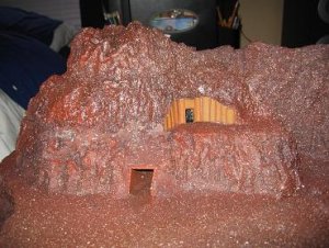

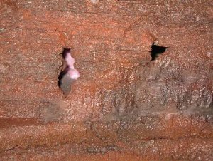

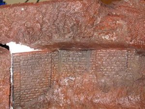

Here are close-ups of the aforementioned mine, the rockwall, and the bluffs and caves. When all is said and done, the rockwall will be painted stony gray and I'll stuff something behind the caves so you can't see clean through the layout.

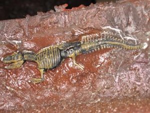

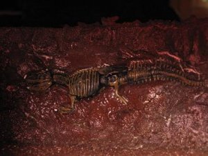

Dr. Carter, from one of the big museums out east, has made the find of a lifetime with this well preserved Tyrannosaurid. One picture has too much flash, the other has too little. This needs to be touched up a bit, I'm going to plaster him in there a little better so it doesn't look like he's about to jump out.
