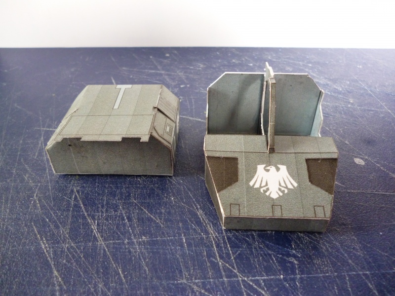

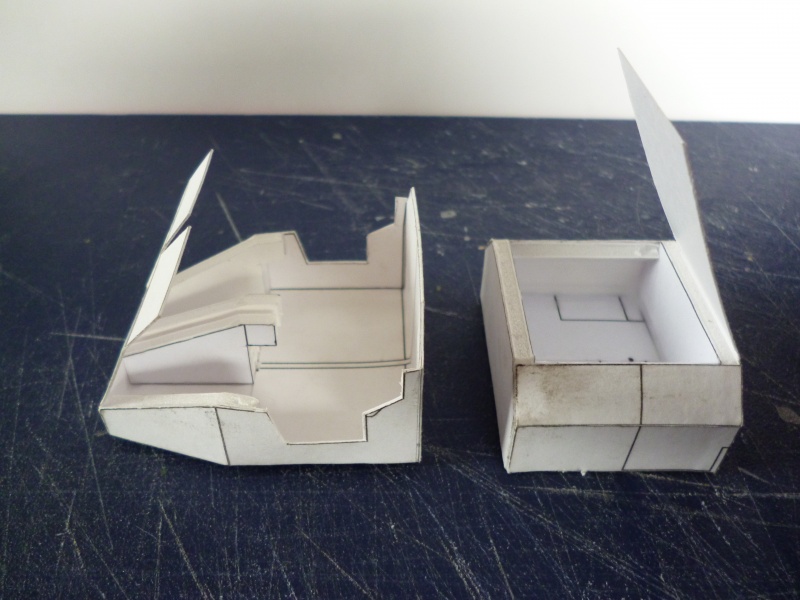

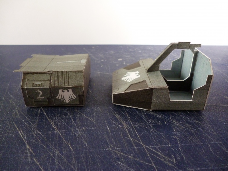

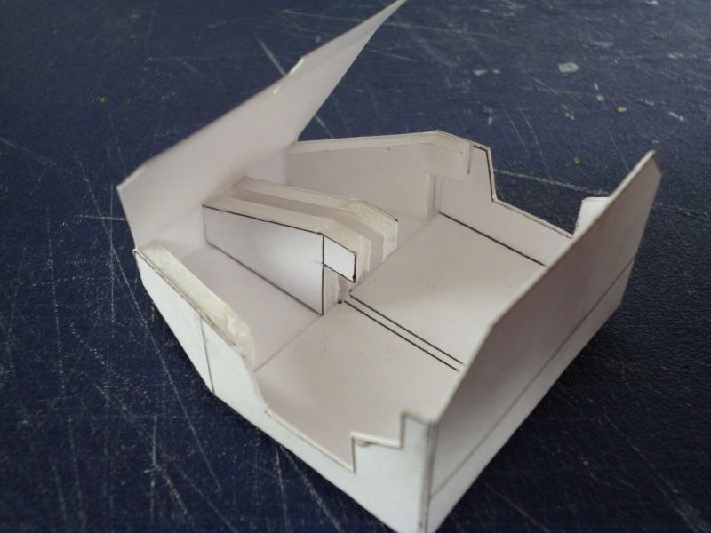

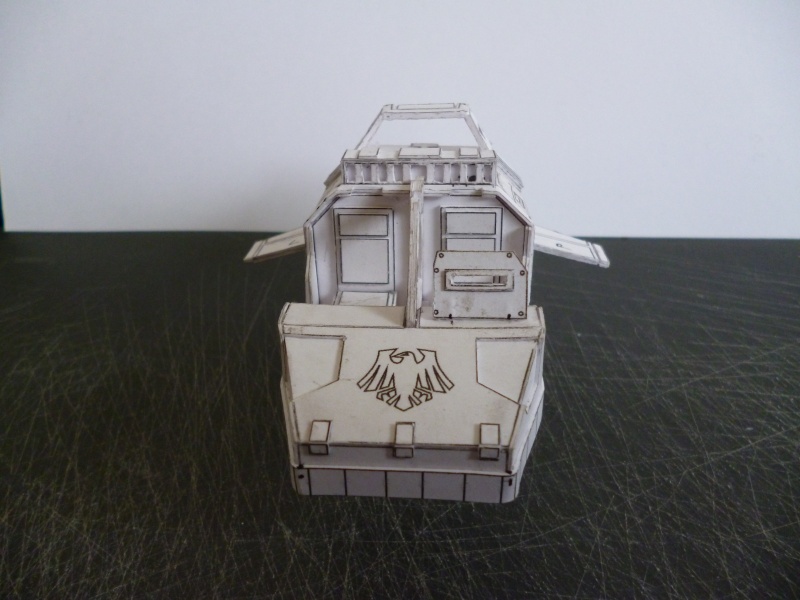

Hi,
I started building a Landspeeder from plans I found on the web.
After some building it didn't turn out the way I wanted.
The straight panels were curving and the details didn't come out that well.
So I started over, but this time doing it my way.
As you can see I addded some ridgidity with foamcore struds to help keep the straight panels nice and straight.
Mayby it is frowned upon but it helps me get some results for the moment.
The model is coming along nicely, except for the dirty look.
I tend to get a lot of glue on my fingers.
I 'll hope to get some more pictures to you very soon.
As always, any response will be grately appreciated.

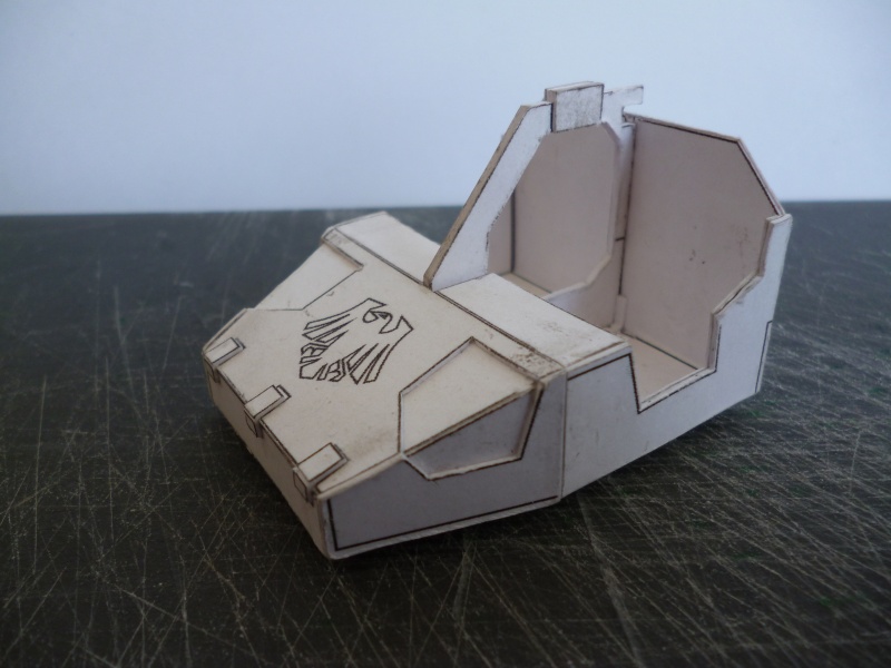

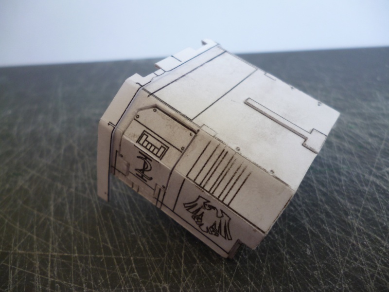

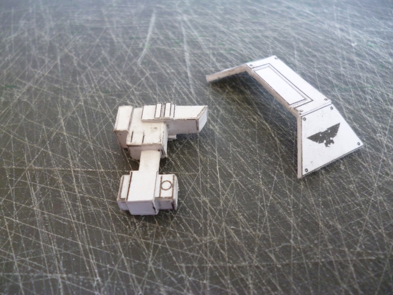

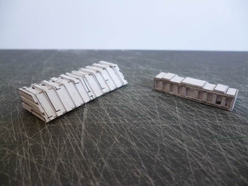

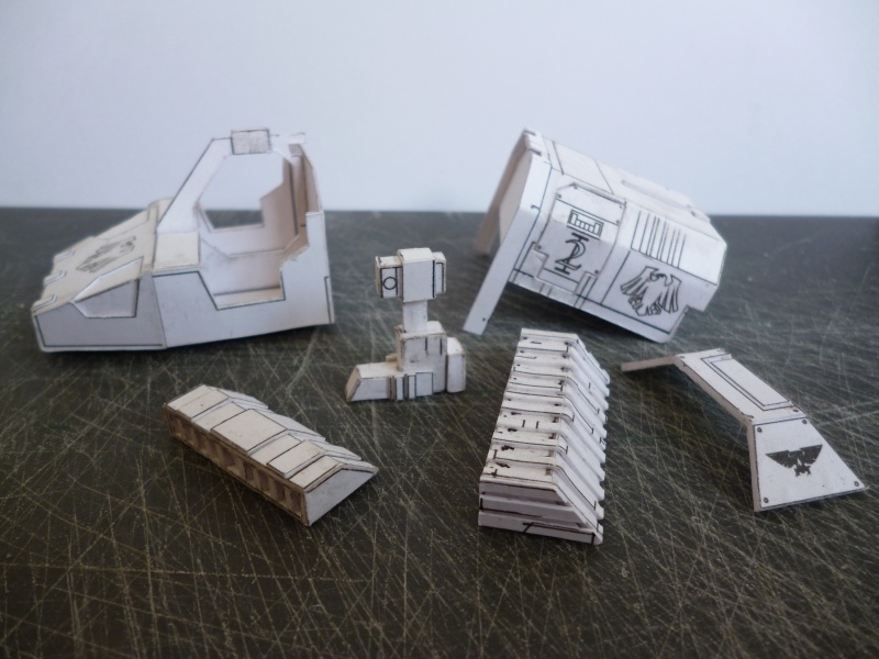

Hi,
Finished a couple of pieces for my Landspeeder.
They don't look quite the way they should, but still, I'm sticking with it.
I have a question.
How do you make shure the edges stay sharp.
If you score them they have a small gap in them (and I score very gently).
As always,
any response will be greatly appreciated.
Thanks.

Try using a rounded needle or dulled blade to score with, what youre after is to make the bend, not cut the paper.
Depending on the look I want, I will use the edge of a steel ruler and bend the printed part on the edge of the ruler. I also use flat pliers that do not have serrated surface and clamp it down while I bend it at the bending point. Play around with objects around the house. Even a piece of wood with sharp corners work real good too and is cheaper than buying special tools. Keep it up and waiting too see the results. See you around the forum.

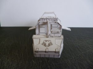

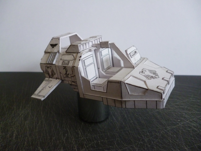

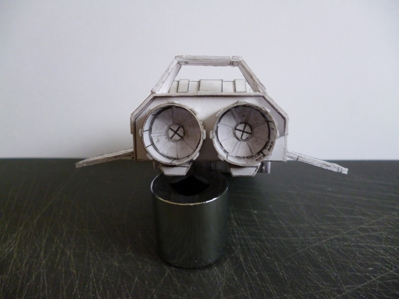

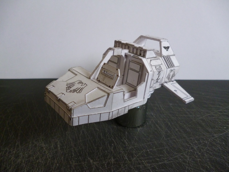

Progress
Hi,
I've been working on my landspeeder some more and it starts looking like one now.
Still making alot of mistakes but keeping them in mind, I'll do beter next time.
Just have to detail the bottom and add a few details (and weapons of course) and it'll be ready to paint (hopefully next week).
Thanks for the response.

Looking the wrong way...
It looks very good! :thumb: :thumb: :cool: It took me a while to figure out that it's NOT a Star Wars Landspeeder, is that right? If I misunderstood it and it IS from Star Wars, then I humbly beg your pardon.
One more answer to your question: to make the edges look sharp, you can try NOT to use tabs. Many of the builders/modelers here do not use them, but it's a matter of choice. :thumb:
Keep up the great work!
Your model has really come along really well. Very nice! :)
