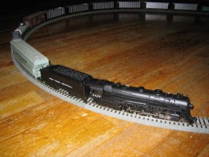

Took it over to my sister's place to show off my new acquisition to her son. I think he was mighty impressed, when I hooked on 15 cars to the engine on his loop of 18"-radius car and started the train going. My little nephew was also impressed with the sound, since Thomas the Tank Engine had no sound at all. :D
My impression on the BLI J1e Hudson:
It's a heavy, nice-running engine with good throttle response on analog DC (0 to 12 volts)-- I'll take it to my local MRR club and run it on their DCC layout later. It does have a built-in delay where the sound effects start, then the drivers start moving at around 2 volts or so. It had no problems pulling 20 cars on level track with no wheelslip-- quite powerful. And at full throttle at 12V, it goes quite fast-- I'd say around a scale 70-80mph or so hauling 20 cars. Not a bad performer at all.
The manual is very detailed on how to program the on-board decoder for DCC, which should come in handy for me in the future when I convert my layout to DCC.
There are little annoyances though... The running gear requires lubrication-- I can hear them squeak on every revolution. Also, it's sensitive to uneven track-- All the weight is carried by the six driver wheels while the leading and trailing trucks are just there for show and contributes nothing to the suspension, so I do see a bit of bobbing and weaving when going over rough track. Under heavy load it will also waddle a bit (which most model steam locos tend to do), though it's not as pronounced as some of the cheaper steam locos I've seen. Also, the manual does not explain how to detach the electrical harness to separate the tender and loco. :curse: It looks delicate, and I'll have to be careful to mess with it later on.
Overall I'm pleased with the BLI J1e Hudson for my first foray into steam-- For $129 it's quite a nice deal.
Oh, before I forget... Photo of the J1e running on my nephew's 18" loop (yes I know, it's a passenger engine and it looks funny hauling a string of modern freight cars, LOL):

Welcome to the steam era. Your comment about the heavy maintenance required on steam loco's goes back to the prototypes. One of the primary reasons they aren't around anymore. Just reading another thread where someone was commenting on the dirt, crud, noise etc, involved with steam operation. I'll take the models. Light oil and white grease will make a difference, no asbestos do deal with.
Yeah, that's an amazing deal you got!!! To detach the tender from the engine, grasp the wires as near to the cab as you can and pull. It's a plug - and comes out quite easily.

Jim: Roger that on the white grease-- Glad I picked up some along with the engine today (bought the Atlas lubrication kit, complete with degreaser, light oil, and white grease.) :thumb:
Spitfire: My particular engine was really wierd-- I might have pressed the harness plug into the engine too firmly or something, because it won't budge. :oops: But that's OK-- I took off the tender body and disconnected the harness on the tender end.. That one came out easy. Those wires look real thin-gauge and fragile, and I'm in constant fear of pulling loose one of them. Connecting or disconnecting the tender seems much easier with the tender's shell off though, so that's going to be my standard operating procedure with this loco from now on. train97

Congratulations on your first steam purchase Tom! The Hudson is a very good looking steam locomotive - good choice!
Your minor frustrations with it are something that you'll have to come to expect to some degree with steam models. While the front and rear trucks on the real thing were important load bearing and guiding devices, neither are really needed for a model, and it would take away from some pulling ability (you WANT all that weight on the drivers!). As far as the bobbing and weaving, heck that's prototypical! Steam locomotives were very rigid compared to deisels - this is the reason you're much more likely to see track imperfections echoed through locomotive movement than with deisels. That lack of flexibility is also a major reason that a deisel, pound for pound, will get better grip than a steamer (especially on rough track).
