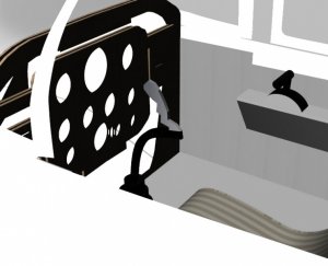

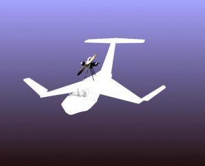

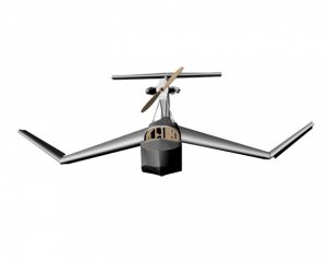

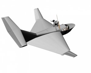

Redesign
I have been working on redesigning this model. It is pretty far along. I work slow, but here's some recent pictures.
Slowly but surely, inch by inch.Actually, (as you may know) the constant Migraine I have makes it difficult to work.
Every part on the model unfolds and is buildable (I have made one already), I just want to fine tune it and try and get the motor right, which is a compromise because of the compound curves. Thanks.
Well, I worked off of blueprints, but yes, I made it using Rhino 4.0. O made one for my son. It has been thoroughly trashed. I will get back to these eventually. I just had to walk away from them for a while. I got burned out. :)
