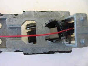

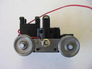

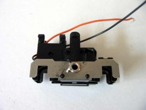

I wanted to run the least amount of wires between the two units so I decided that I would just pull power from the dummy. Besides the fact that I needed to replace the plastic wheels with metal ones, I also found that the dummy has two left hand trucks. (at least mine did) With the plastic wheels it was not a problem, but as soon as I replaced them with metal wheels the chassis would short out. I found that I needed to hard wire the pickups, and try to insulate one of the trucks from the frame.
The first truck I just hard wired the right hand side pickup (Red) and just left the left hand side the way it would normally transfer power through the chassis. The second truck however, I had to hard wire both connections and insulate the left hand side pickup by placing electrical tape over the plate that connects to the chassis.

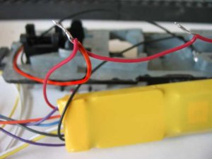

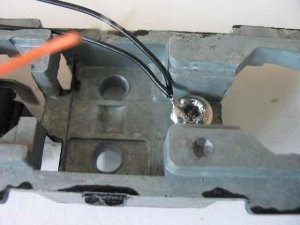

I then put the chassis on the track to make sure that there were no more shorts. After I was pleased to find that there were no more shorts I drilled a 3/36" hole, and placed an appropriately sized screw in the hole. I then soldered the left hand connection (Black wire) to that screw, and then another black wire back to the decoder. (The only reason I put the screw in was because for some reason the solder would not stick to the chassis.)
I then soldered the right hand pickups (Red) together, and then to the decoder.

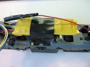

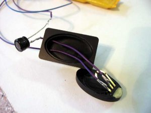

Next I soldered the resistor (that was included with the decoder) into one of the purple wires. The purple wires then went through two #36 holes that I drilled into the speaker enclosure, and were soldered to the speaker. I then snapped the speaker into the enclosure and glued the speaker/enclosure to the frame with a few dabs of hot glue.

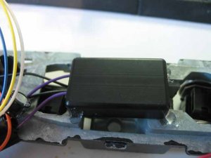

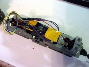

After the hot glue cooled, I placed the decoder on top of the speaker enclosure and strapped it down with some electrical tape and a bit more hot glue. I also wrapped the exposed wires with some electrical tape and tacked them with some more hot glue.
I hope I got everything, if not hopefully someone will fill us in. I am not sure what the differences are on the DSX but I hope that this helps give you an idea of where to start. If you can, I would suggest pulling the power from the dummy so that you could lash up the dummy with any of your motive power to have sound whenever you wanted with whatever consist you wanted.
