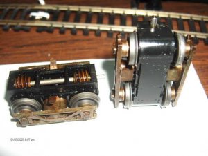

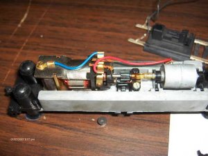

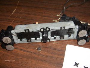

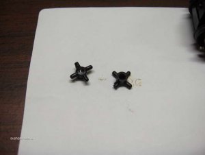

. I didn't pay that much for it and it is in overall great condition. It run but the wheels didn't move. Took it apart and it looks like age got to these 2 plastic x pieces that attach to the shaft of the worm gears inthe trucks. Has anyone ever seen this car or these x's before? Can i buy them somewhere our would i be better making my own out of delrin, nylon or abs? The shafts also have an odd measurement, .092" diameter.

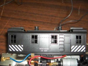

I also have designs on articulating the 4 buffing posts
. Right now they have a very soft spring in them, i was thinking of putting a crown gear setup at the tops of the shaft and putting a high speed motor (like from a tyco ho scale slot car) and have them rotate
. I'd have to figrue out how to hide that setup but it would be able to buff the tracks to a mirror shine!!
One last question, does anyone know what that material is on the pads of the cleaners? It is almost like velour in cars on the crappy old gm models.
