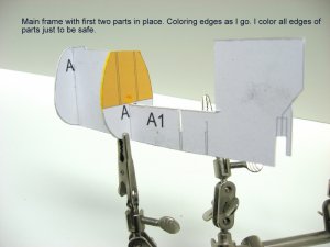

Here is the first sequence of parts that I cut out and assembled.

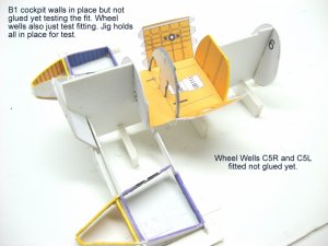

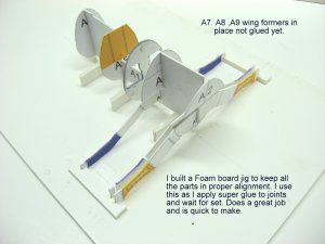

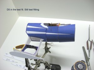

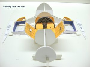

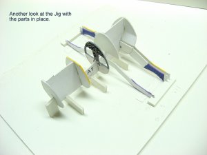

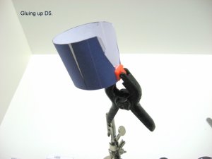

Next stage Jigs
I used a jig for alignment of parts and to add a little order to this.

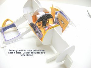

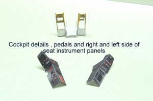

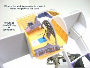

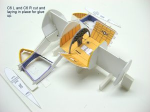

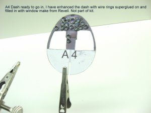

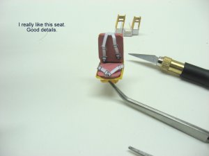

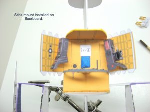

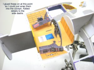

Next step interior of cockpit
This is interior details getting ready for assembly

Thanks Bulldog Jigs are essential to this build, there is a lot of flex when you are gluing up. The superglues get hard fast and hold the position.

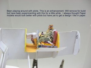

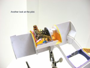

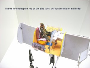

Paper Pilots
Well here is a short sidetrack, will start another thread on this when done with model
I will see what I got but they are labeled as water color pencils.
Pilot looks good! Can you put another flat section cutting through that would show the front and back which might impart a 3d effect - or it may look worse, I dunno!

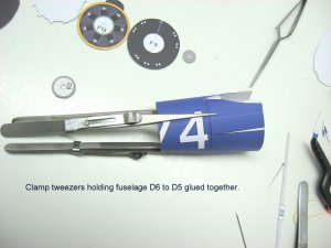

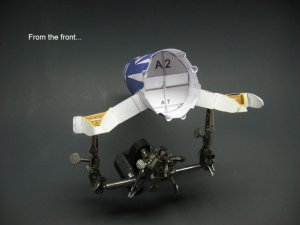

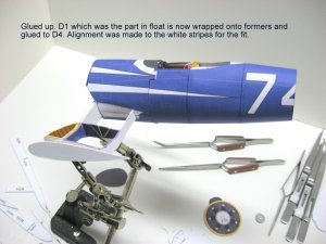

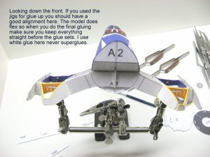

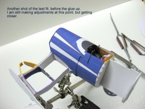

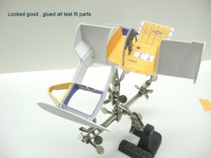

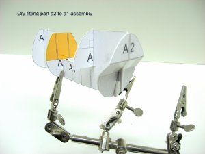

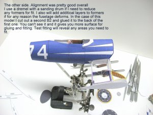

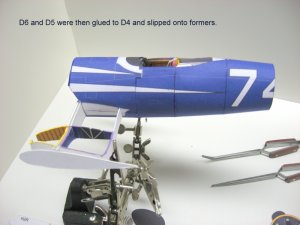

Fuselage buildup
I am going to assume that the last post above this one must be the designer. I don't know that for sure. But it sounded like it. I am amazed that I will be the first to finish this. It looks like a great model, and so far not too many problems. I usally build in 1:16 scale but stuck with your published size out of respect for the kit build. I am glad your happy with the build so far. When I am done will scale it up and build again. So please hang around. Now on with the build.

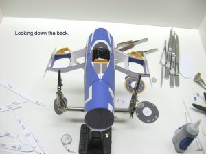

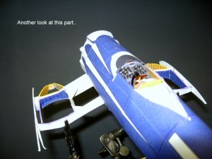

On with the glue up
Peter thanks for commets. I love this plane. I think the wing roots are good looking as heck no Sexy is a better word.. I am inclined to build a stand for this to show it off as it should be, I will include that at the end of this build.

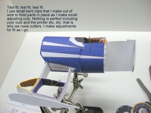

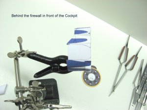

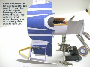

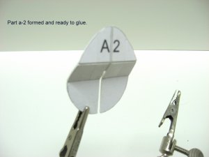

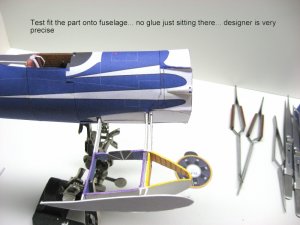

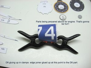

Front of Fuselage
These are parts from page 6-47 , f1-f7 ,

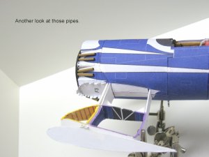

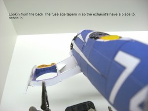

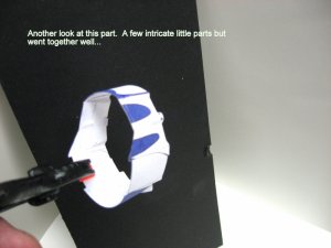

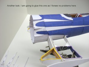

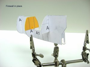

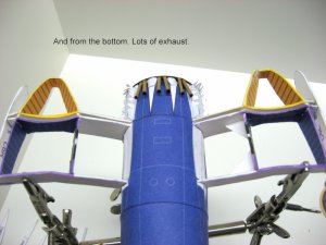

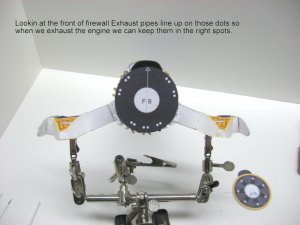

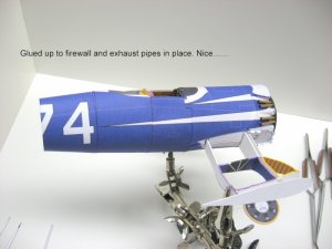

Firewall and Exhaust Pipes
Well I glued the forward part of the fuselage in the previous post and added the firewall and exhaust pipes. Closing in on that engine. Can't wait...
