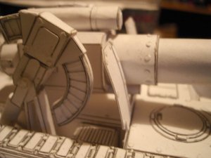

Been working on this off/on for the last few days, so I've a collection of progress shots to share. I mucked up the turret pretty badly, merely by following the tab-gluing patterns, so the access hatch does not seat correctly. I've jimmied it, but on the next build... eventually, I may try to resolve the issue. The end result should be more flat with a more pronounced exterior edge, but it looks alright to me, so I'm leaving it.
I did a bit of custom work on the front cannons just to give them some more detail once the paint is on it. While they don't look quite like Heavy Bolters I'm sure they'll pass. In addition I convinced our masking department at work to cut me out some .060" (1.5 mm) circles to try out for the rivet heads. They work pretty well, the tape is meant for clinging to aluminum so I have hopes it's withstand painting/play. The circles are a bits of trick to get out of the tape sections, but better than me trying to cut them by hand. If they don't work out I'll try silver's process with pinheads.
I was not happy with the basic design for the tensioner rod sections, so I did a quick model up of some, printed in paper instead of card as there are quite little bits. The assembly went swimmingly. If the lasguns for the passenger compartment work out and anyone is interested I can post the .pdo for both. I also built up the main guns, assembly went fairly well; I'll likely dress them up a little more before painting.

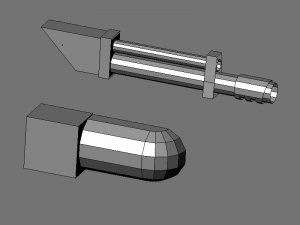

I've uploaded the Chimera Components file in .pdo format (it is in moderation). I can't seem to upload a picture for it in the download area, so here is one in case you missed it earlier...
