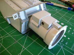

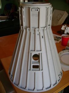

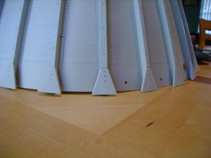

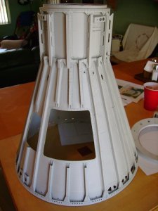

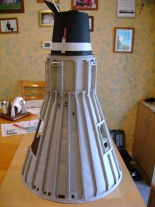

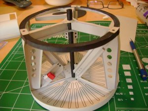

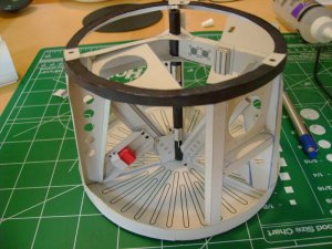

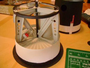

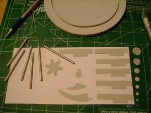

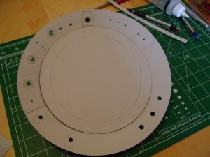

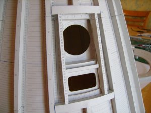

Trimming out the main, nowhere did I find in the parts pages the brackets for the bottom ring...so I made some. So far the main without antenna faring it measures 19" high 171/2" in diameter. Currently working on the escape hatch, held off on gluing in the front bulkhead ring untill hatch is done, photos to come.

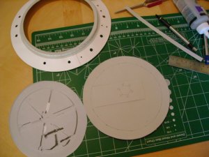

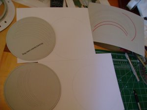

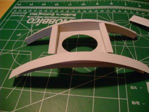

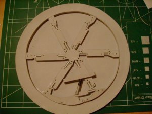

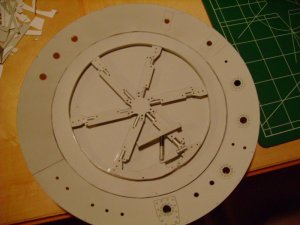

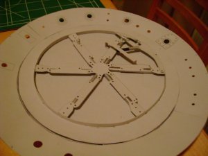

Hatch construction

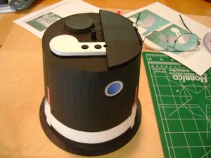

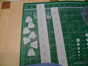

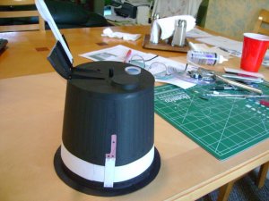

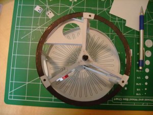

Antenna complete
So heres the antenna. Everything went smooth.
This is the first I've used black paper, I had to reprint each page three times to get the graffics to be good and visable, also the black cardstock isn't as ridged as the white, had to double up several pieces.
My daughter put into words what I was thinking while building the outer skin....t looks like a pilgrims hat.

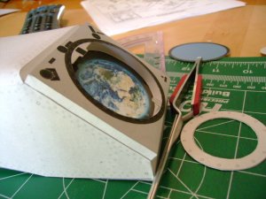

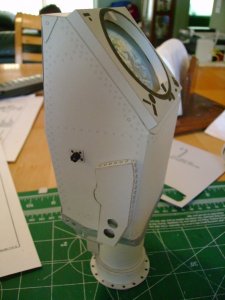

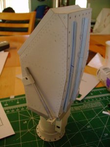

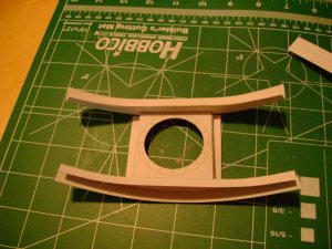

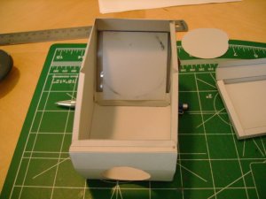

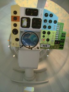

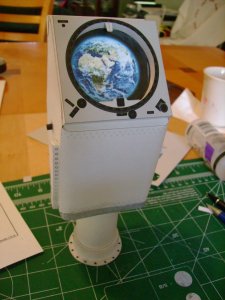

Ok heres the scope. I added a little twist to it

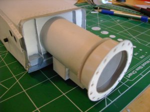

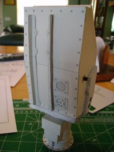

And heres the finished product

Very nice idea! It looks very good, especially the feathered edges of the picture.
Mercury capsules however, flew very close to earth. Just over 150 to 250 kilometers up. You absolutely cannot see the earth like that from that height. The first time astronauts could see the earth the way it shows up in this periscope was during Apollo 8 in 1968. You got to be several thousand miles up (or out) to get that view.
An average Mercury pilot would have seen even less than what today's astronauts see from the shuttle or ISS for that matter (which resides at 350 kilometers altitude). So, it would have been just a tiny part of the continent which they fly over or the ocean.
For a model which such great detail and minute building this should be corrected. The rest looks awesome, Closet Astronaut! Wonderful stuff to watch.

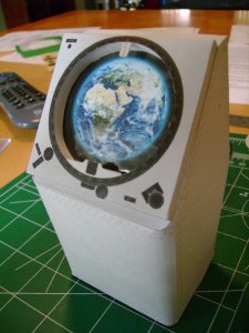

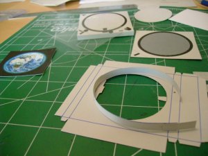

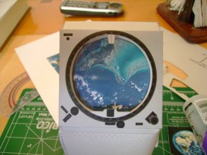

OK P.K this ones for you
You are right, as I put this together I knew this photo was too high of a shot for this capsules altitude. The more I looked at it the more I didn't like it, I would have left it, the only ones that appreciate these mods are people on this forum, no family or friends give a fat rats A about the detail, but with your perfectionist cattle prodding (just kidding) I corrected it. i must admit it does look better.

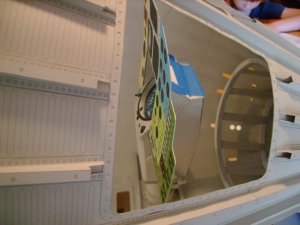

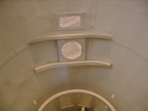

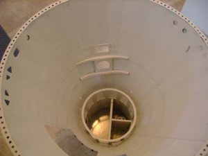

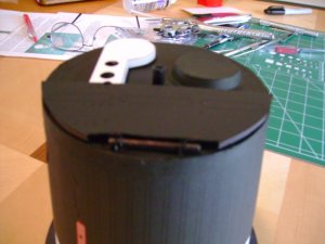

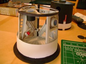

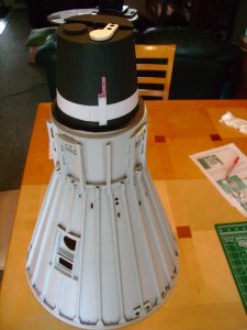

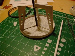

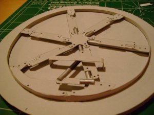

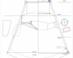

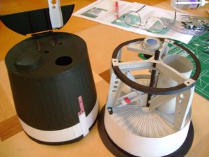

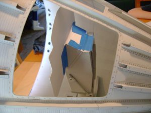

Houston....we have a problem.
Seems the scope ond instument guage sit too far back. I haven't formally mounted these with the setting block in the files, we'll see waht happens after.

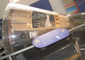

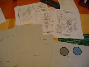

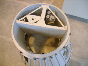

Here is a photo I took of SN5 just a few weeks ago. Its purpose was to do exactly what you are doing, verify the periscope position. I was also going to use it to finish scaling some of the brackets that are not usually seen. The CAD file is just a quick screen dump with a bunch of layers turned off to show what you are looking for. I included enough to scale any position dimensions you might need. Whatever you can scale off this picture should be good enough for you.
Paper Kosmonaut, easy there on the quotes "You absolutely cannot see the earth like that...". If you look through the familiarization manuals, you will see the periscope had a special lens on it that could show the entire horizon similar to what Closet shows. it would be a fish eye look but you could see it all. There are also photos out there taken through that lens. Maybe Closet could find one. I'll look when I get a chance. There are also marks on the scope face to align the capsule in different attitudes such as retro, orbit, etc. I put them in the model.
Scott
