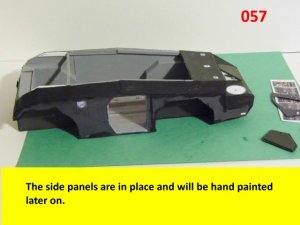

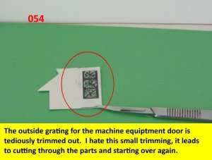

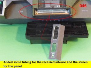

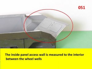

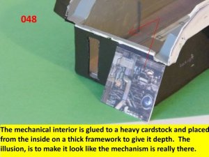

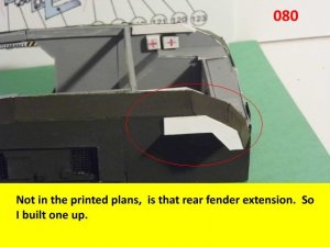

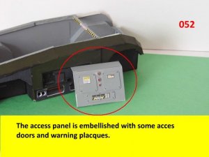

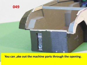

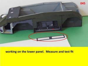

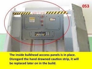

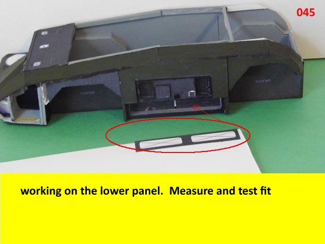

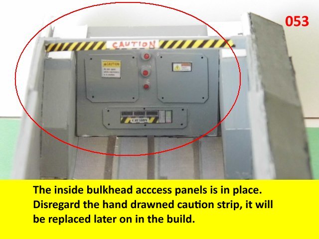

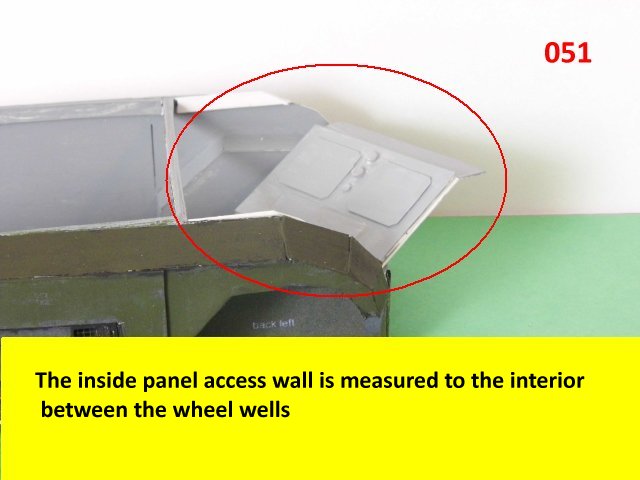

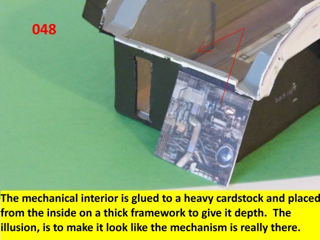

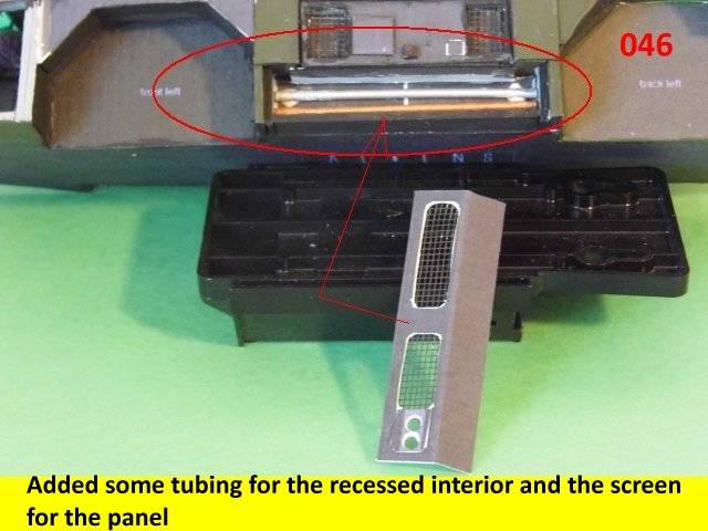

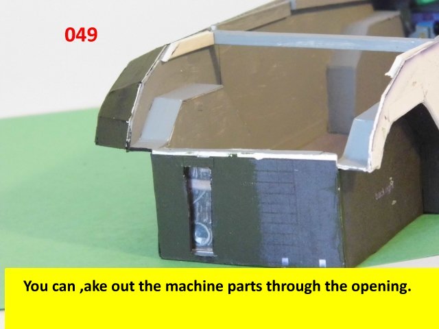

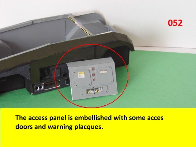

And now, on with some more updates, the next posting will cover the front drivers door, but until then, here are some panelings.

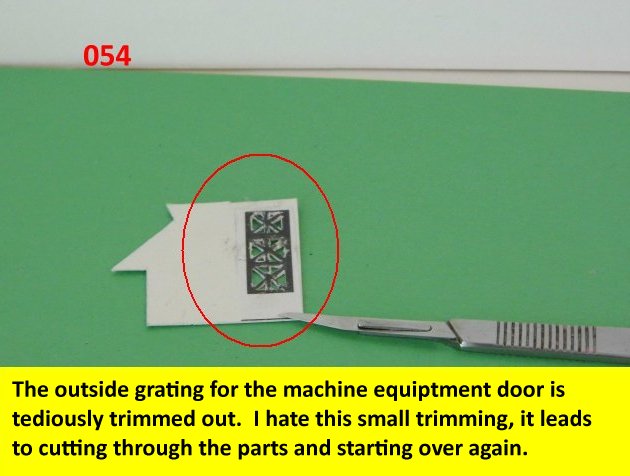

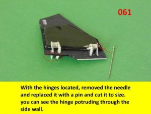

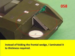

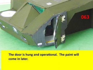

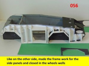

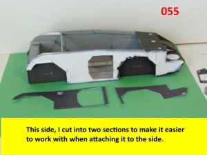

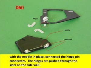

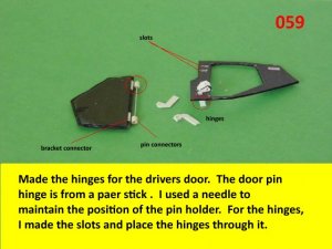

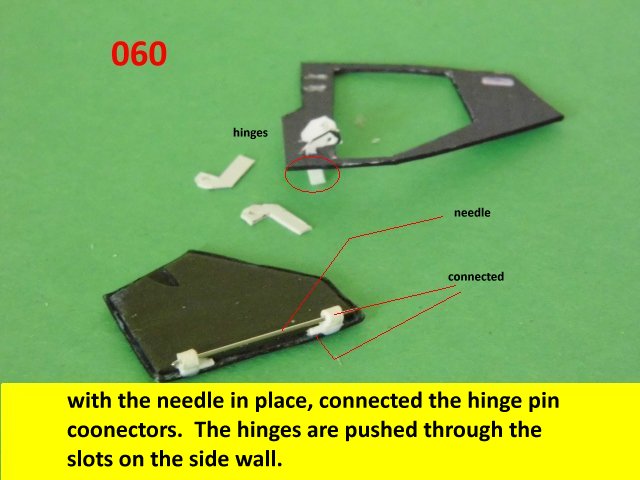

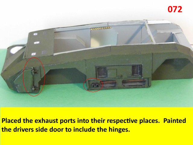

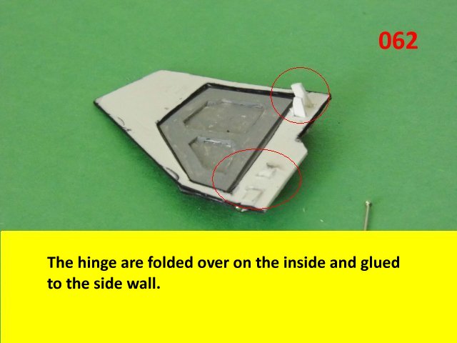

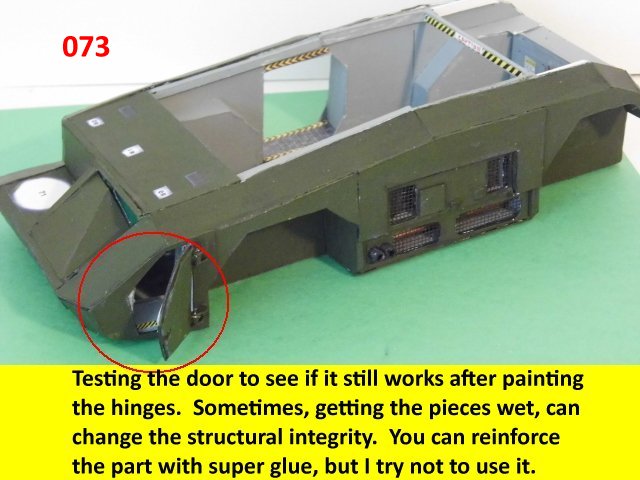

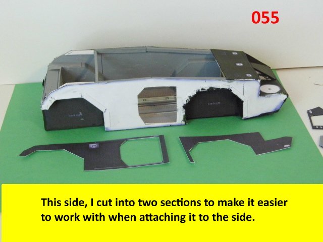

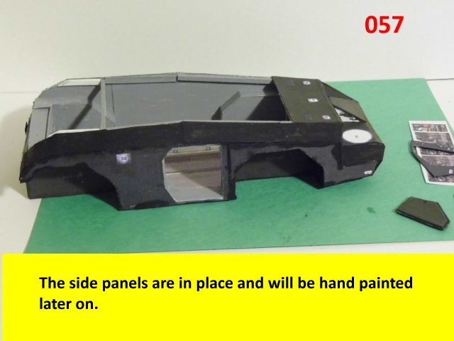

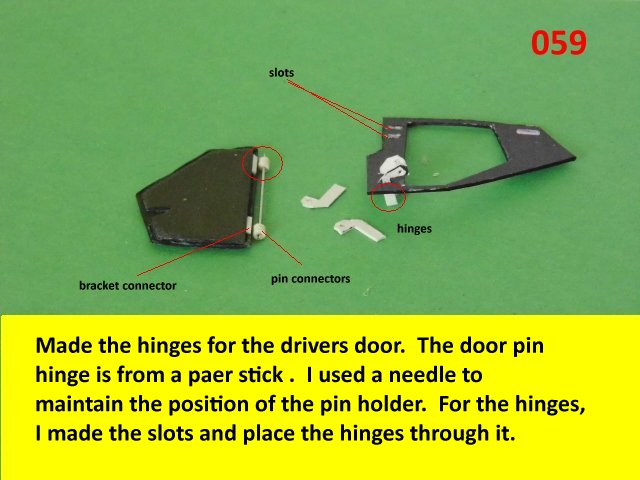

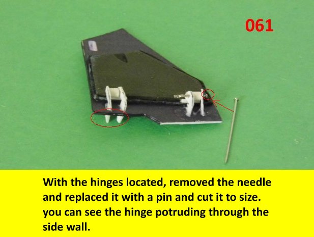

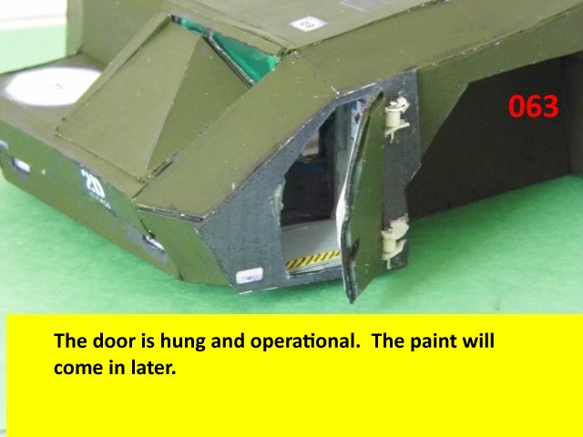

More updates and the one that some of you have been wondering about. For the door, I used 120lb cardstoc for the flat part of the hinge. I was going to make them out of brass but decided to try it out of paper. Be sure to cut the slots out first, before cutting the side panel out. It will give you some surface to work with and make sure that you do not cut all the way trough to the edge.
Using a needle for the hinge is a brilliant idea! May I "borrow" it on occasion? :-)
I like how you did the hinge. It looks perfect.
Thanks, if I had made it out of brass, it would have looked better and stronger, but I am pleased as to how it came out.
Your attention to perfect detail is mind-boggling, Ag2O. :cool:
Beautiful work as always!! :thumb:
When I used to make my plastic models, I always liked to detail them a bit. My saying was " a model by itself, is just a model but add details or a diorama, and it tells a story."
Remember, the needle was to maintain the hinge location, but it also could be used as a long bolt like on a ships hatch cover.

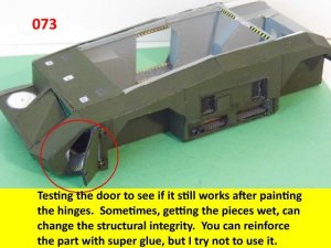

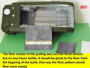

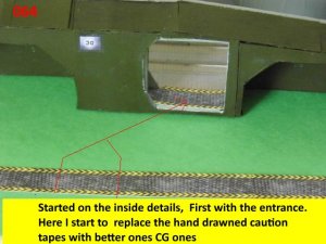

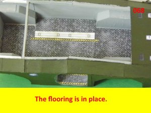

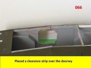

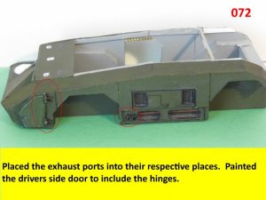

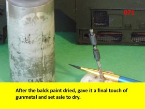

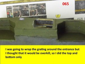

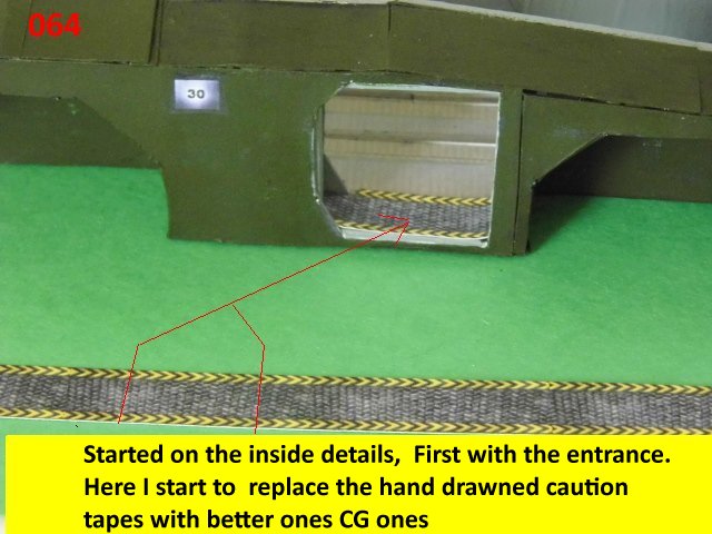

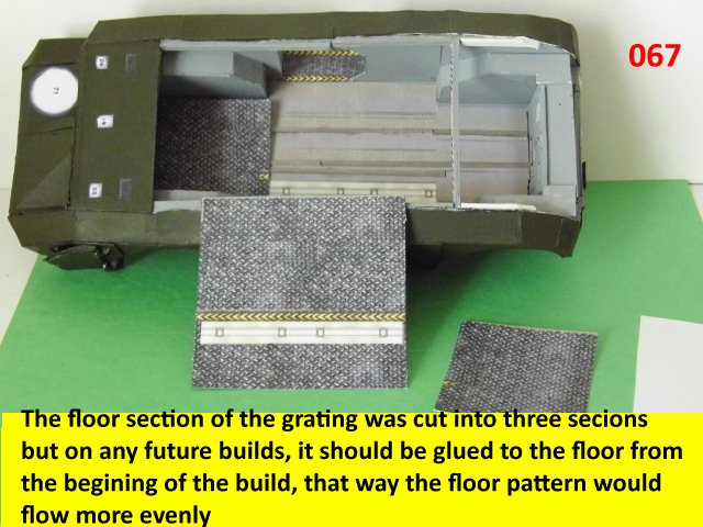

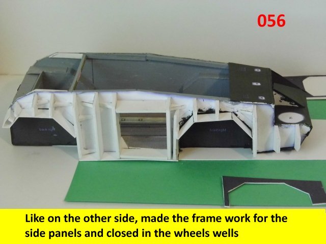

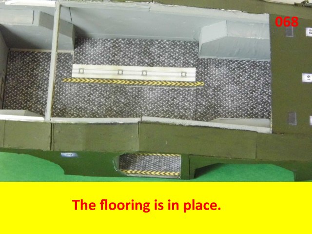

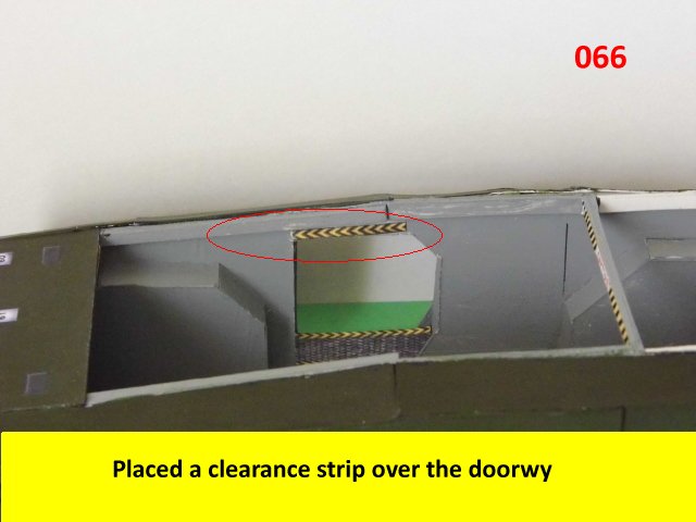

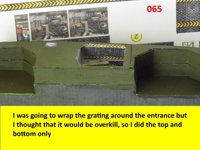

Started the insides so that I can begin on a whole bunch of new ideas for the interior. That floor plate was designed after I started on the build. That is why I broke it down into three sections. Next build, if I get around to it, the floor grating would have been one of the first steps in the process and it would have been glued in its complete form to the floor schematic.:thumb:

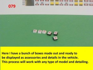

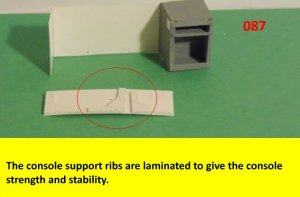

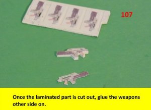

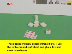

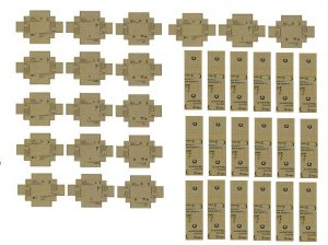

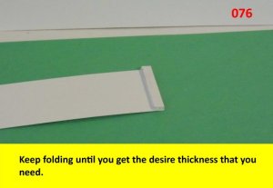

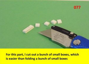

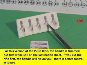

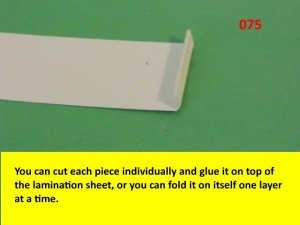

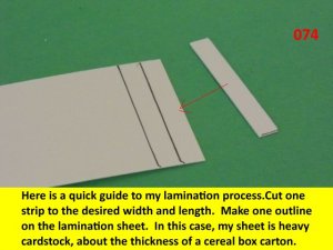

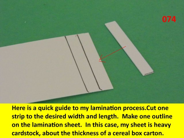

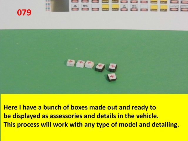

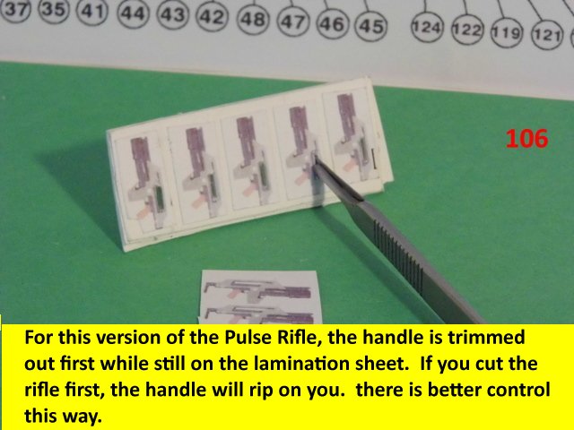

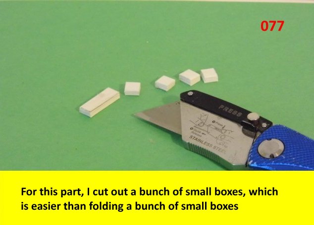

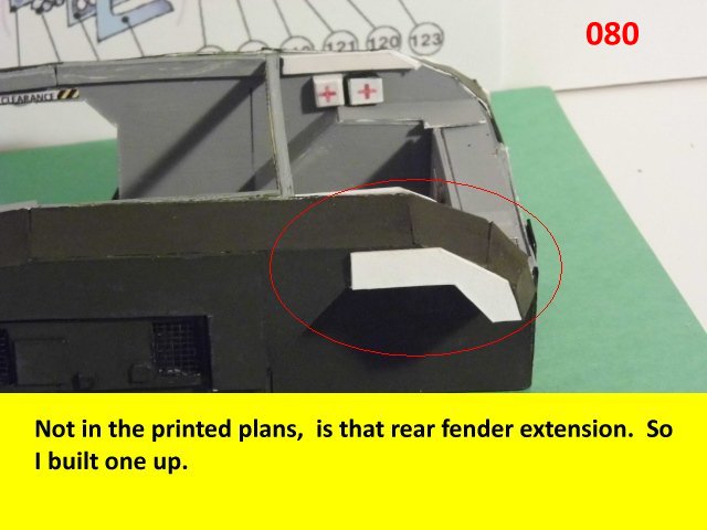

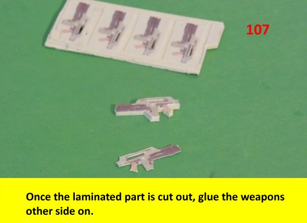

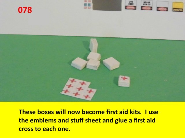

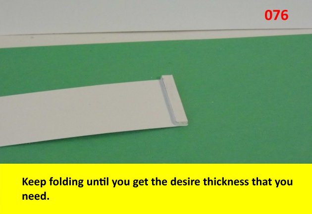

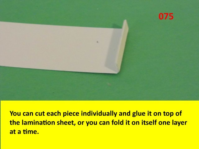

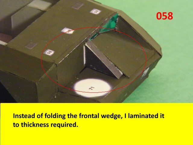

Here is a small tutorial on the making of laminated pieces. It stands true for thin or thick pieces. It cuts down on making fiddly little tabs and gives you a solid piece to work with. Here I made some first aid kit boxes but with the same technique, I also made some ammo boxes. With this method I made the crossbeams and the structures for the seats. The only thing holding me back is more imagination. The last photos are of some c-ration boxes the Pulse rifle with the ammo can sides. These pieces are laminated to the required thickness. The c-ration boxes can be laminated and the printed part wrapped around it but it folds like the real box. The parts are set for landscape and are about 1/35 scale. if they are oriented to portrait size, they will be about 1/48th scale. They can be used for other dioramas or details other than the ALIENS venue. Enjoy and see you all next posting.:thumb:

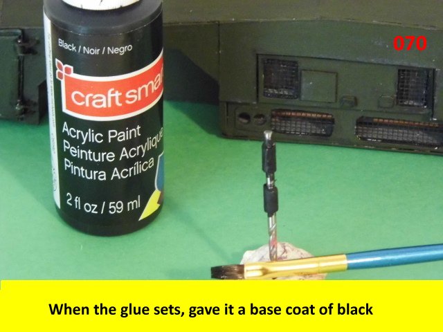

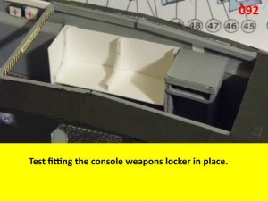

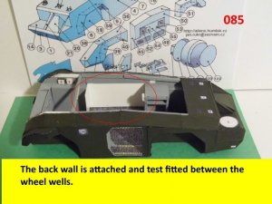

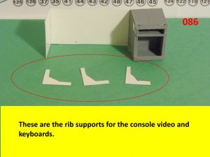

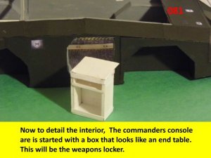

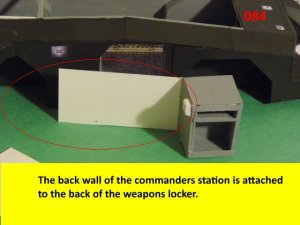

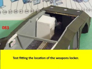

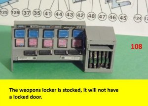

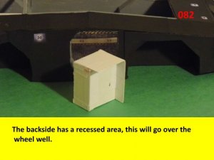

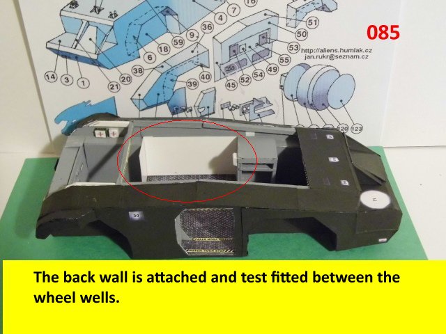

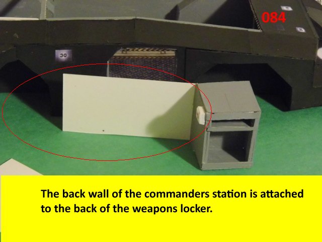

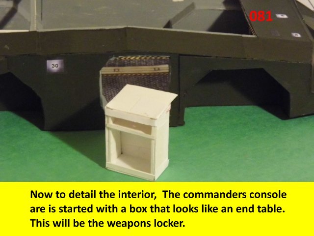

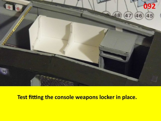

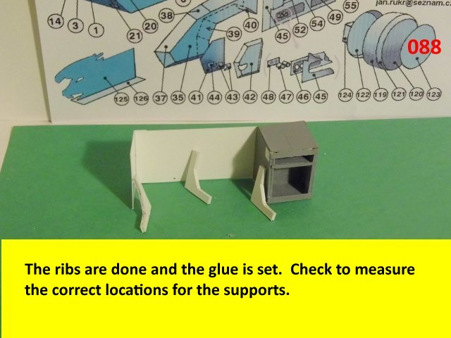

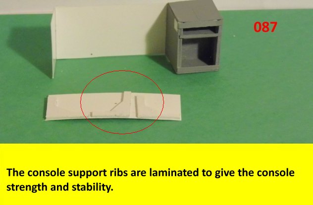

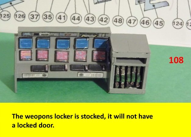

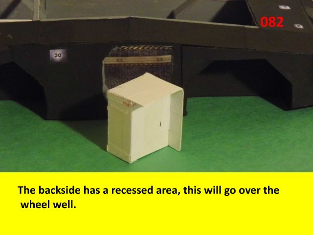

The APC is coming along nicely and the details are making it look better with every added detail. This is the beginning of the cabin detail. The first thing in the agenda is the weapons locker. It will take a couple of postings to detail the progress, but first I have to finish the editing.

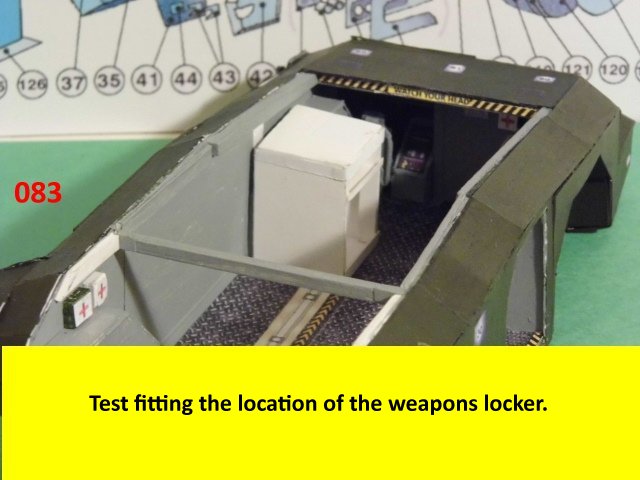

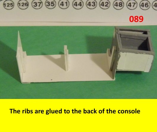

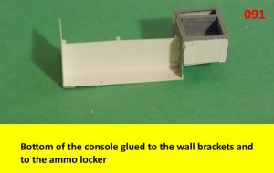

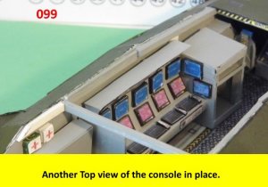

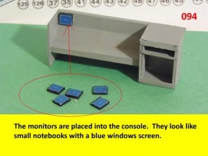

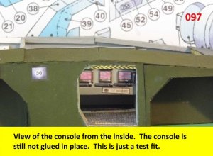

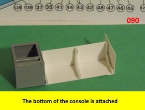

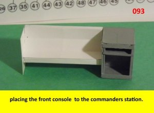

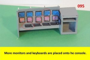

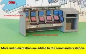

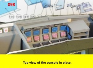

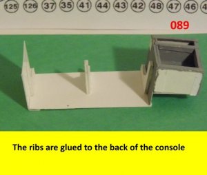

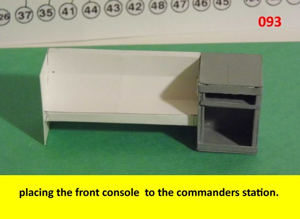

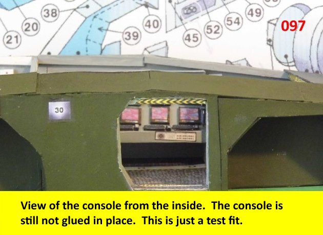

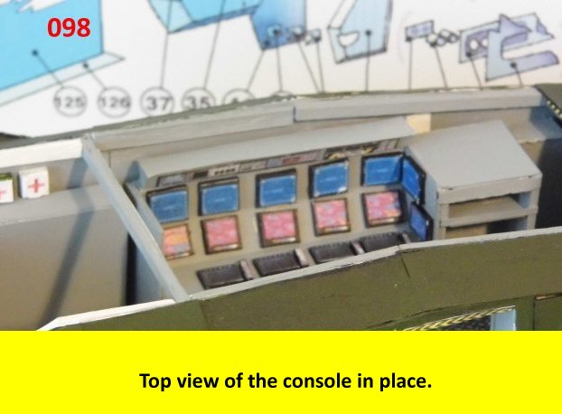

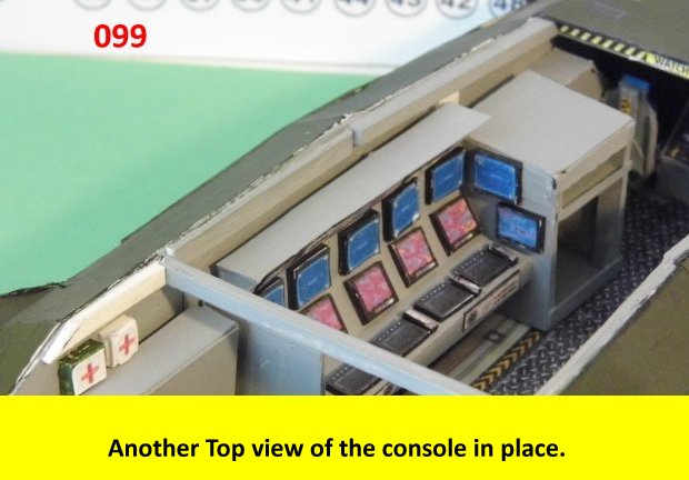

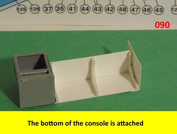

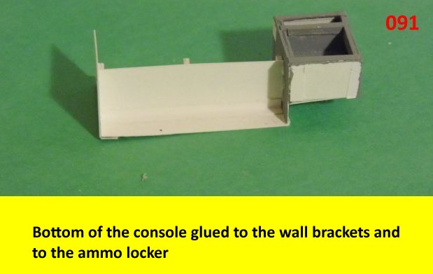

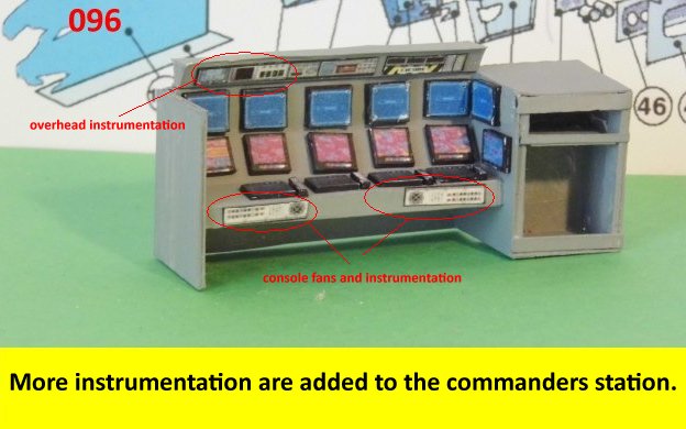

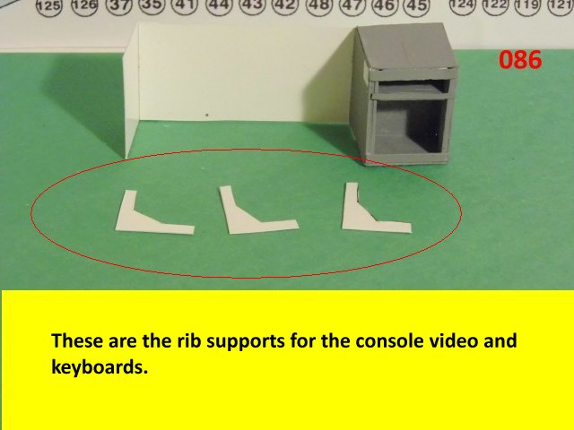

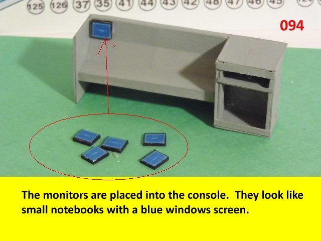

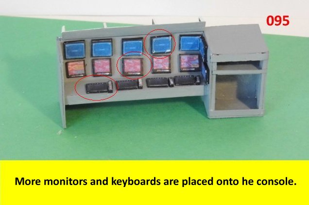

More on the console, The work continues with the console, but it cannot be installed permanently until the front left jump seat is made and attached. If the console is put in first, then the jump seat will have a hard time being installed. Excuse the misspelling on some of the captions. Enjoy and see you all next posting.:thumb:
Aliens M-557
Gee, man, that's... that's... magical!
That is a really GREAT looking control console!!!
This project is really coming to life!!!
Thanks for the comments guys. As you can see, it is all scratch build and there is a lot of measurement, to insure that the interior stays to scale. More details to come.

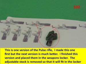

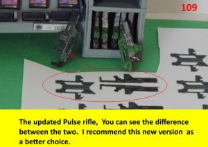

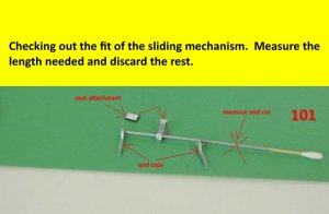

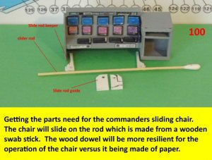

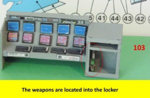

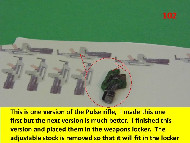

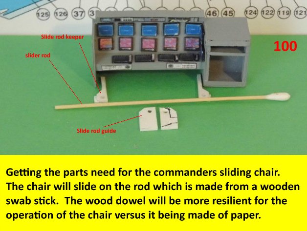

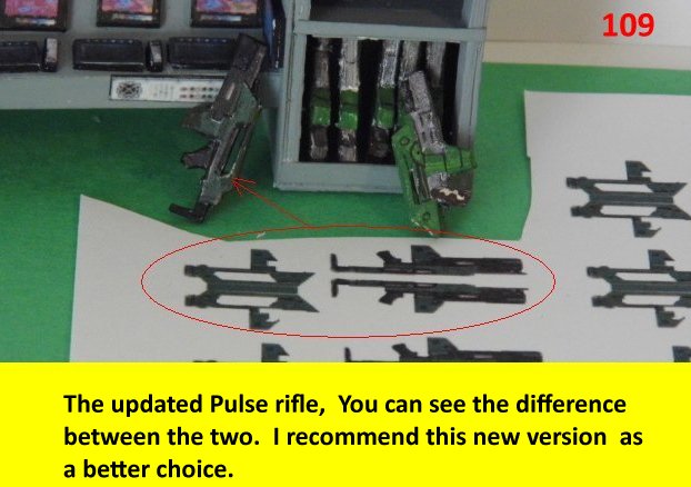

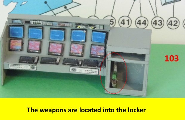

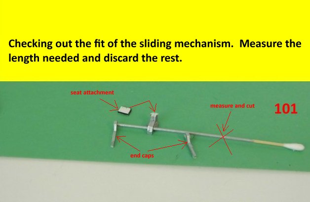

These set of photos jump around a little. The sliding rod is for the commanders seat, which will slide in front of the console. The seat was also suppose to swivel but I forgot and made it fixed looking forward, but it still slides.
The weapons are okay but the new better versions were made after I loaded these version into the weapons locker.
The sliding side door is finished and it works, but that is still further up ahead. In the meantime, enjoy and see you all next posting with the building of the seats..:thumb:
