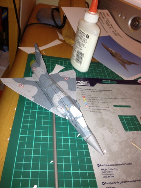

Hello,
I built this mirage 2000 from Ojimak, a very simple model, took me just a few hours (evening + morning) the only difficult part was gluing the canopy to the fuselage as I had chosen 80g paper and the fuselage wasn't very rigid.
The attractiveness of this model is that like the other ones from the same designer it can fly (glide). I will try to capture it while it flies before a crash finishes it but it is quite fun.
All Delta wing aircraft will require that you have the elevators slight lifted to keep the nose up. It is worth it on these craft to separate the elevators from the flaps, as the will greatly increase your control of the craft. The same can be said with the rudder. With the C.G. set right, it should fly like a Dart! On the trailing Edge of the wing, the inboard rectangles are the flaps, and the outer, the ailerons, you probably knew that already. :)
Didn't know about those settings. As built (no special setting) if I launch it very slowly it glides very nicely. But if I throw it with any force it goes up quickly, stalls and dives. I'll try the settings you advised this evening.

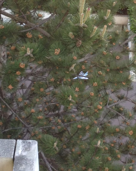

It worked great! So great in fact that I got cocky and decided to launch it from my balcony (third story). I'm sure you can guess the consequences.
I through a plane/Glider off of Bear Mountain, New York, instead of gently gliding down, it went up on a thermal and landed somewhere in New Jersey! Yep, I know the feeling, bittersweet moments! :)
