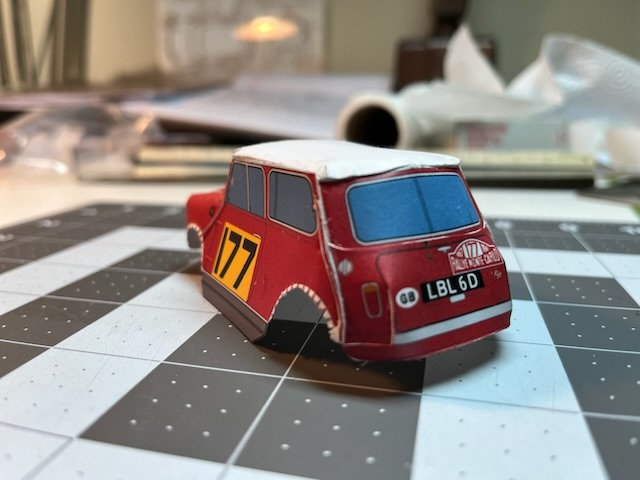

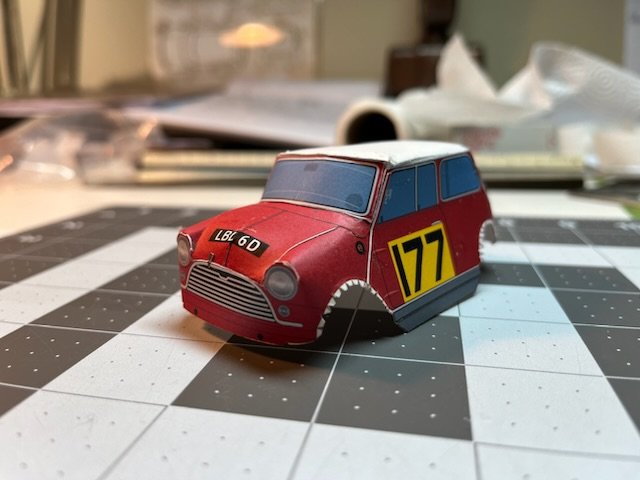

I started today with the Main Body and Hood. After figuring out a little of the instructions (in Japanese, I think), which colored lines mean scoring on the front and which color means score in the back, I got to work: cut and shaped the hood and glued the hood to the main part of the body.
notes so far:
This Mini is really Mini. A slightly larger scale may have been a better choice for a first build.
the 65lb paper seems to be a good choice.
Blue painters tape used to help alignment of back side scoring pulled off a bit of ink off the front side.
Lots of complex curves on this model. But I think I’m doing OK so far.
I’m not going to be too hard on myself on this first model.
Cutting the template clean, like you have is probably the single most important step. Some people (like myself0 cut off the tabs, and use strip's instead. This keeps the adjoining part on the same plane, and makes for tighter seams. :)
Reactions: RichRod
……and use stri's instead. This keeps the adjoining part on the same plane, and makes for tighter seams. :)
Zathros, would you mind elaborating on this or link to a thread so I can get a better understanding of this?
Oh, I think I get it. Cut the tabs off then use a small piece of paper to glue the two pieces underneath. In this case, I could have done that to keep the cut edge of the hood from showing and that cut edge would have ended up in the same plane as the top of the rounded-over fender. Good tip. Thanks.
Reactions: mijob and zathros
Exactly. I don't want to be overbearing, so sometimes I don't say stuff when maybe I should. The best way to learn is to do. You can easily fix the hood on your car by cutting the center along the white wedge, trim off the white, and locate it from the backside, with a strip of paper. The nice thing about paper models is they are very forgiving, and in a worse case scenario, you just print out another page of parts. Most people when start to get ahead cut off the tabs. This allows for compound curves to form, and who cares how it looks underneath, you never see that side. When you cut off the tabs, you glue one half of the strip, then attach the mating piece dry for fitting. Once your happy, a little glue, and your set.

Had a little time to work on this today. Folding over and glueing the roof corners did not go great. I rushed it, and it shows. I’m learning. No going back now. I am happy with the boot, mostly. Oh well, the body is done. Not sure when I’ll get some more done. Thanks for following along, fellas.
