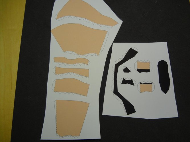

Yes, figures are among the most difficult works on paper. My figure is one of the few I have where the face is split, all the others you only need to glue 2-3 times on the forehead and round, it's easier. Of course, in my inexperience with figures, I had to start with a complicated top. But I'll get there, for the time being I'll keep my distance from Miruku...

Water form the cut facial piece with a damp sponge, using a rounded edge dowel the appropriate size. Fit each piece to the next, till it meets your requirement. When glued and dried, the face can be touched up from the back side the same way, though be careful with water soluble glues. If you use a lot of strips, you may be able to do it dry, if the paper shreds a little on the backside, who cares, a dollop of glue will strengthen again. You will need, maybe a mouse pad thick piece of rubber to put the outside face against, so you don't go too far. Dragging works better than pushing, though an Almond shaped dowel could do a whole forehead. My 2 cents worth. Another method would be to start with very thin paper for the face, build up the interior, Gluing the strips to each other, but not to the face. The sand the "buck" face, Moisten the final cover, and lay it onto your finished buck, Gently use a tissue, also slightly moistened to get the 2d paper to take the compound curves. I tried this method, and had good results, it would have taken me a couple more to master it, but it was just sitting on a neck in a R/C aircraft. At 60 mph, you could not make out details, and the plastic canopy covered much.

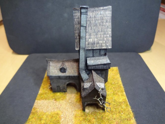

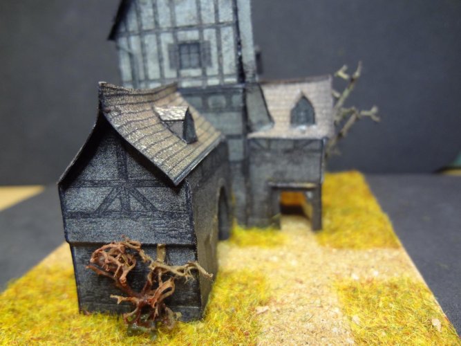

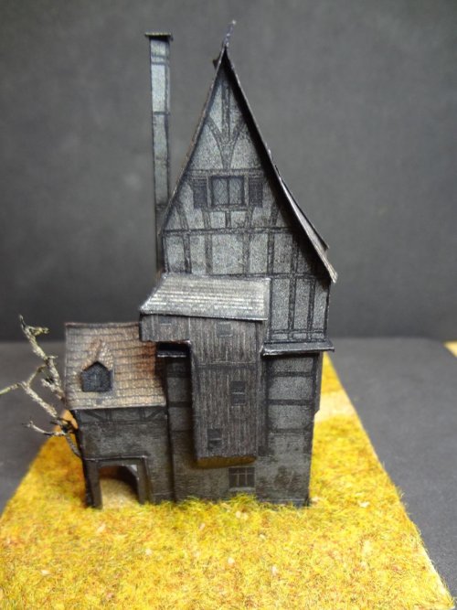

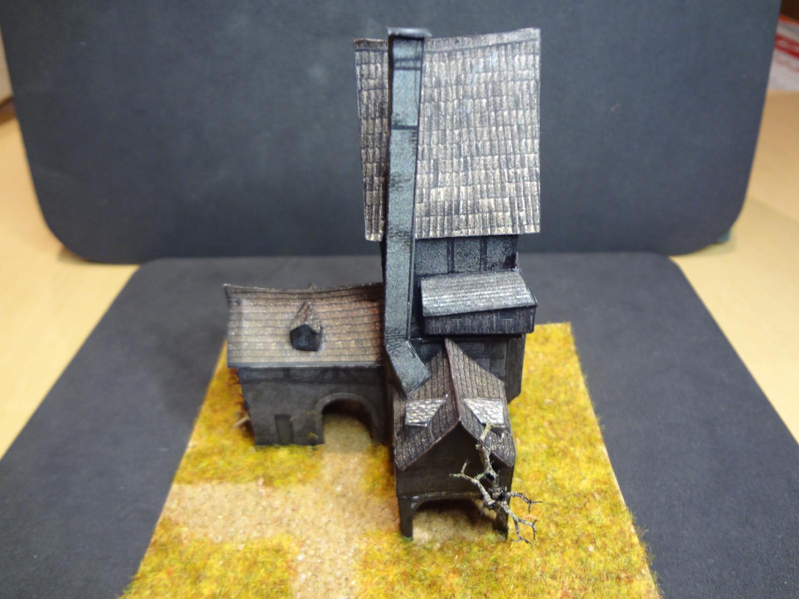

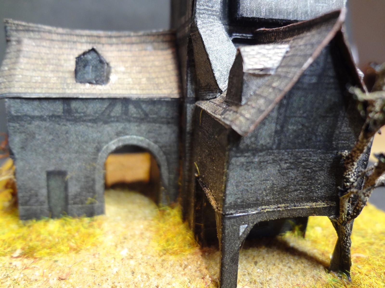

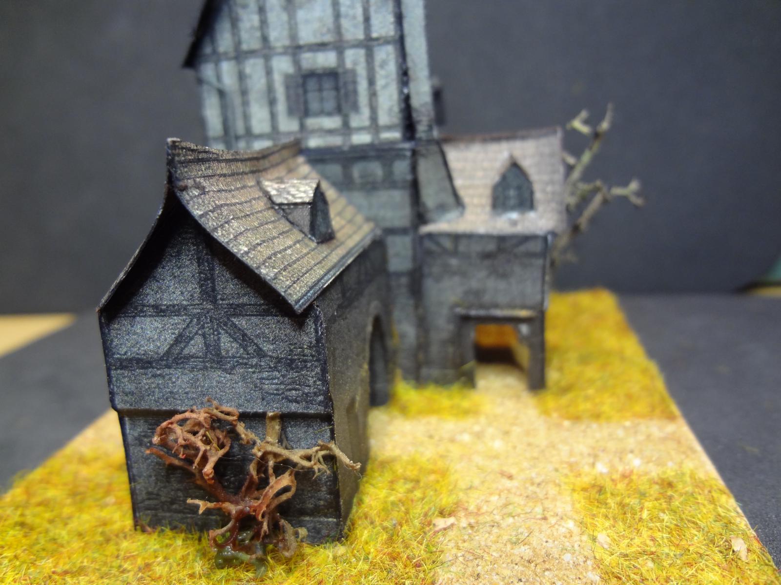

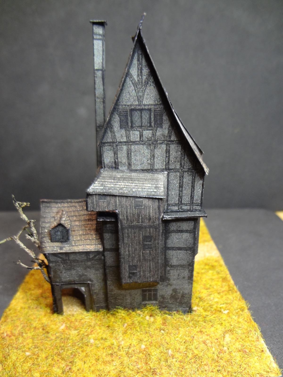

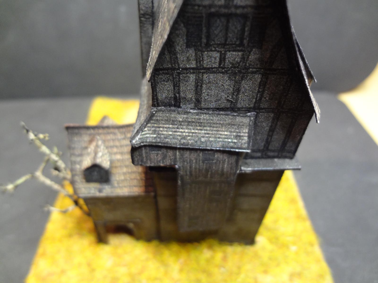

I had to take a short break from my figure - it's killing me. To relax in between, I finished off the “old forge”. Now I'm starting again with the figure - but from the bottom up, face to the end.

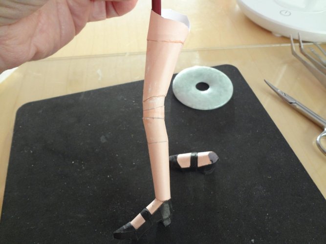

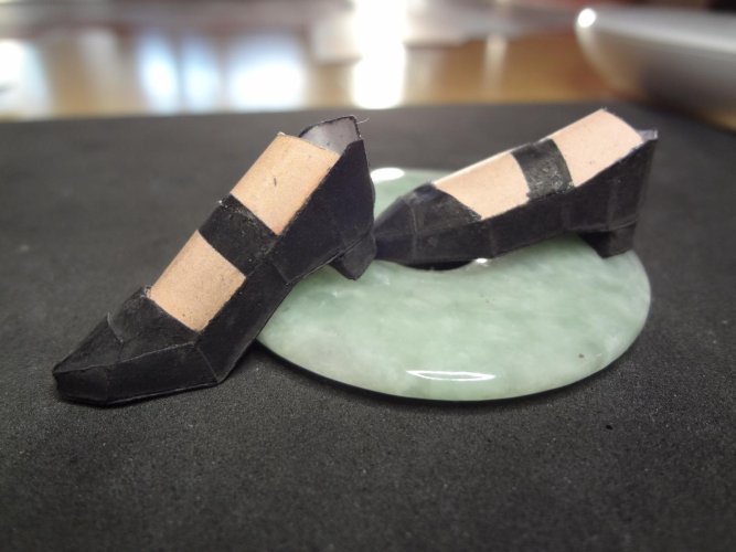

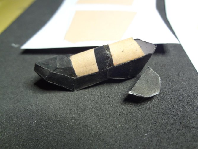

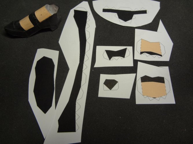

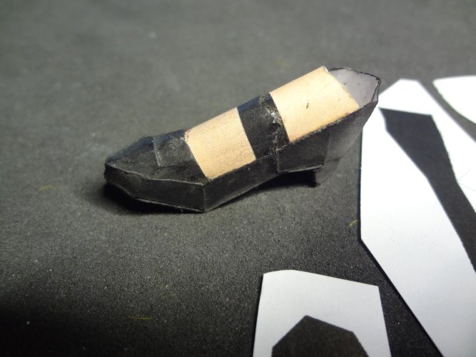

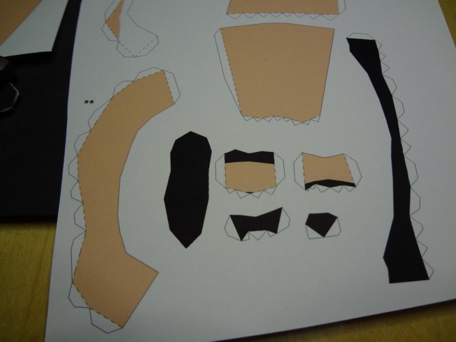

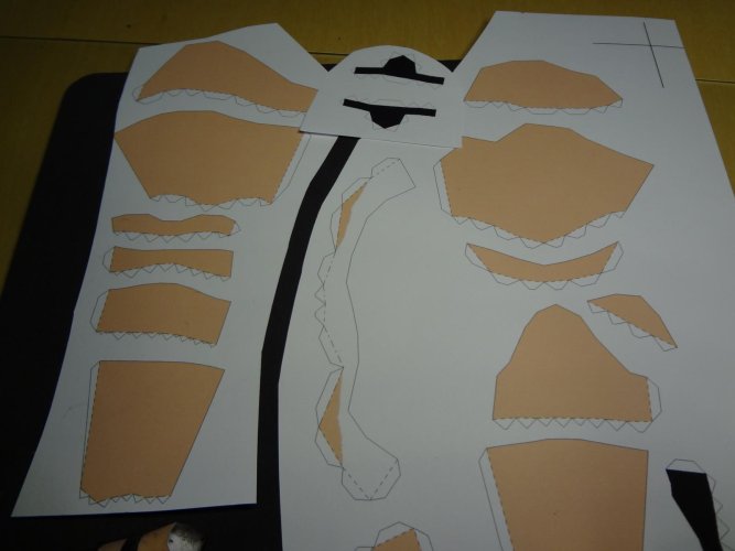

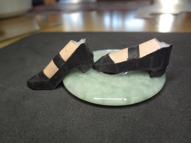

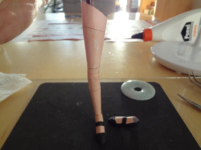

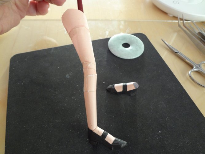

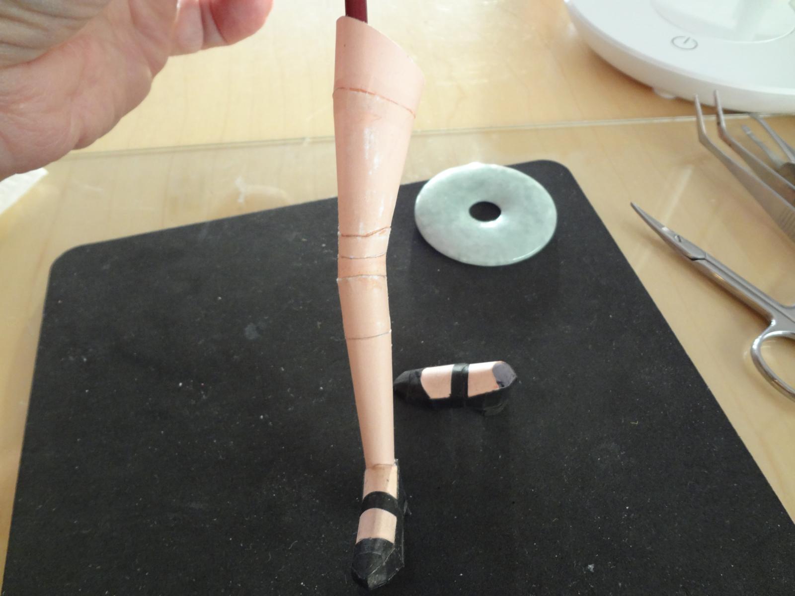

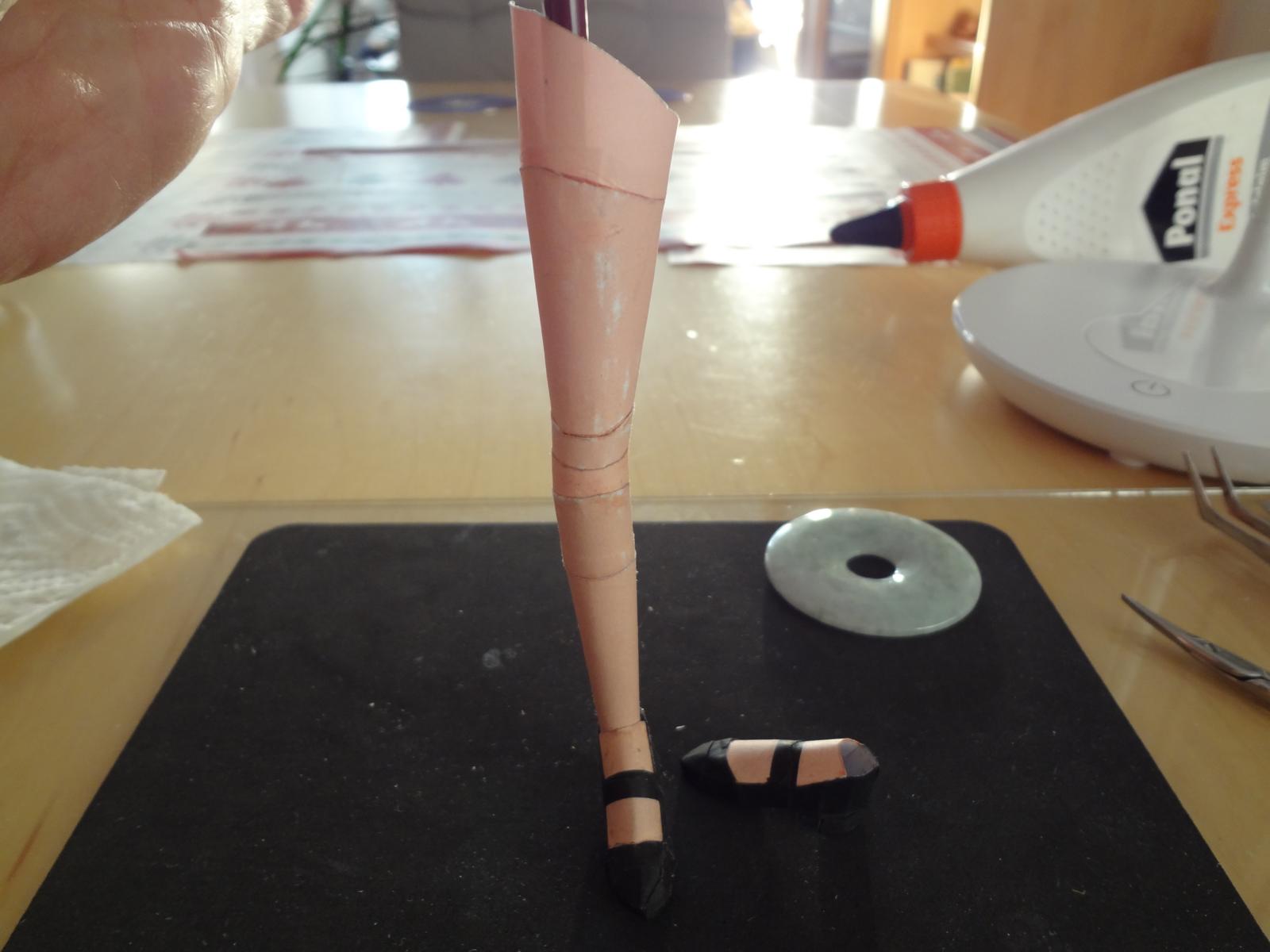

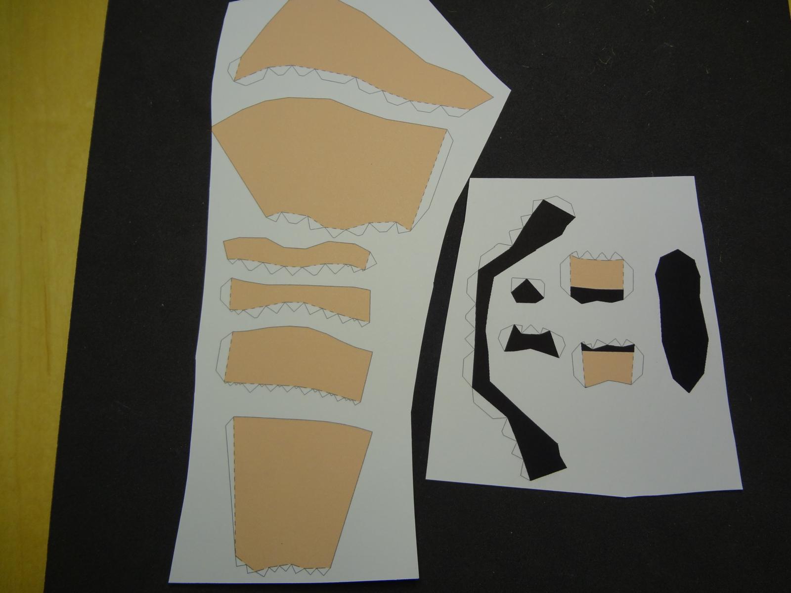

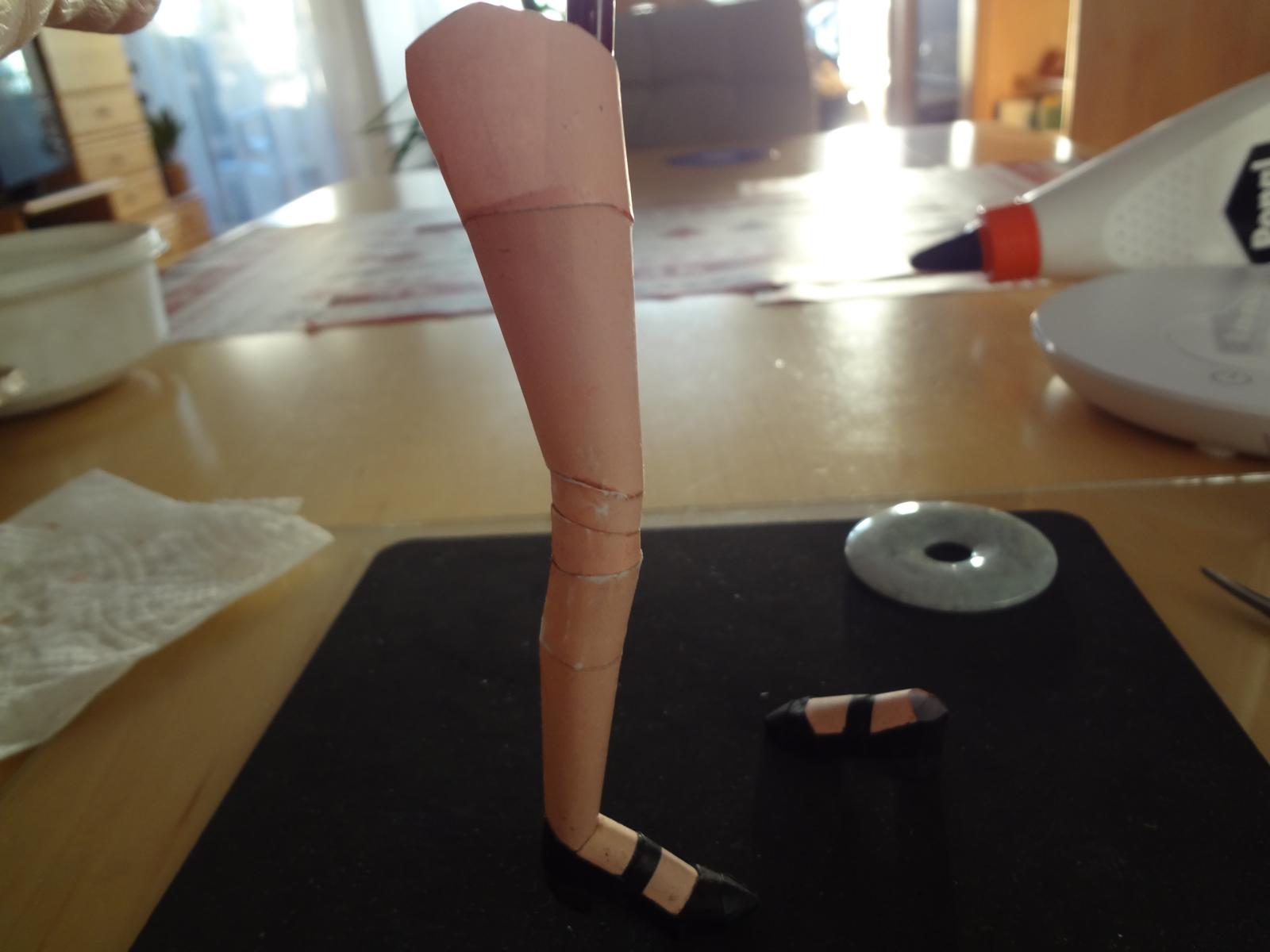

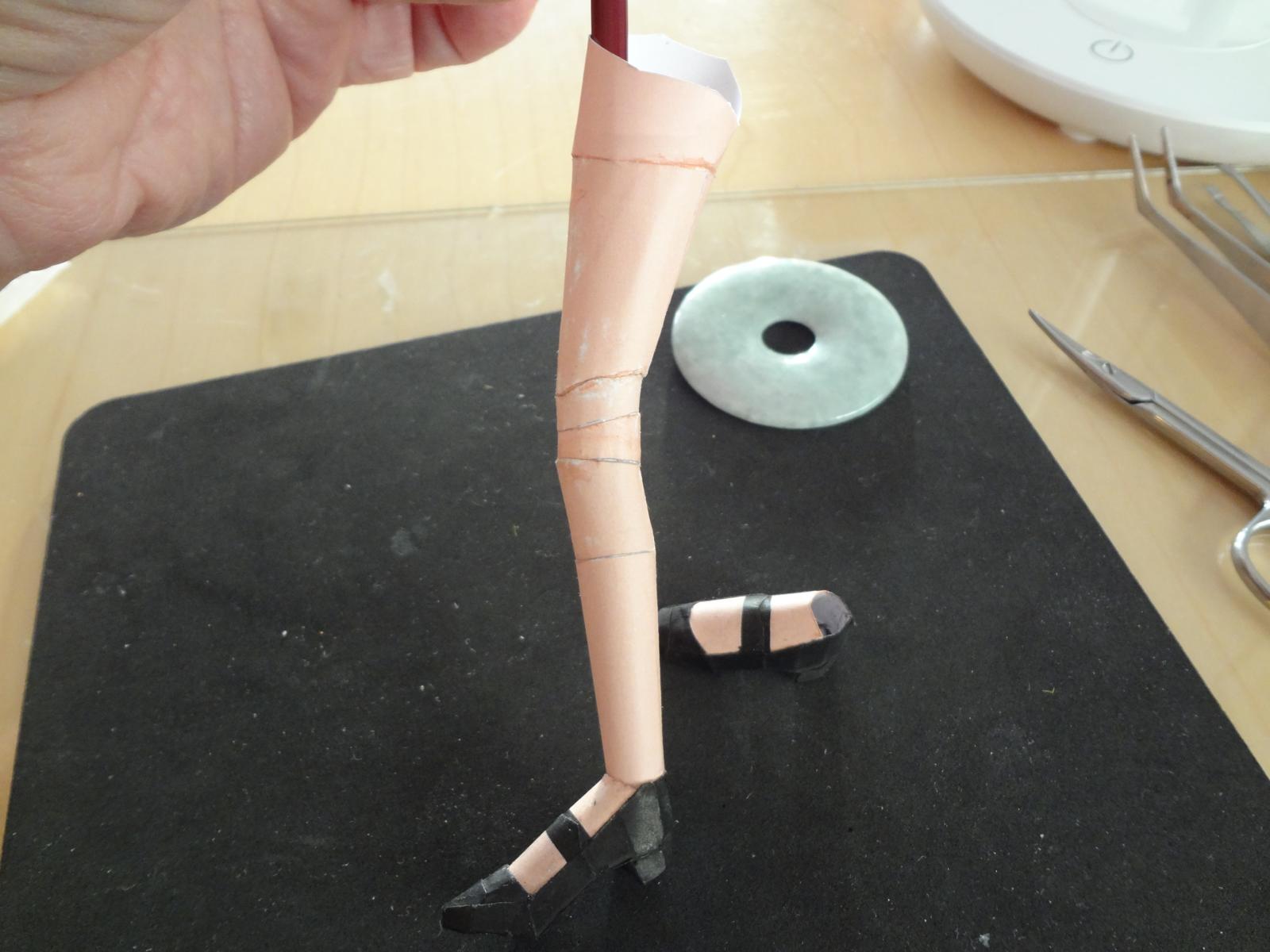

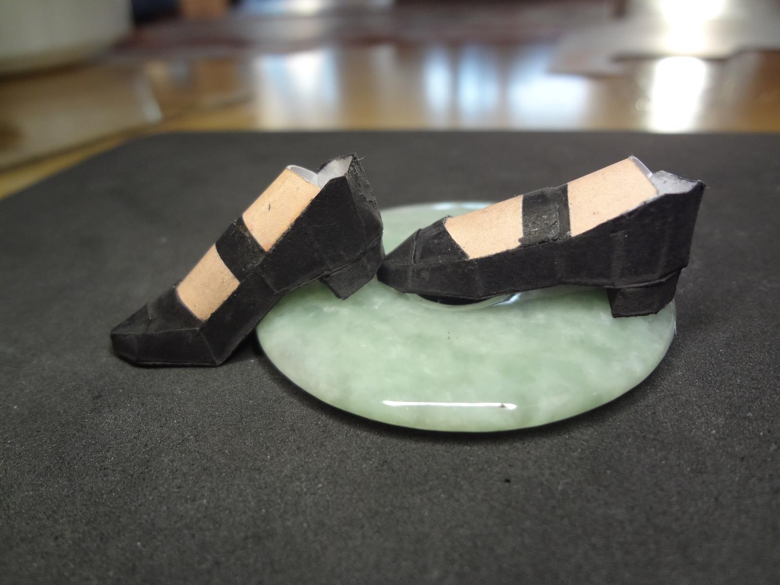

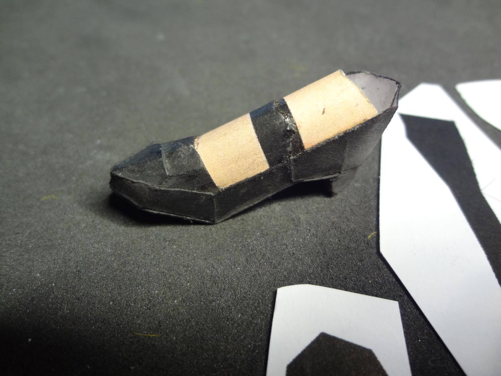

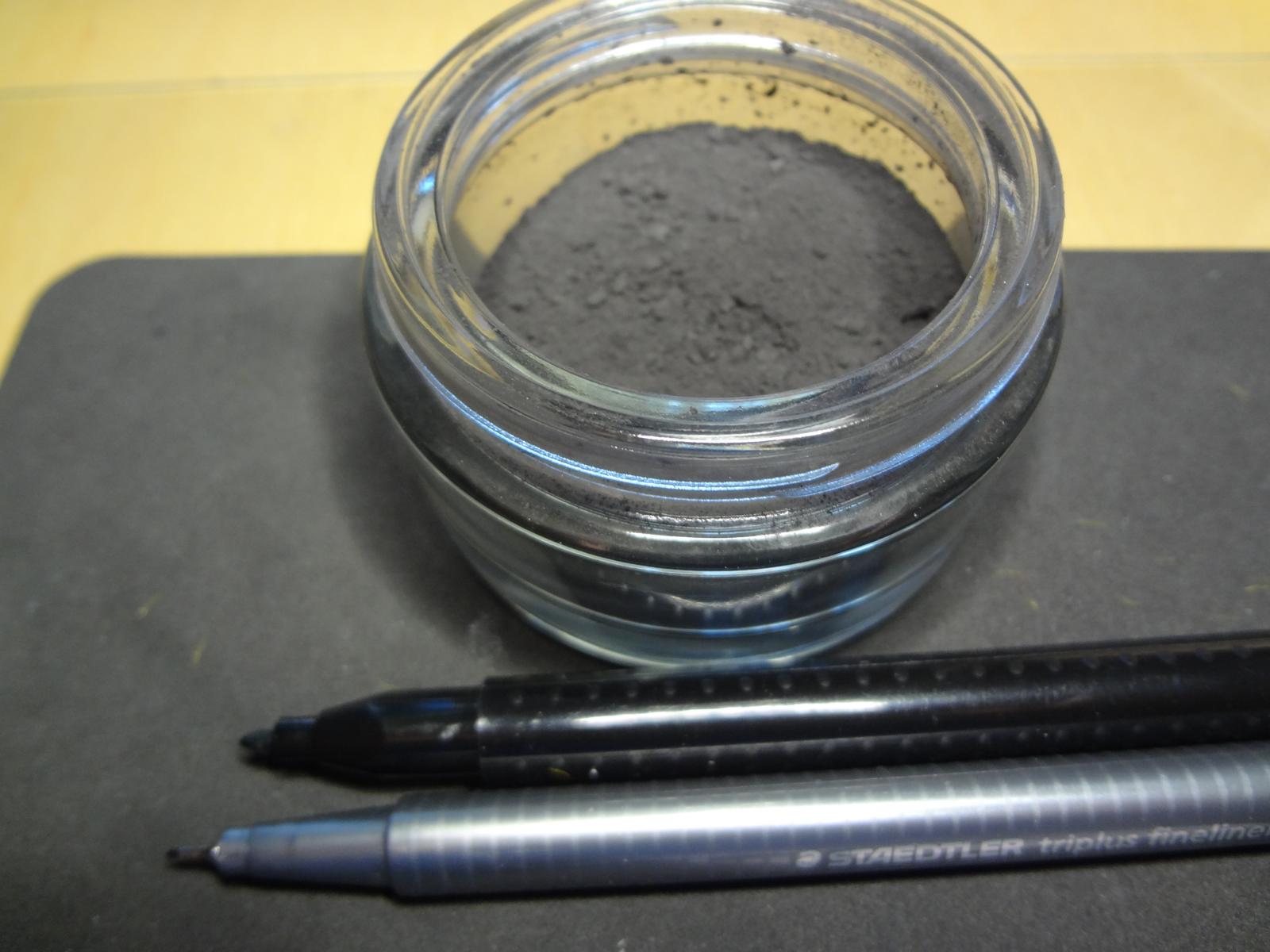

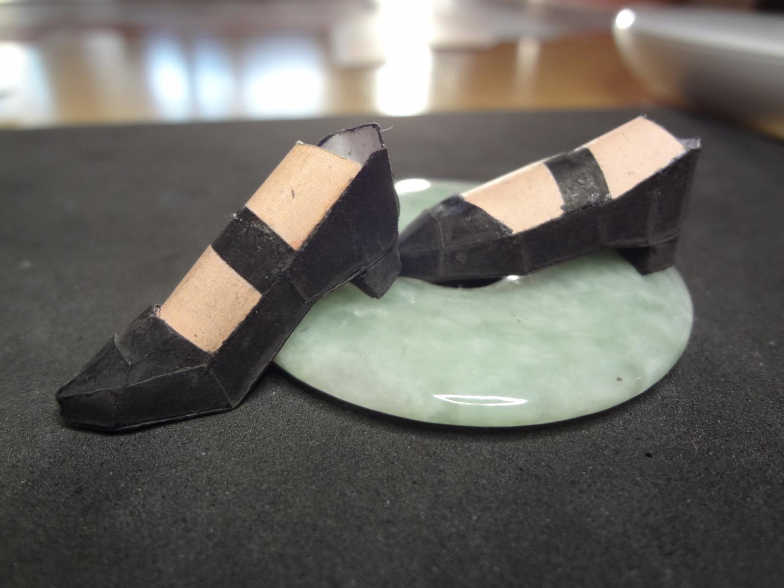

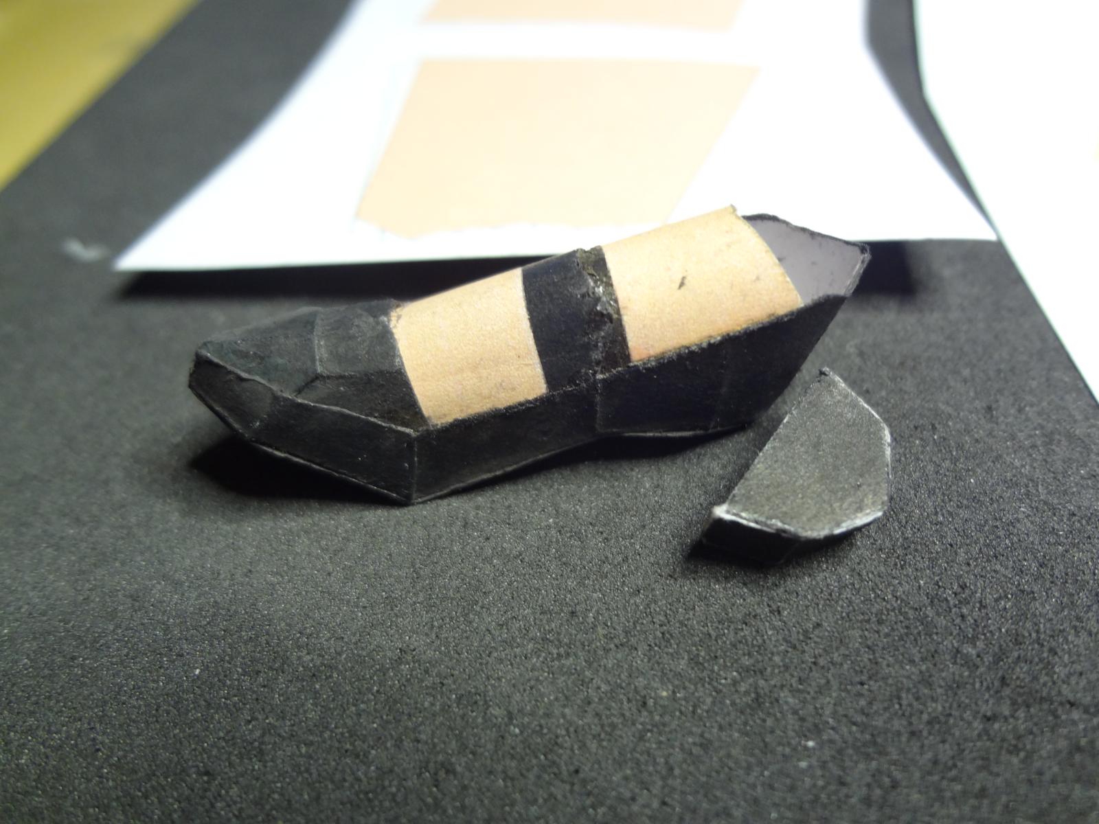

the shoes are finished, but they are not the same (see picture of the figure in the second post). thought I had made a mistake. I continue with the legs...important helpers are finereader and pastel crayon powder.

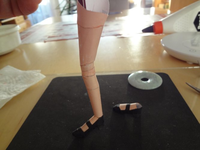

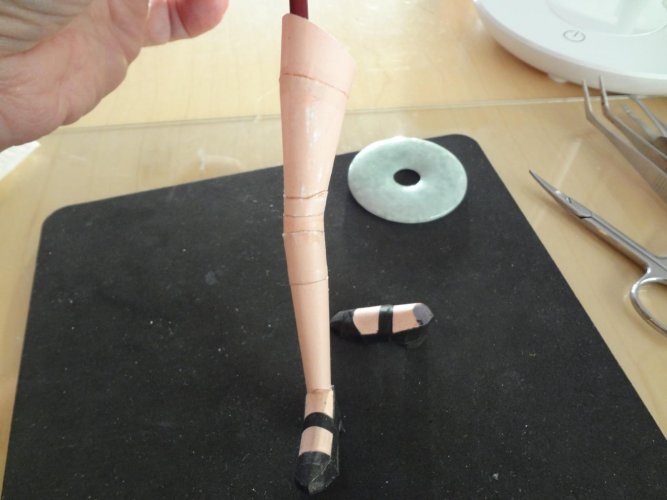

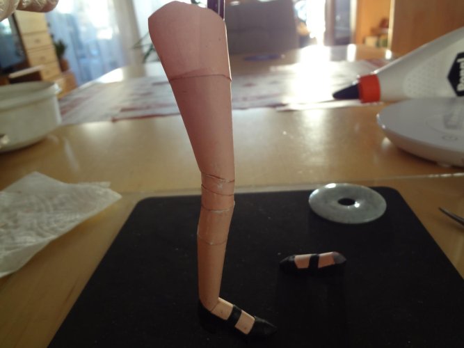

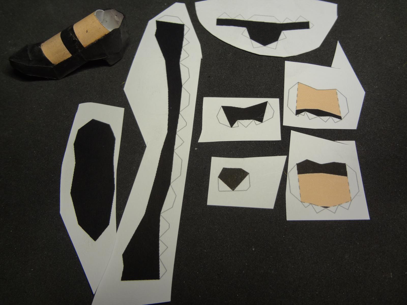

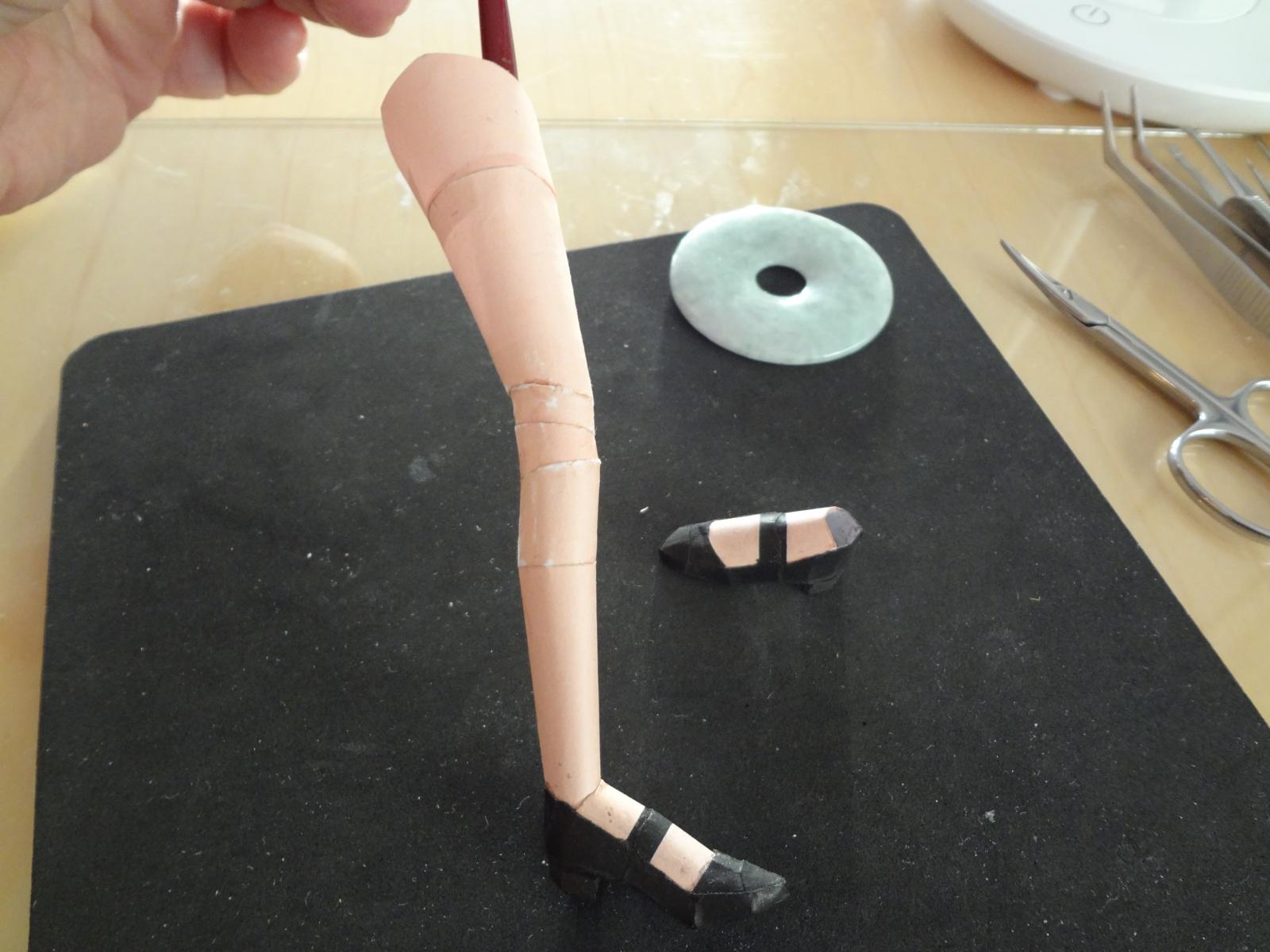

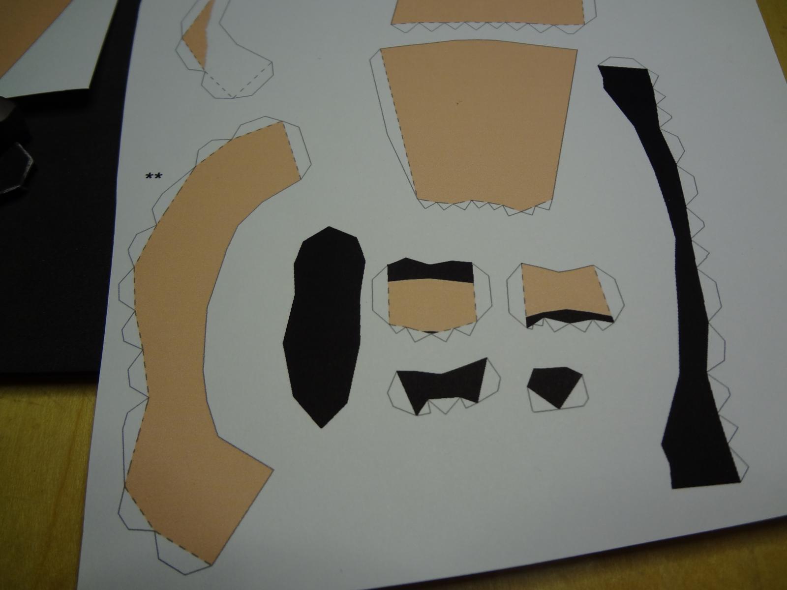

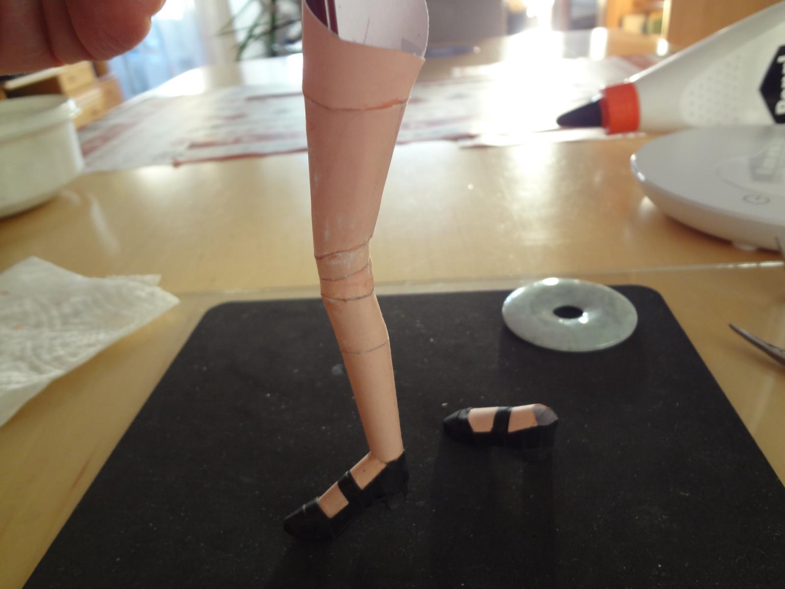

right foot ready. Don't be irritated by the sanding work, unfortunately it is essential despite having your own adhesive folds. The figure will be airbrushed with new skin color after completion.
Continue to the left foot...

Yesterday we watched "A Private Function" starring Michael Palin. Your leg reminds me of the scene in which the inspector drew a line on the back of the leg of his crush to pretend she was wearing silk stockings. Ok, I know it's not "your" leg, but technically it is. ... I'll better stop writing now... :rolllaughing::drinksmile:

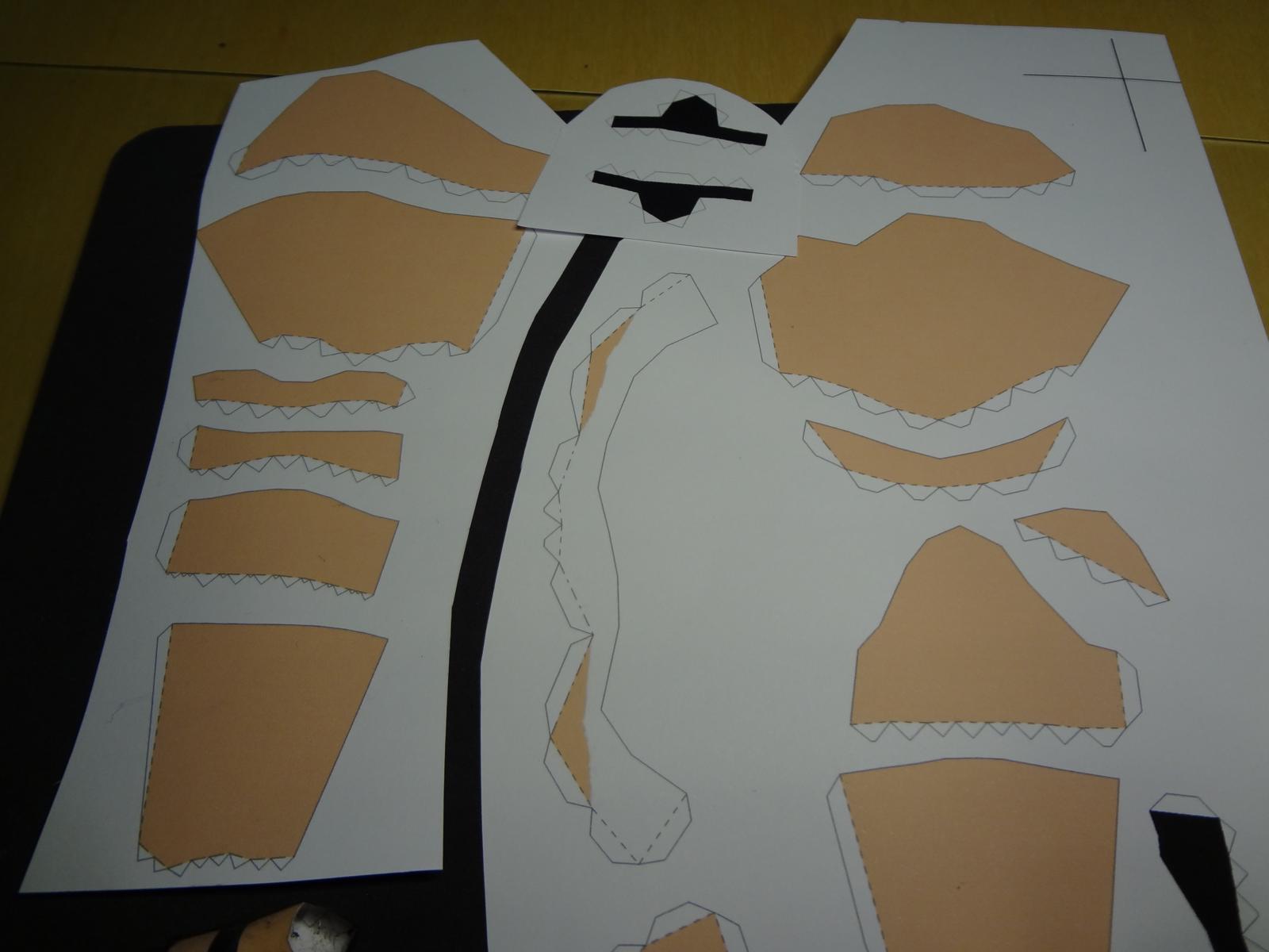

I give up - Pepakura cannot be used for such figures. Since you never know exactly where to “fold”, nothing fits together over time. The glue joints look horrible. The program is ok for other models, but not for such demanding figures. But I still have a lot of figures in stock as pdf. I will return to my “normal” models for the time being, as I have a large selection.
