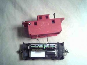

If you're using the Apex ones, I just made up an onboard battery setup like so;

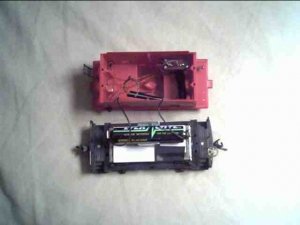

The light is turned on and off by a switch routed thru a rear window using a very small nail. It could just as easily be done thru the smokejack as well. No one has yet pointed it out in 8 years of ops. The battery is 3 years old to give you an idea of how long it lasts. I've had it on for 6-8 hours at shows. The extra weight helps the car to track well and the battery will never fry those 1.5v grain-o-rice bulbs.
