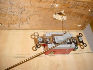

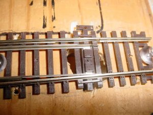

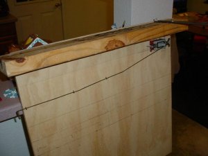

Would you throw a turn-out using a mechanism like this?
This is an experimental version. I used a coat hanger for the push-pull rod, an everyday type electrical light switch for the mechanism, and a piece of tie wire to connect up to the turn-out. Perhaps a piece of small diameter spring steel or brass rod would work even better.
It actually operates fairly well. The push-rod would extend through the fascia and a cabinet drawer type knob could be epoxied on.
The switch contacts could be used for signals or indicators lights or something. Could be either a single pole single throw or a single pole double throw as needed.
What do yall think? oh... just so no one is confused by the pics... the side of the 2x4 represents the top of the layout and the turn-out is sitting on that, the piece of plywood is not the top of the benchwork, I was just using it to try out different angles of the pushrod, seeing just how far down I could go and still make the switch work.
P.S. I saw an idea similar to this on the internet and modified it using different stuff.

I'd say that as long as it held the points solidly in either direction it should work fine. Using the contacts to control indicators would be a must or you could have some unfortunate mishaps. The only draawback I see is that you'ld have to have something verticle under the benchwork to mount the switch on so that it would be oriented corectly.

The electrical switch has 1/2 inch of travel from one position to the other. The turnout has 1/8 to 3/32 of movement. The tie wire acts like a spring and puts pretty good pressure on the turn-out slider mechanism... maybe too much. This could be adjusted by drilling the hole in the toggle handle closer to the switch body.
This setup seems pretty promising and straightforward for ease of building.

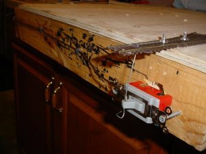

here is another photo. I rebuilt it so it would be more obvious. I think just an extra piece of 1xwhatever board attached to the benchwork as a crossmember would work great.

The thing that appeals to me about the regular type light switch is the positive spring-loaded throw. Also the length of travel of the handle would give a nice positive feel at the knob at the fascia, and you could tell the position of the switch by looking at the position of the knob.
Now, if the travel is too much compared to the travel of the points, the hole for the attachment wire to the points can be drilled closer to the pivot point of the switch handle.
