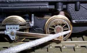

arc in question
Vic: The tender & engine wheels are clean. The so called journals where the axel ends ride are clean and shiny. The bolsters are also clean. The track is clean. It must be a continuity problem in the old wheel set. The attached image points to the problem area. " all 4 wheels are doin the arc thingie". It only does the arc on occasions. Stops the loco dead. I'll dig my old multimeter out and check the driving wheels. I kind of doubt if they have a replacement for this old loco.

Hi Phillip, Somehow I got the impression that the tender wheels were arcing. Please excuse my misconception:oops:
I see what you are talking about. Its obvious that the insulation has broken down. Actually, the Mantua engines have changed little. You should be able to get replacement ones.
I've had some luck on old brass engines with this problem by pulling the offending driver(s), seperating the tire from the center, cleaning everything up and then putting a thin coat of 5 minute epoxy on the center and pressing the tire back on. Be sure to leave as much of the old insulation intact as possible. This of course is a hit or miss fix and it doesn't always work. The better solution is to replace the driver.
