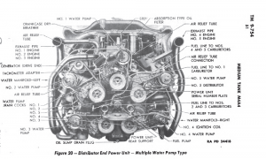

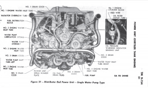

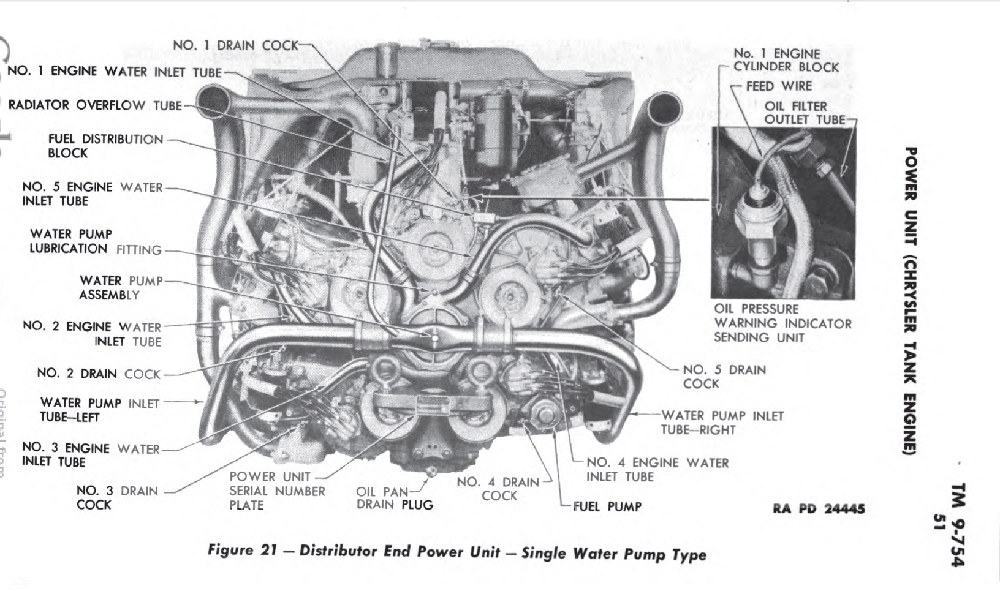

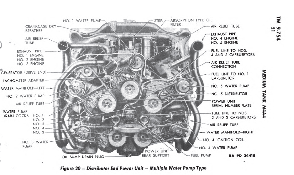

Some good info on the Sherman Tank Site HERE
and all the pictures in the world HERE
I never really thought about it..but this engine is a Monster!! Talk about 5 engines on a central crank!! OMG!
According to the pics you supplied it used a fuel distribution block, probably going to the side of the carbs, with one main feed line into the block. Metal lines was the practice. One of these engines in good condition can cost $50K or more!! ;)
