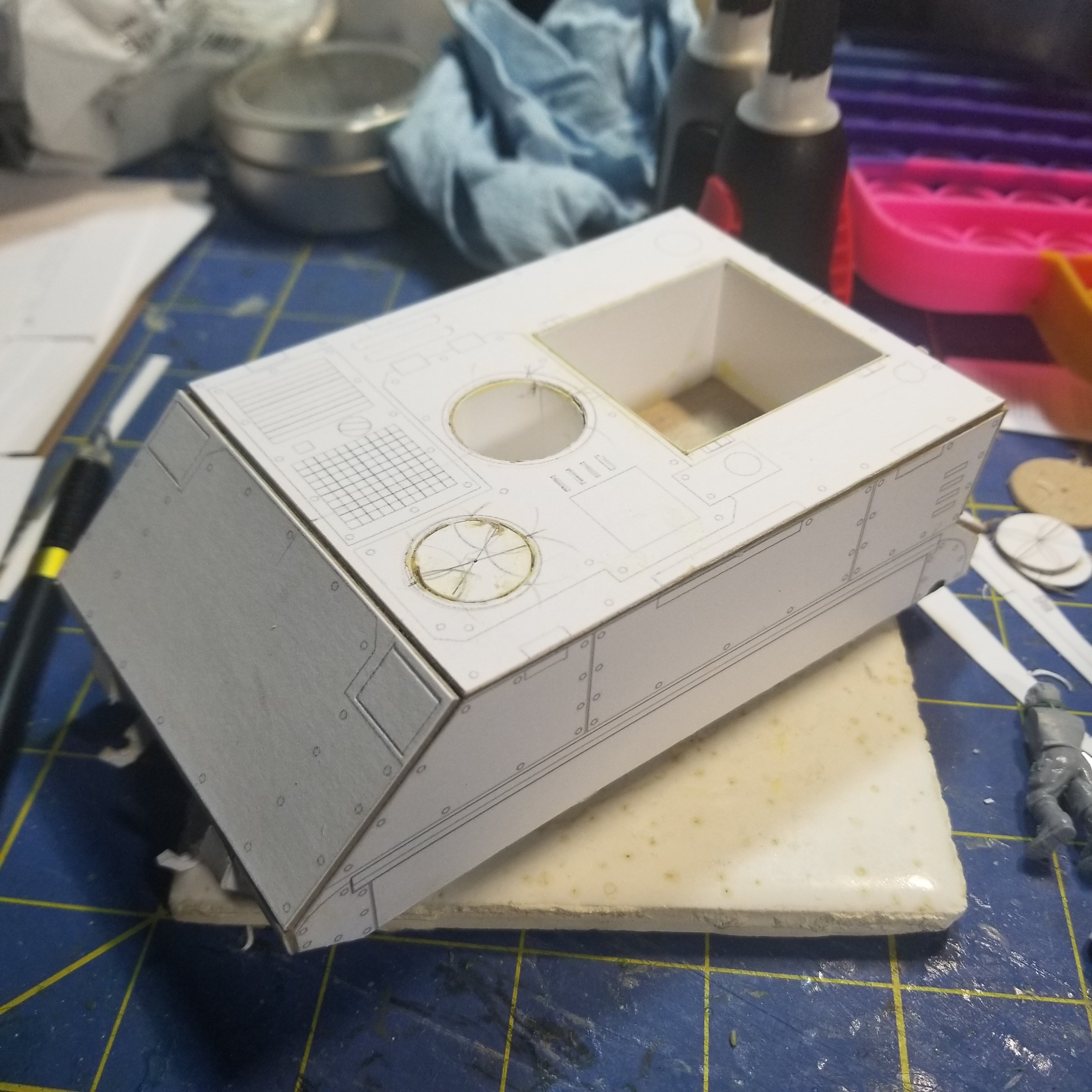

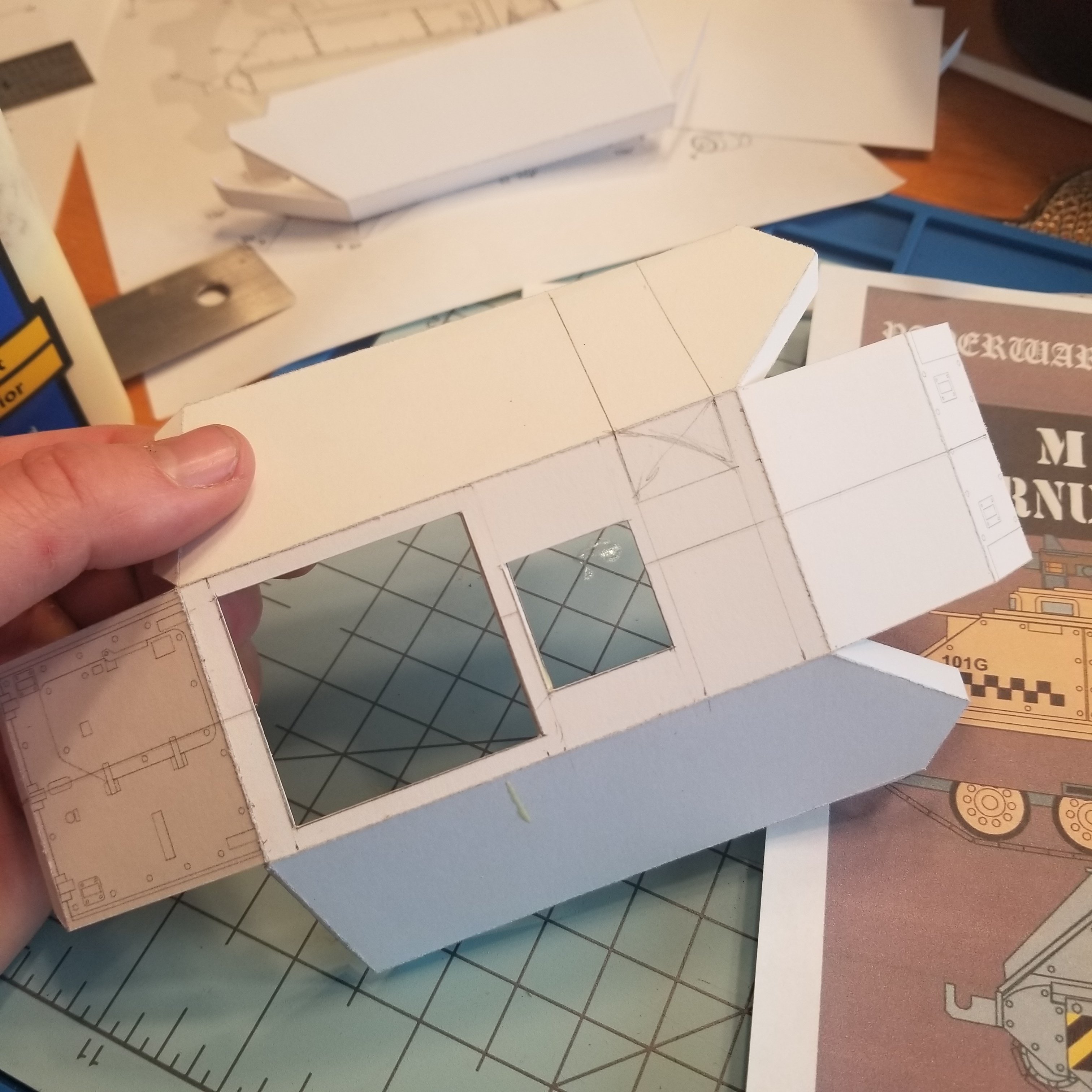

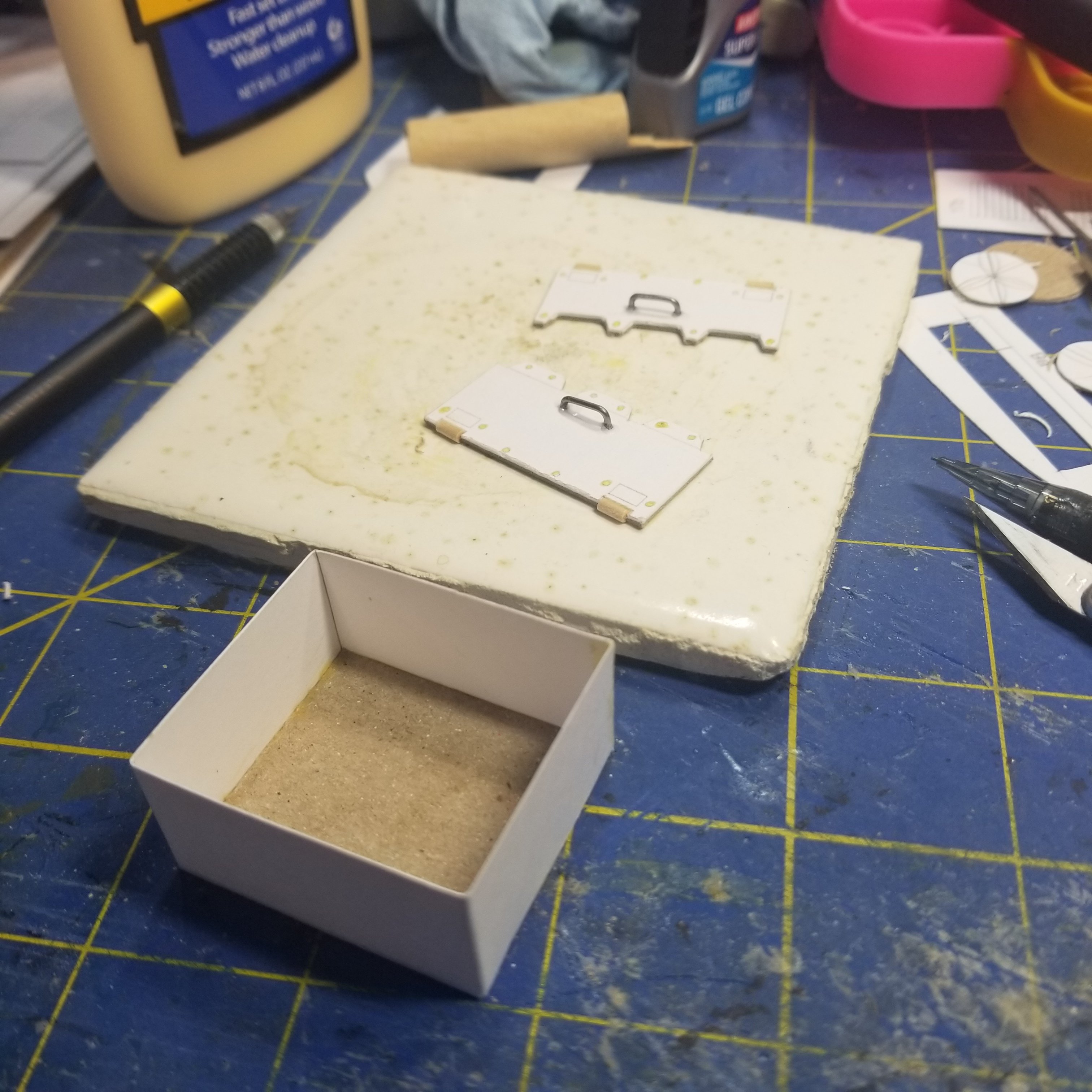

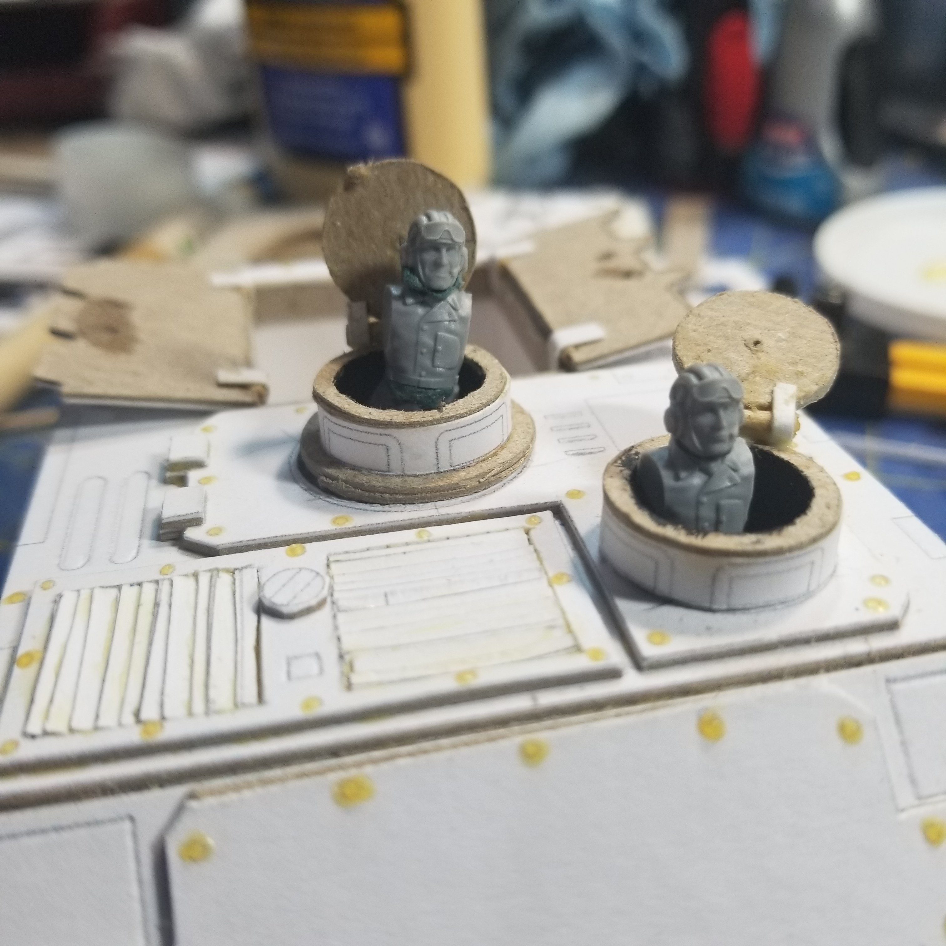

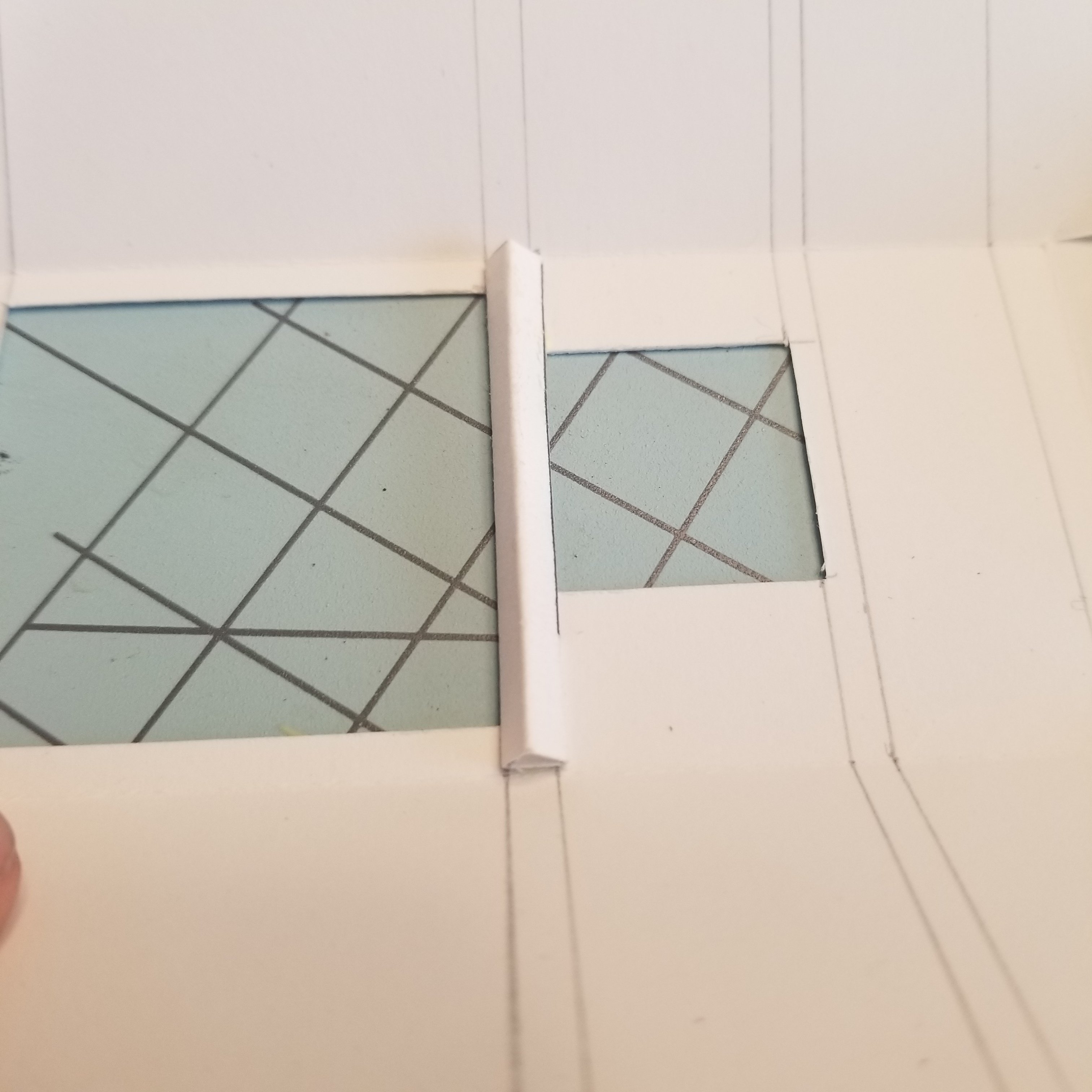

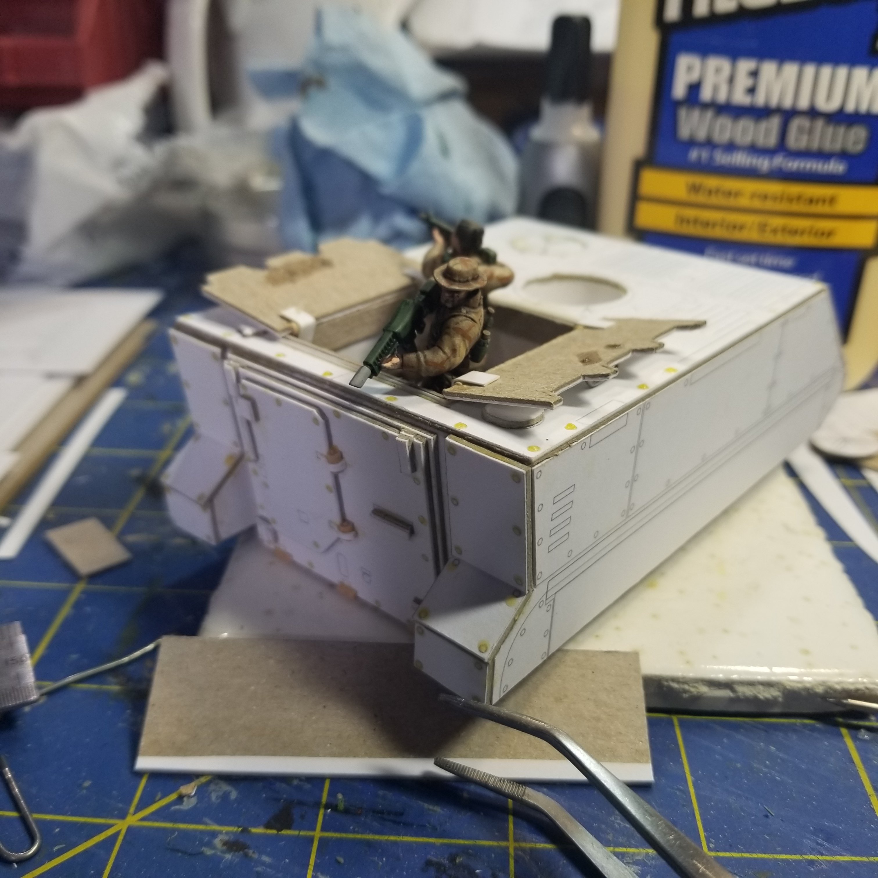

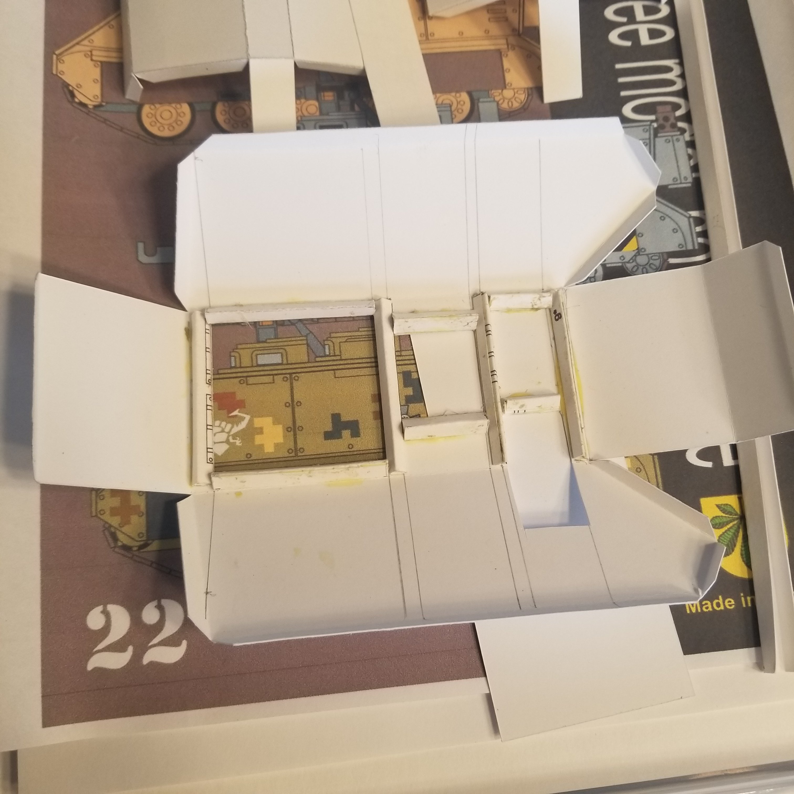

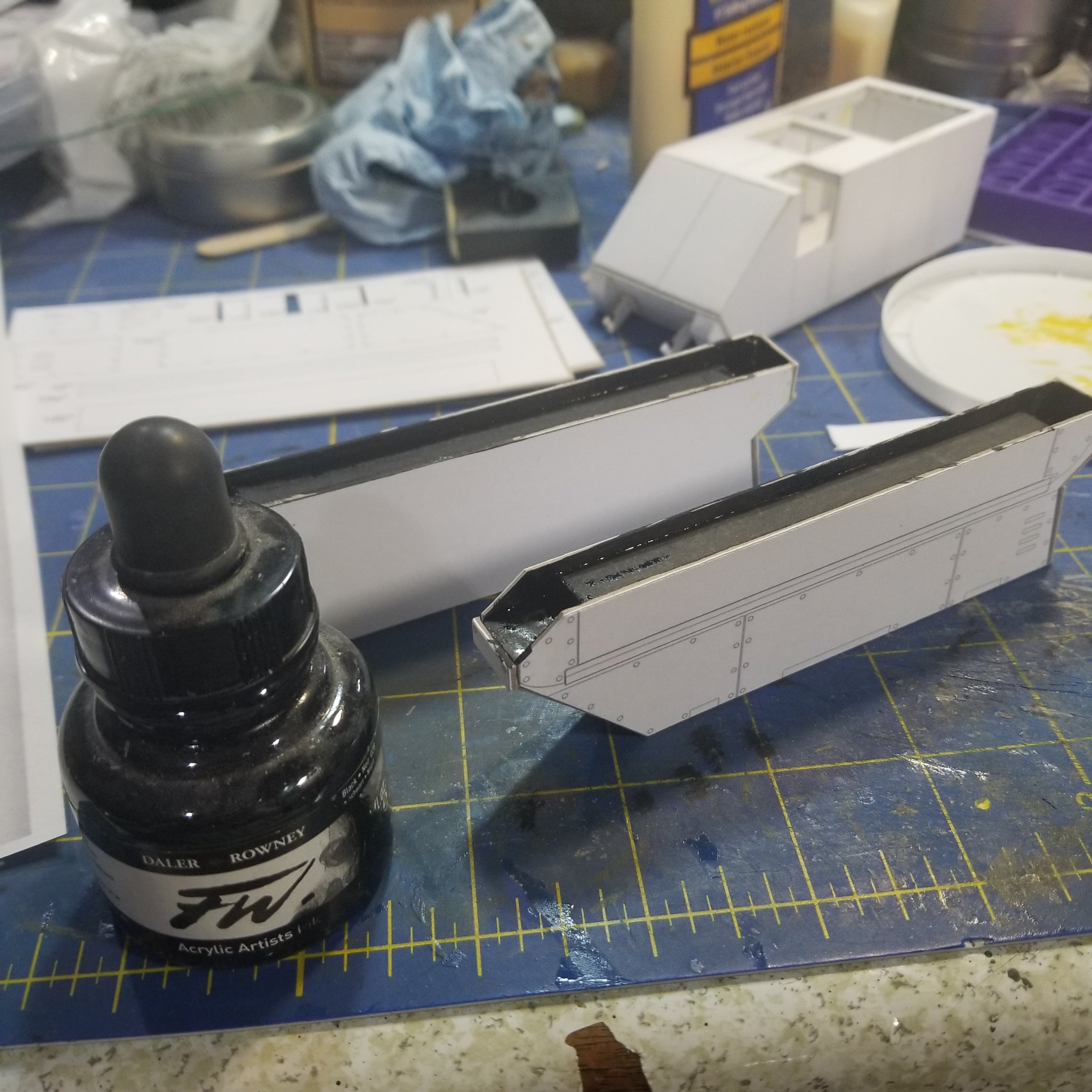

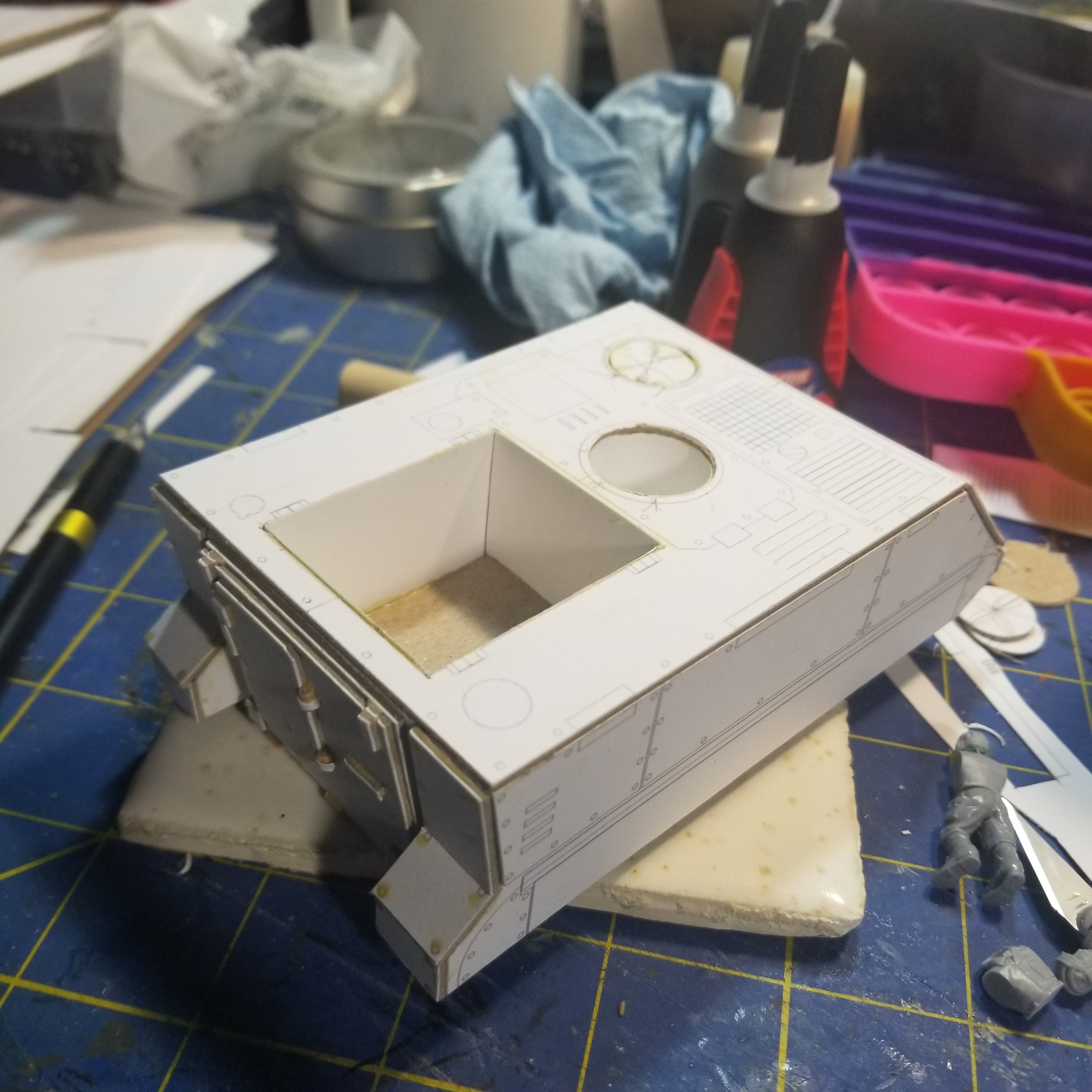

Finally got around to starting the Patoroch version of the M113 APC inspired, counts as, Classic Rhino. Started it a few nights back and for the main hull started and modified with some supports and some openings I intend to put crew into. Not quite ready to do a super detailed interior or anything (yet), but certainly some torsos and heads manning the vehicle commander/gunner and rear hatches.

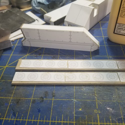

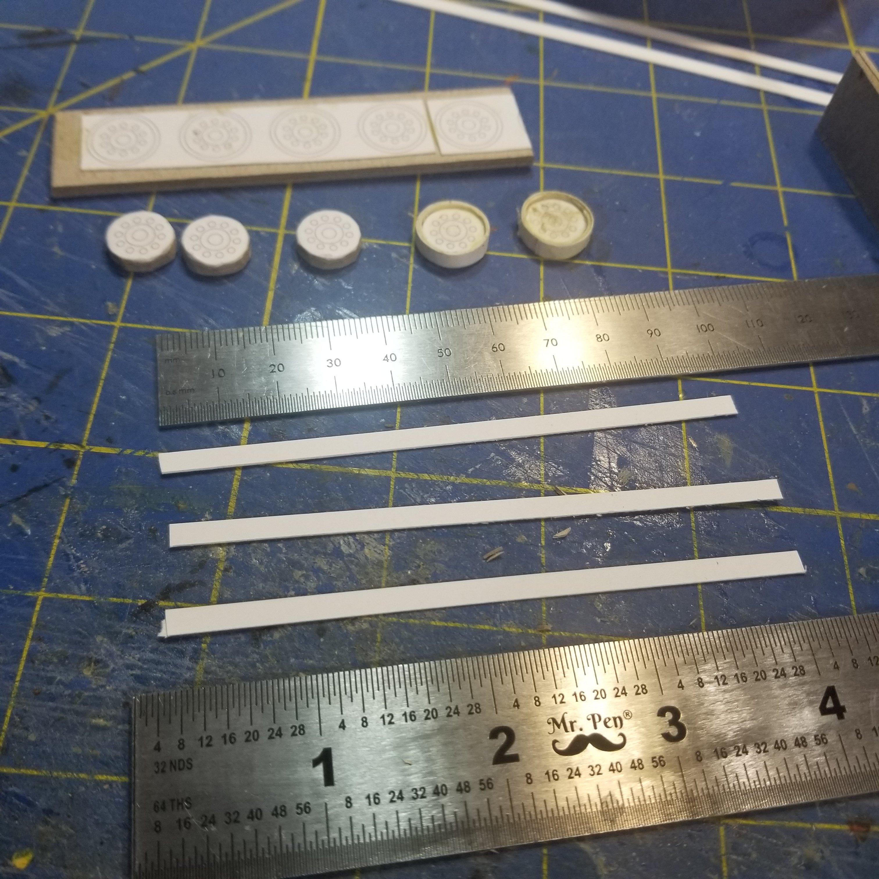

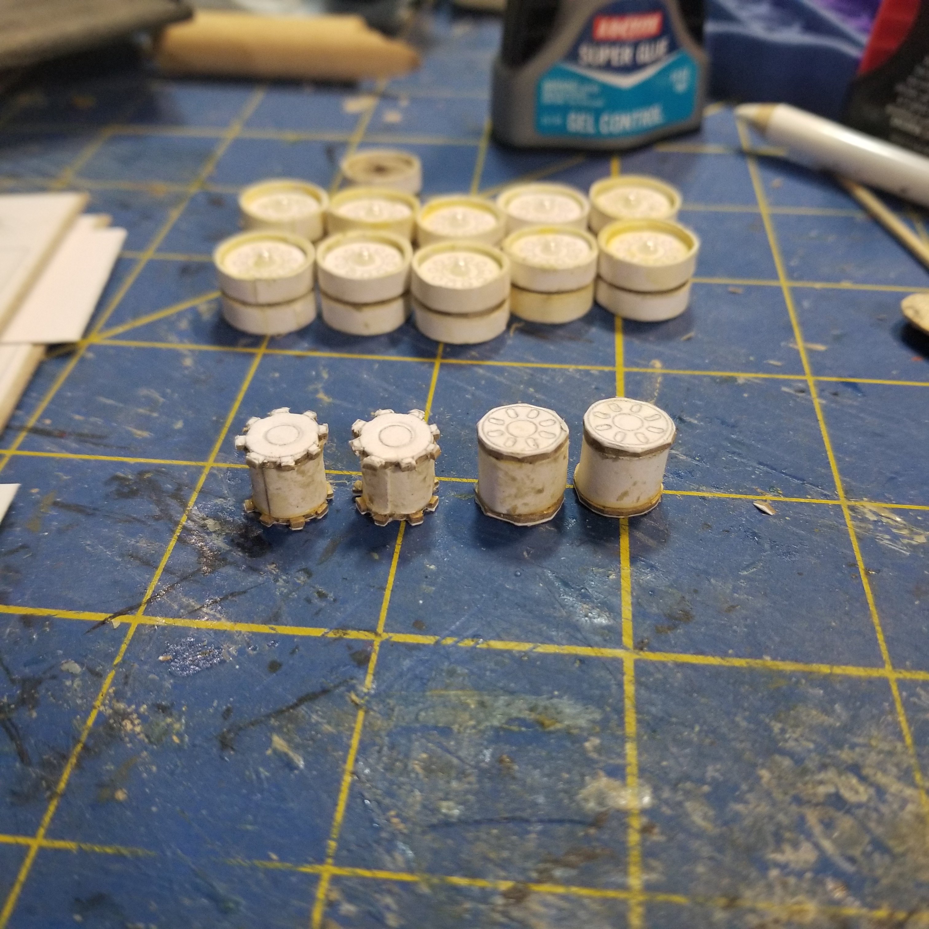

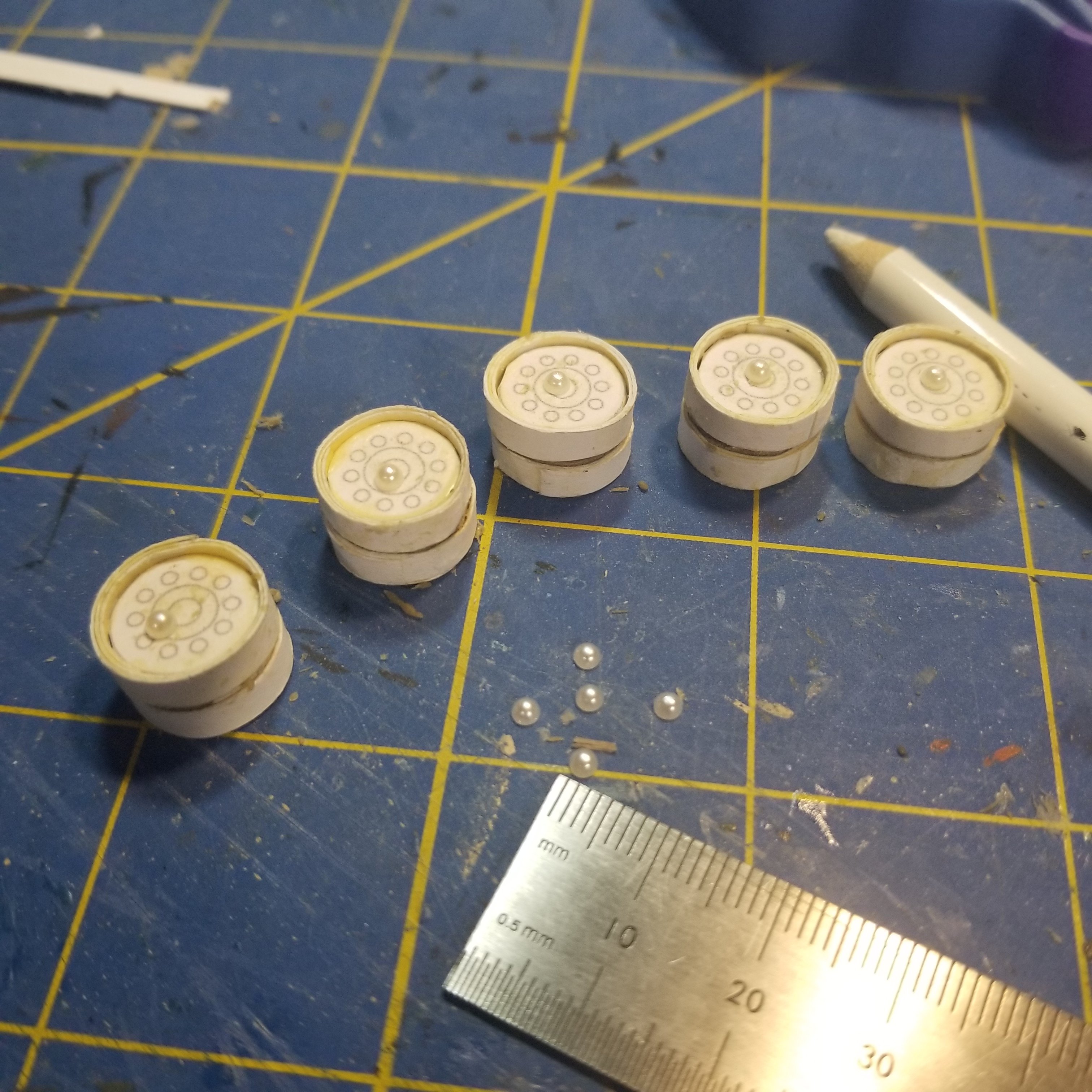

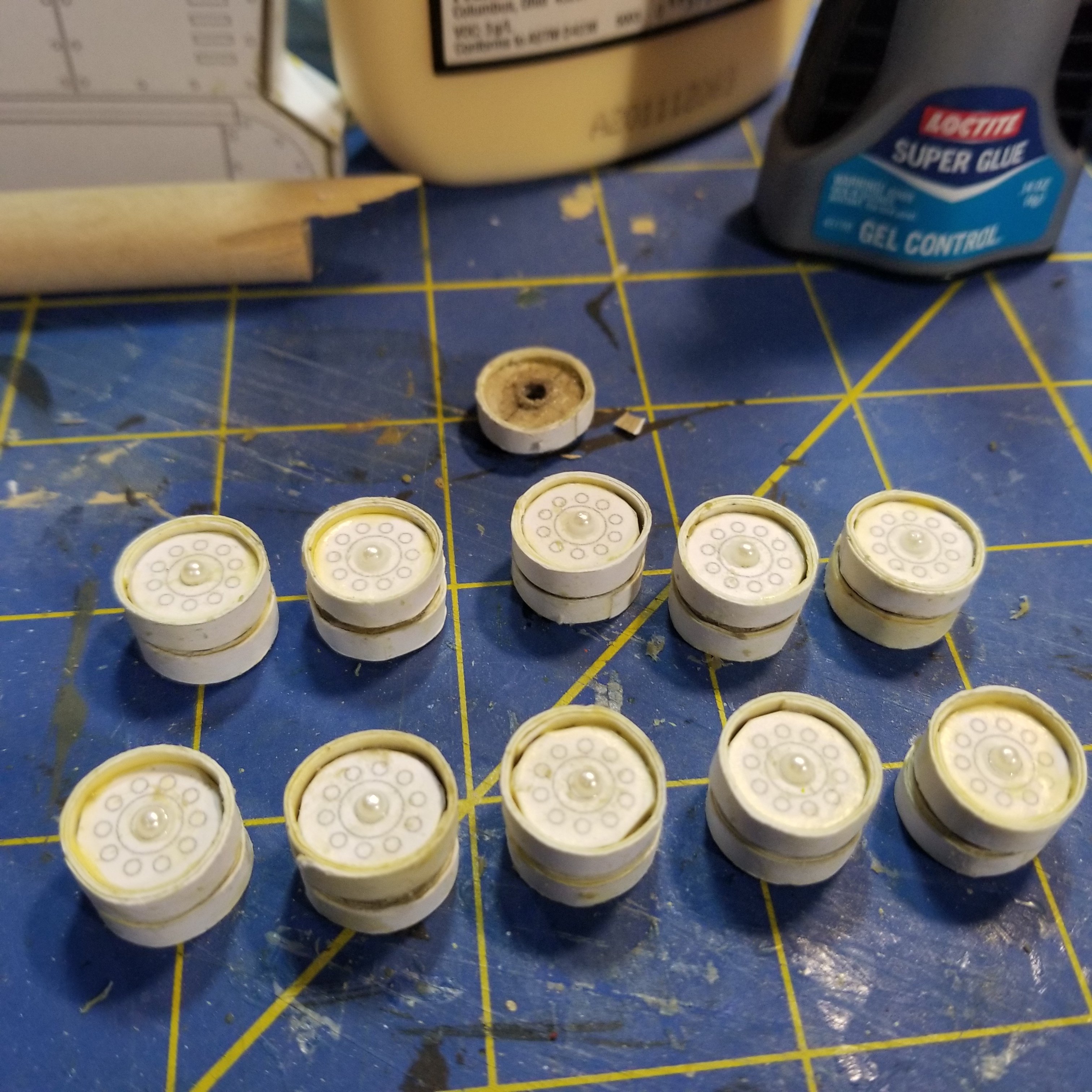

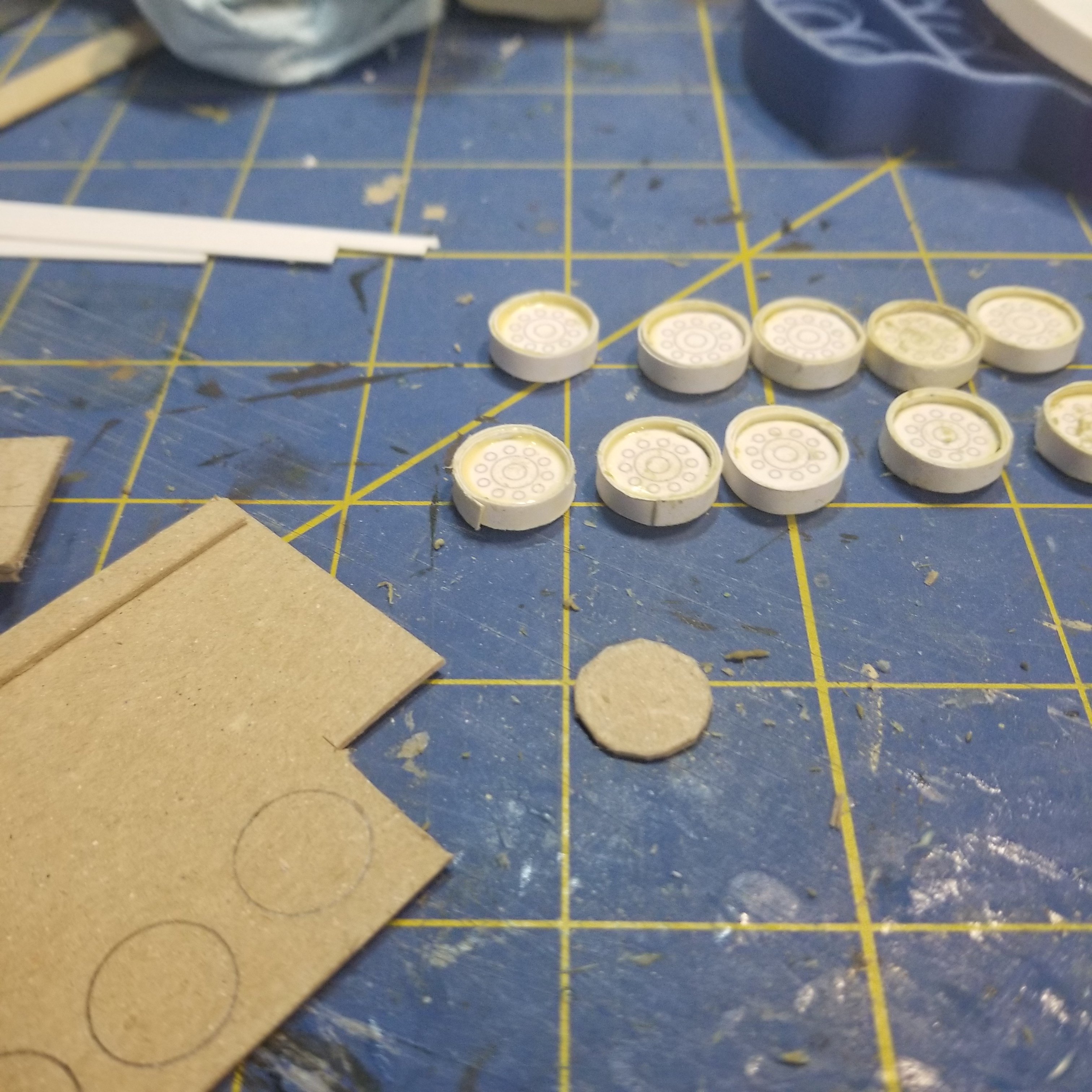

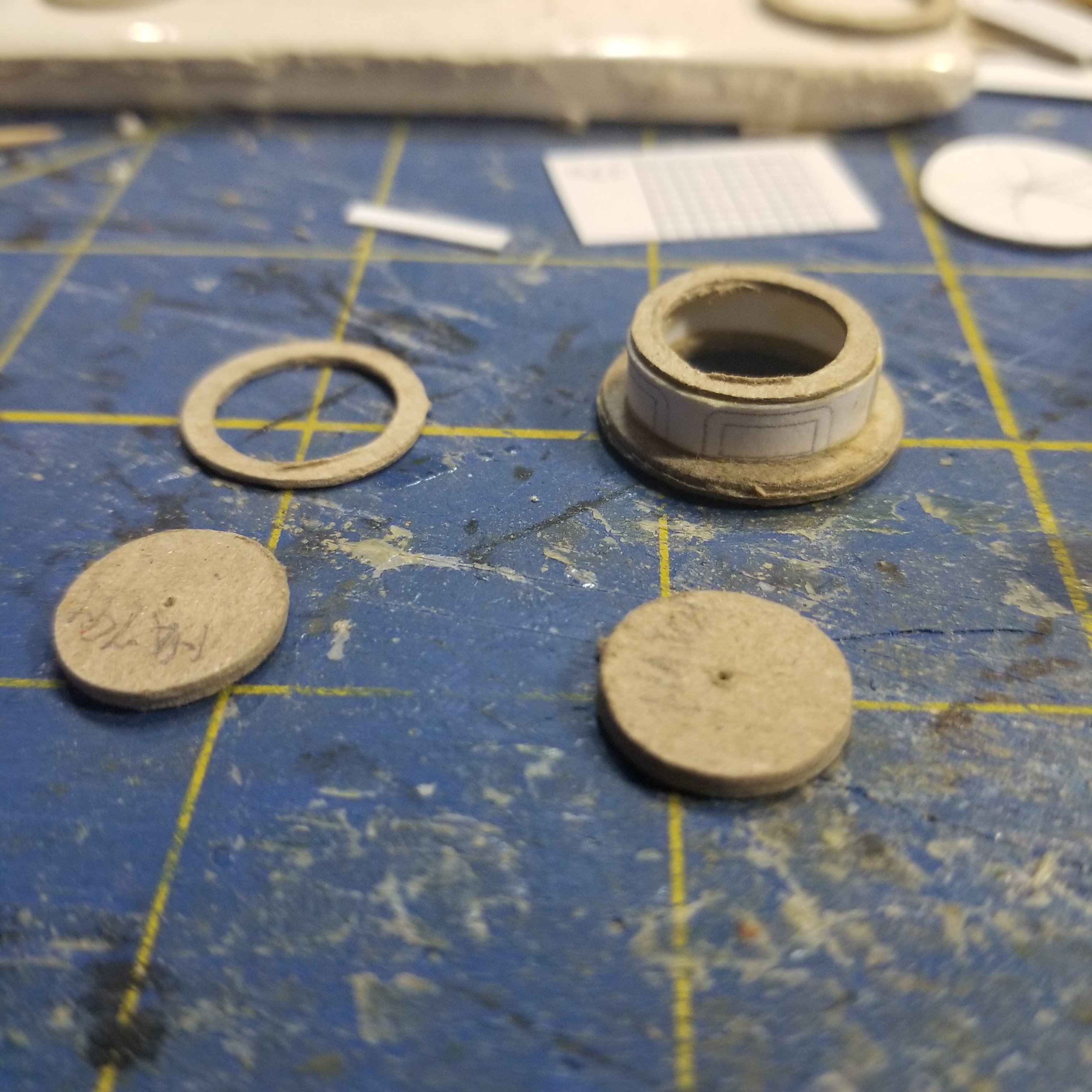

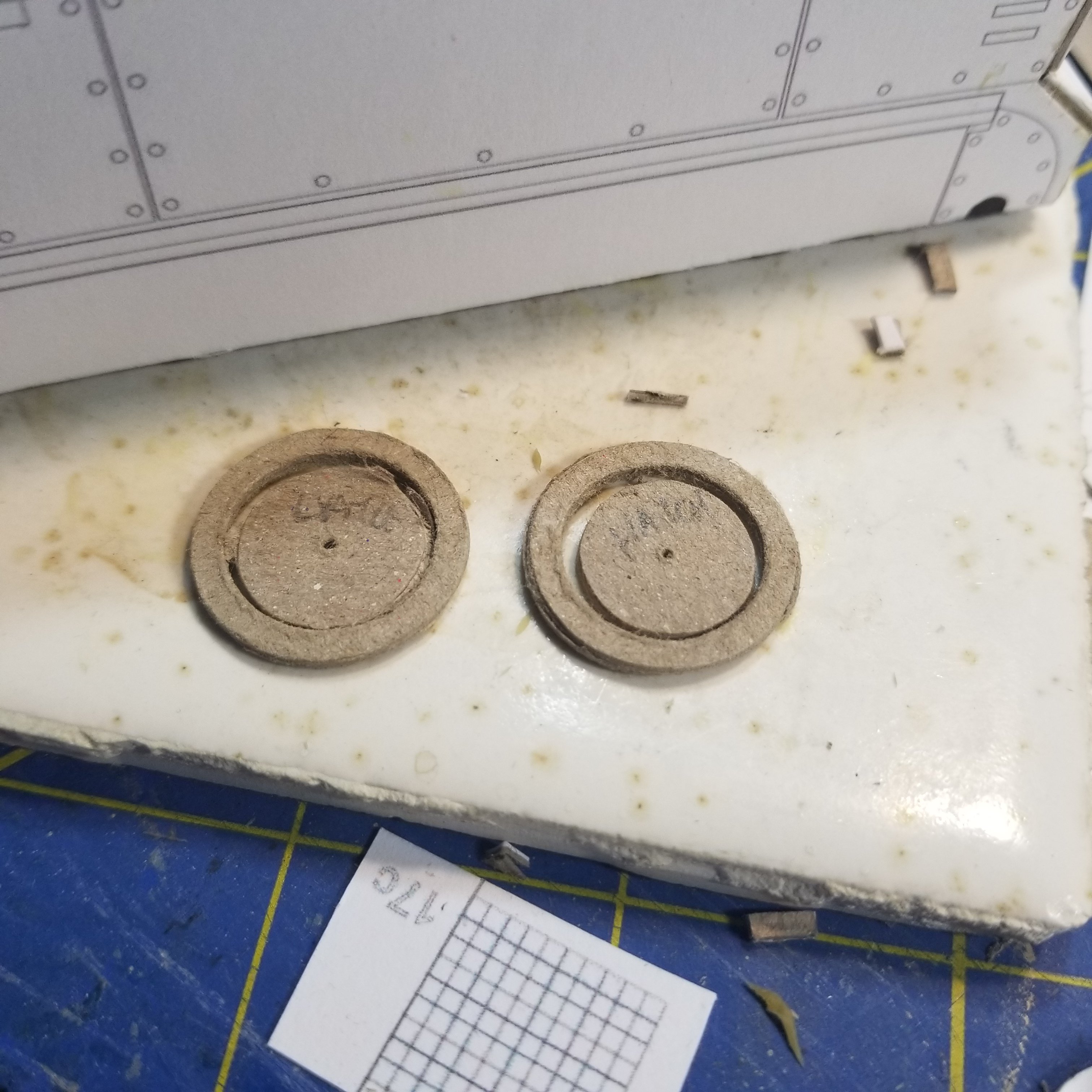

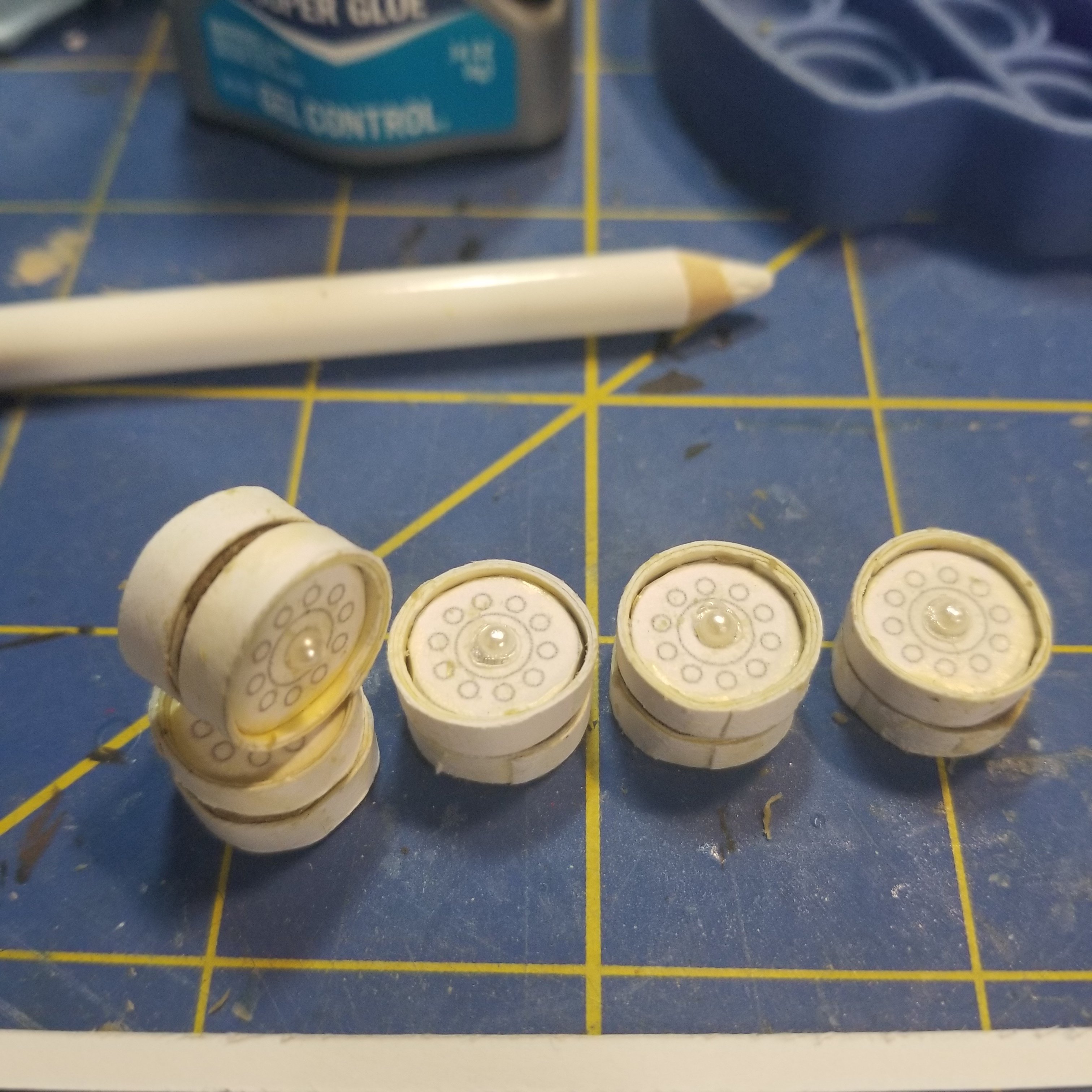

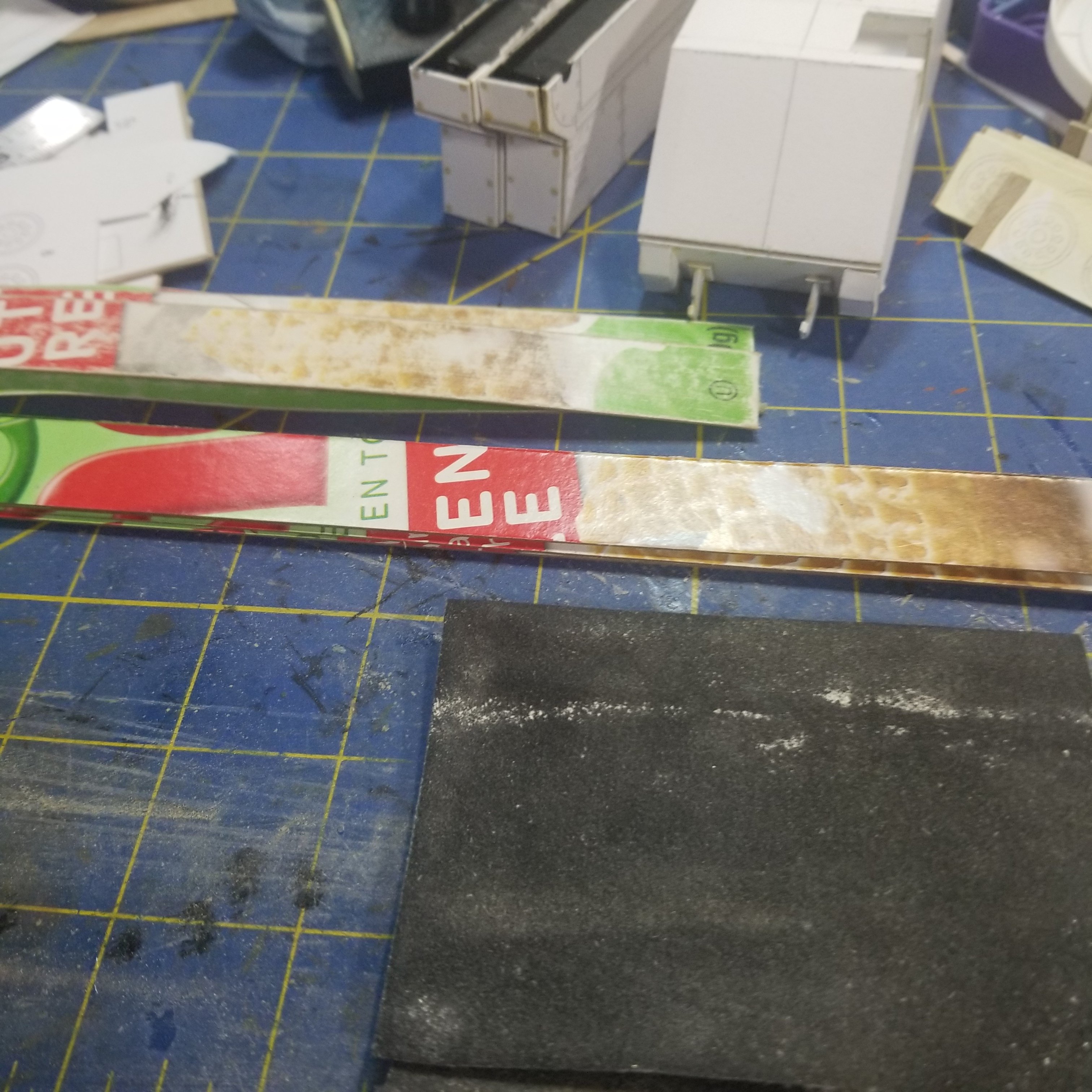

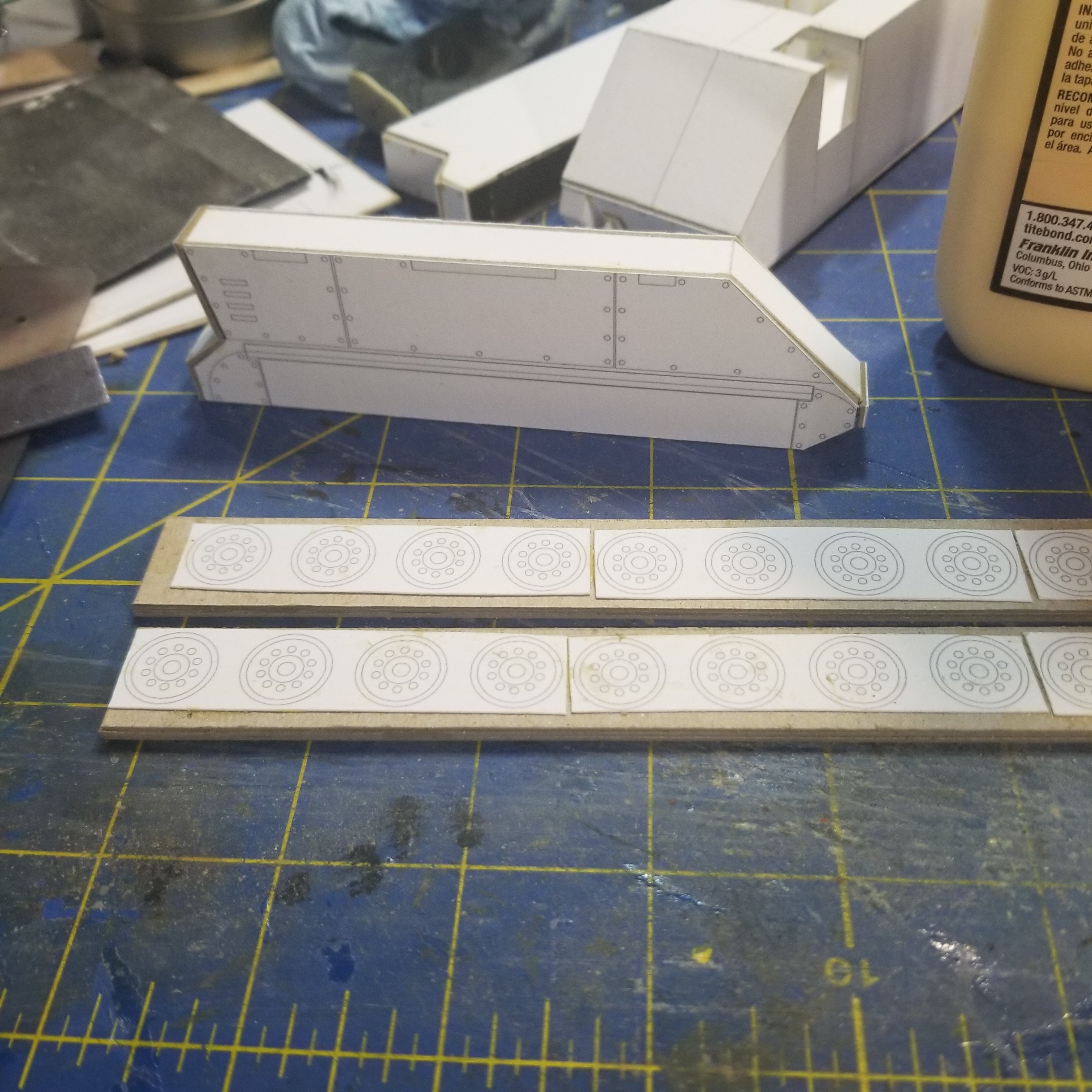

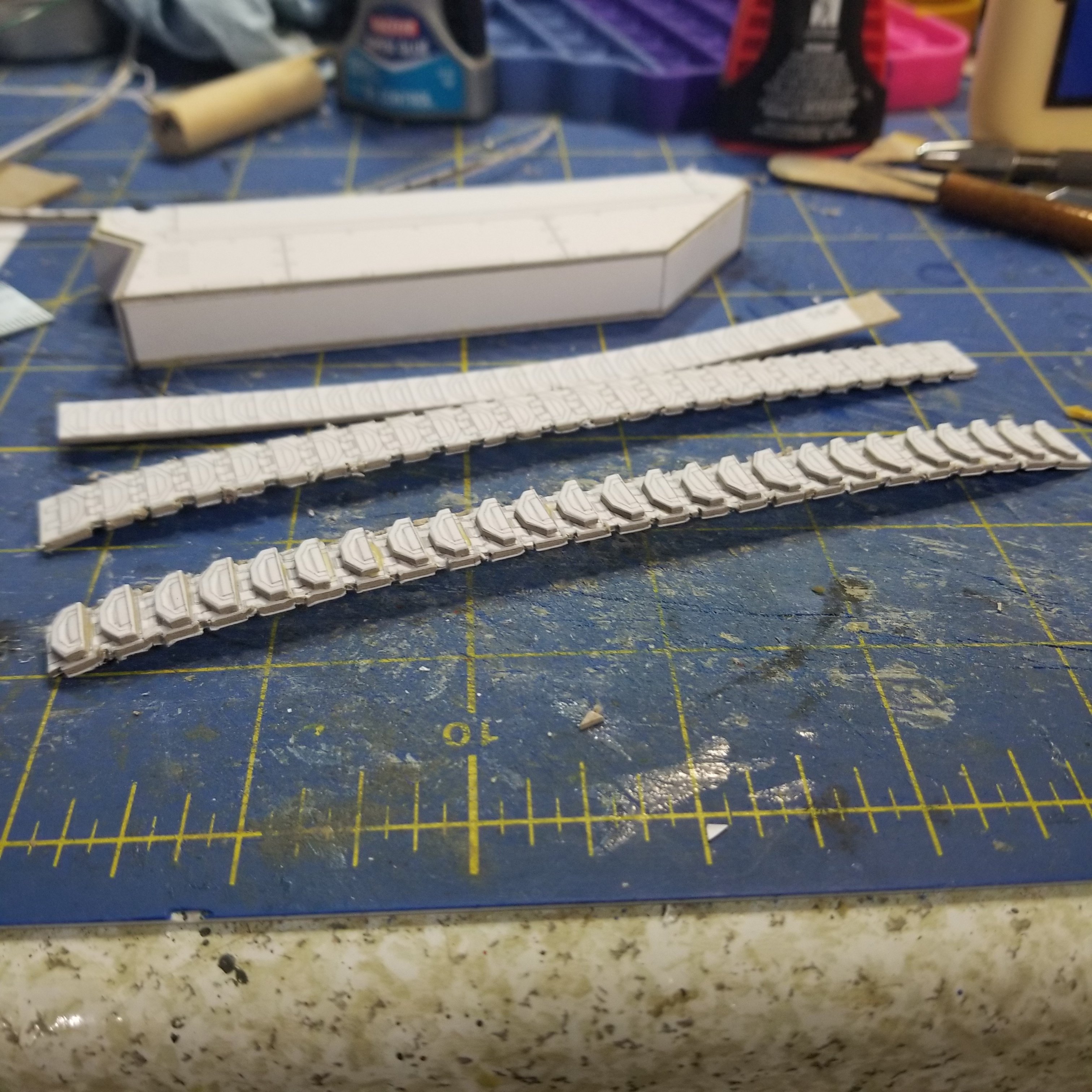

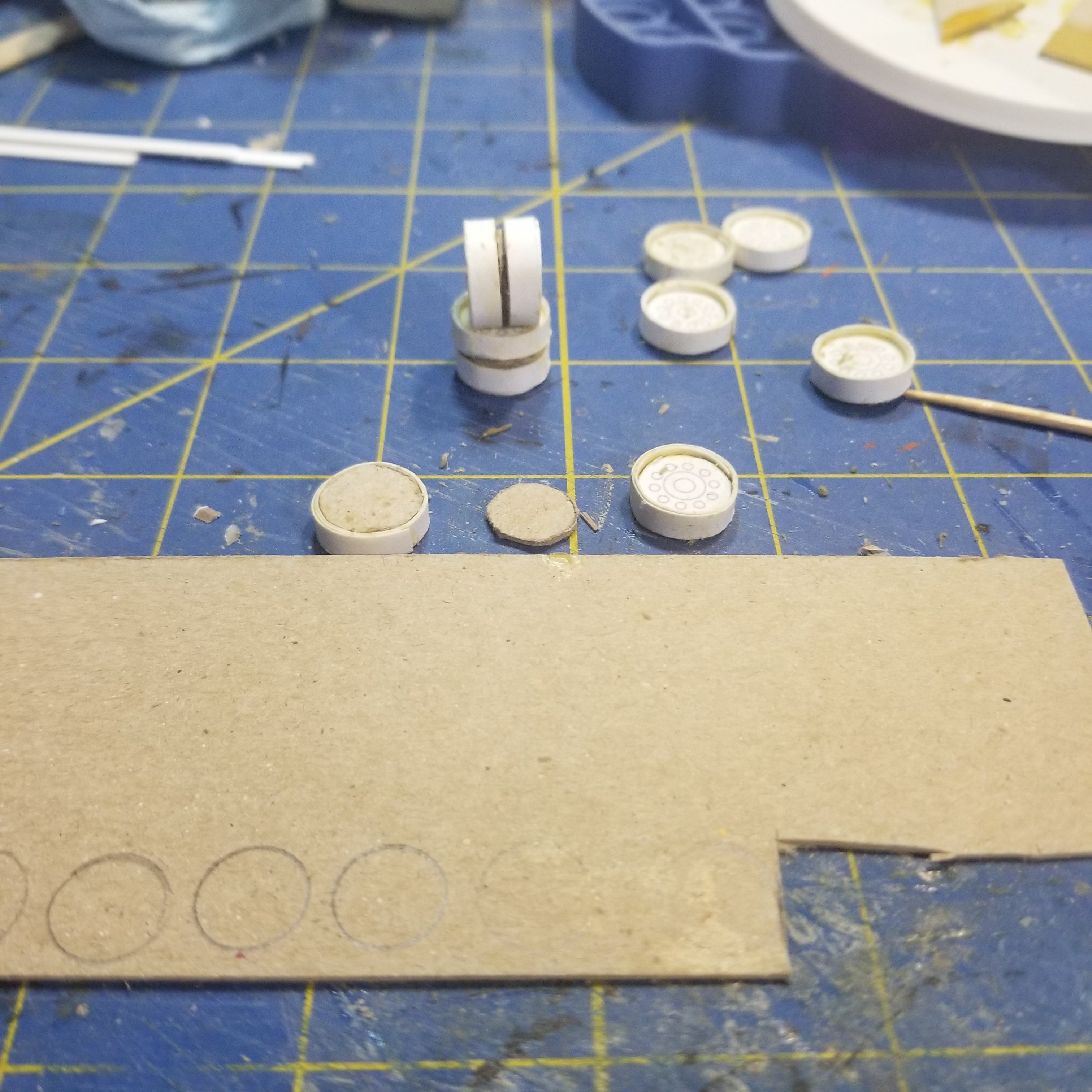

Road wheels for the track, the Sudsy way. Kept the inner and outer faces of the wheels, but laminated the hub with 3 layers of cereal box type card stock. Cut 4mm x 100mm strips of paper card, and gave each wheel half the wheel part (where the solid rubber would meet the steel tracks). Then another slightly smaller diameter cereal box cutout to get around a 1mm gap between road wheels, and then hemispherical beads as hubs.

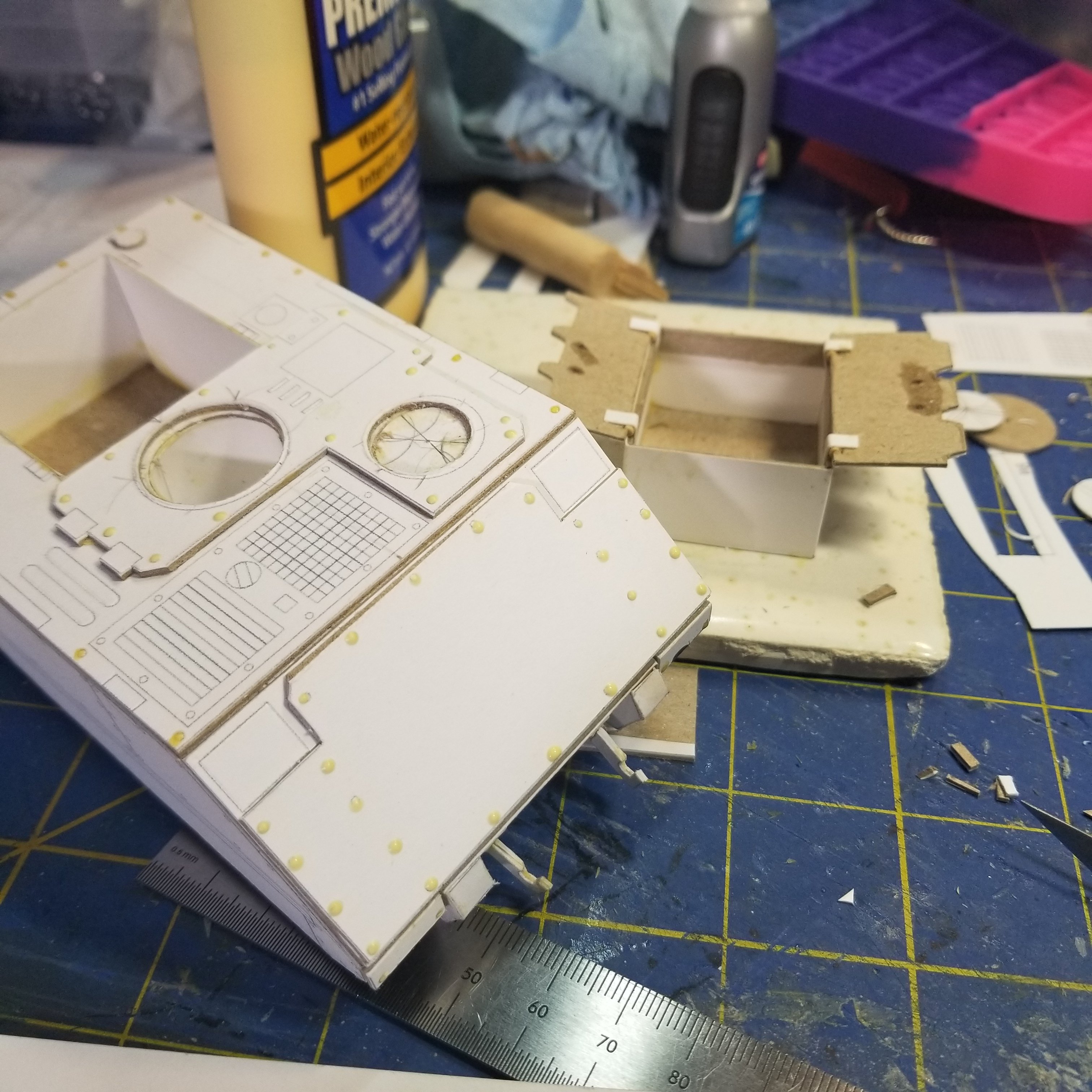

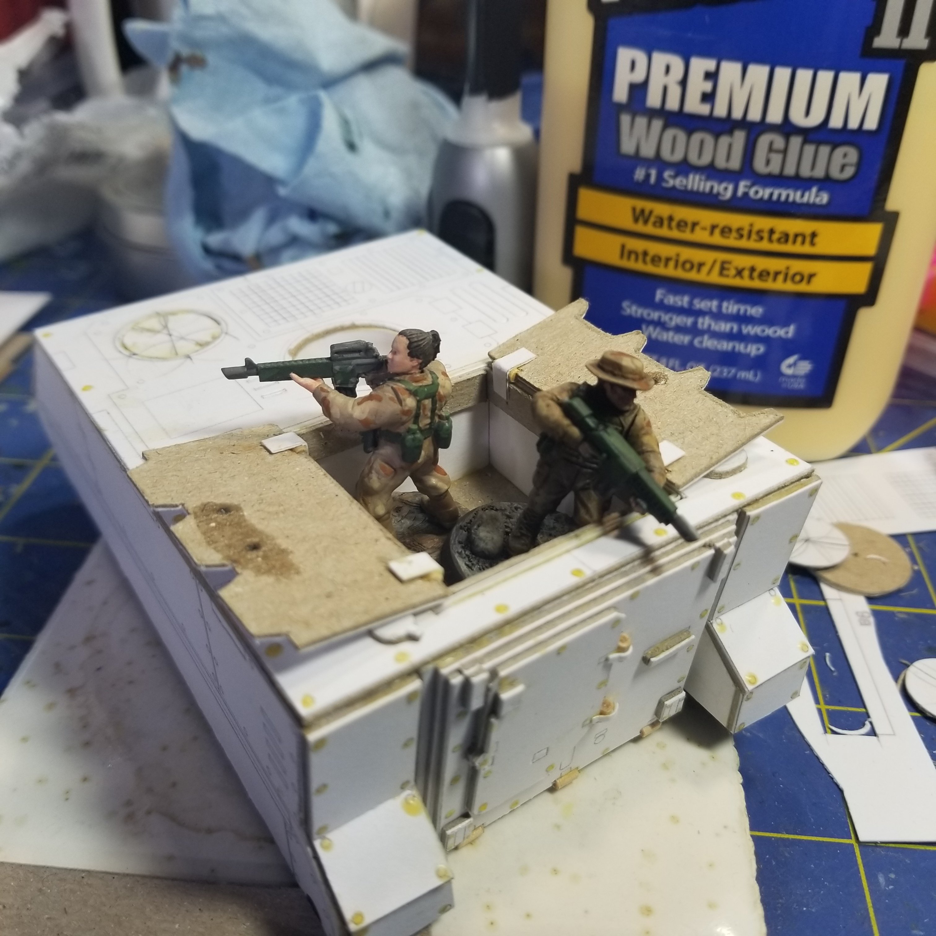

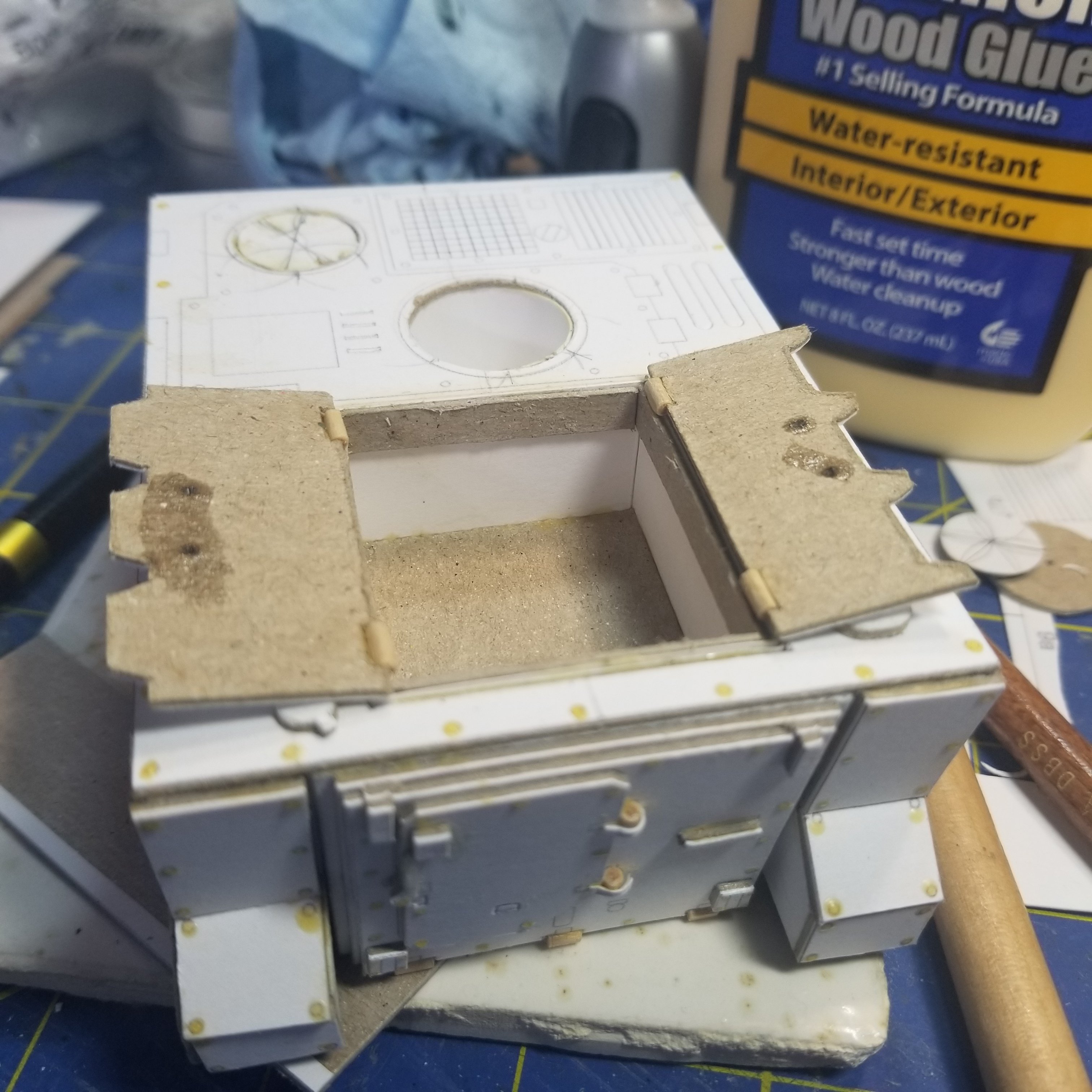

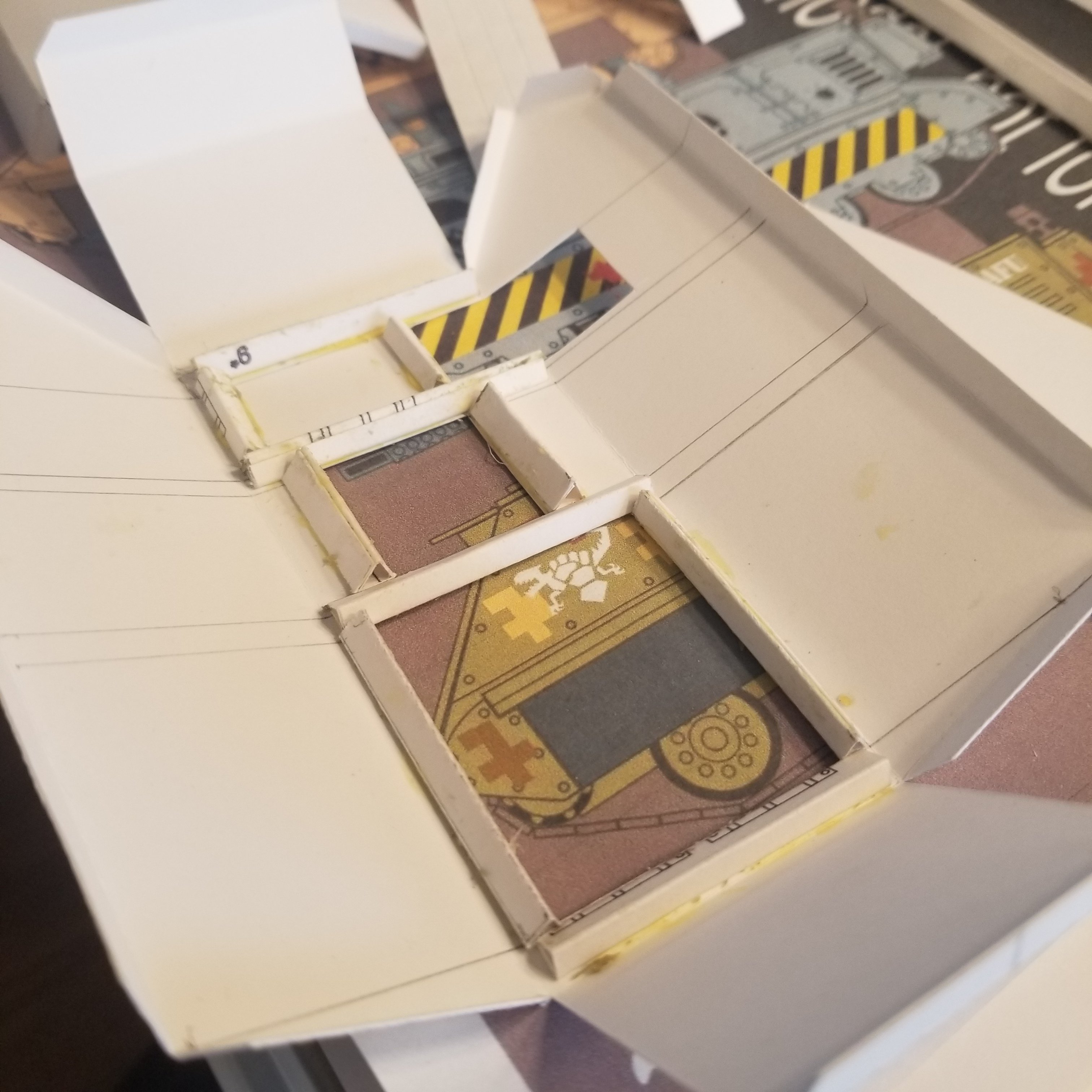

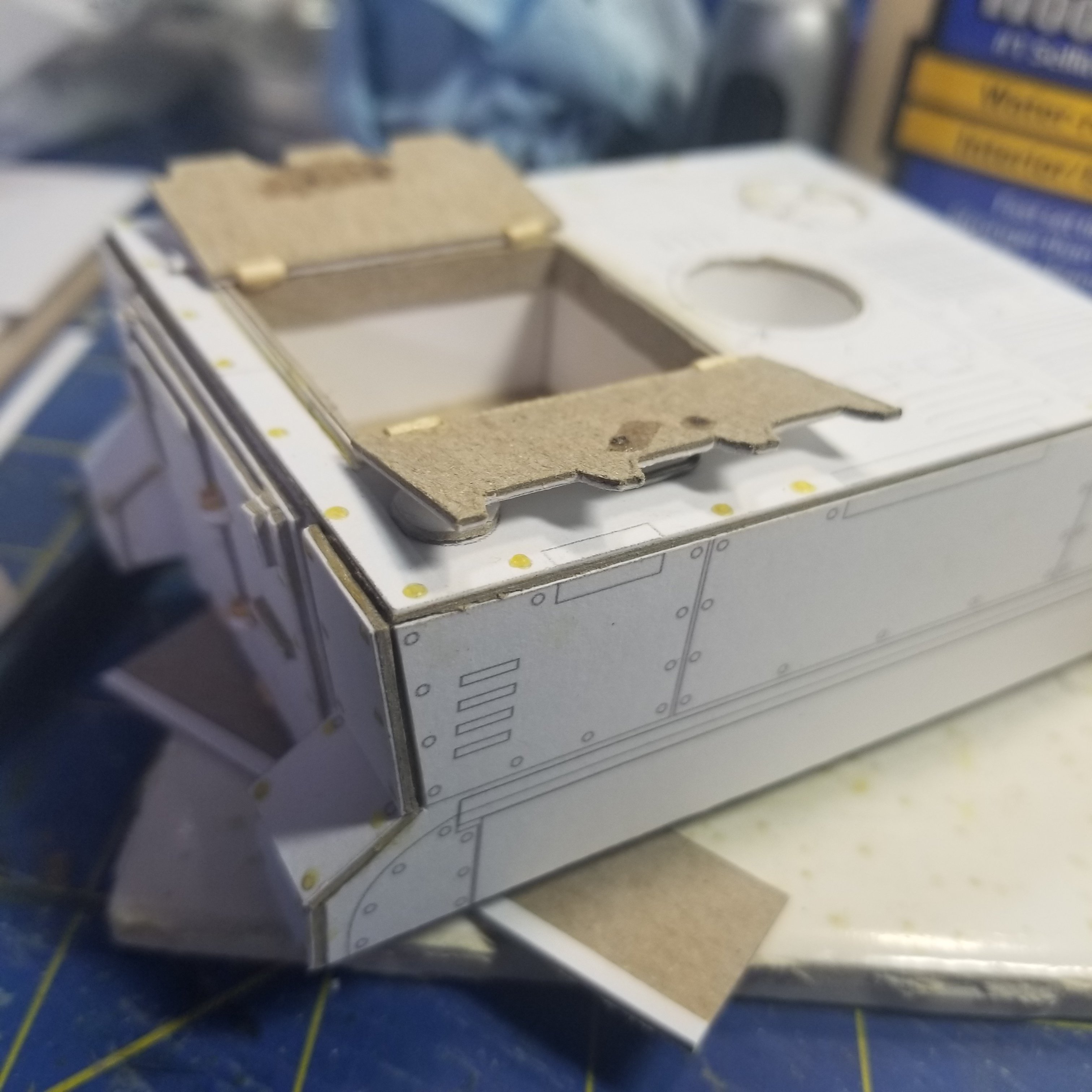

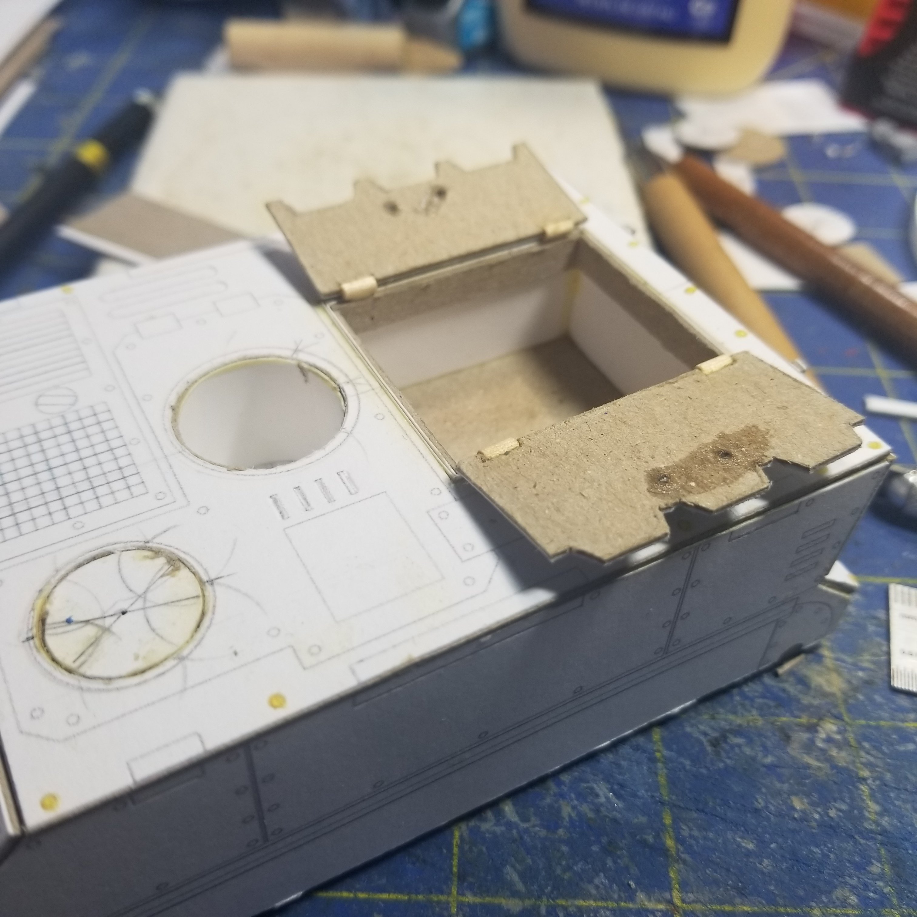

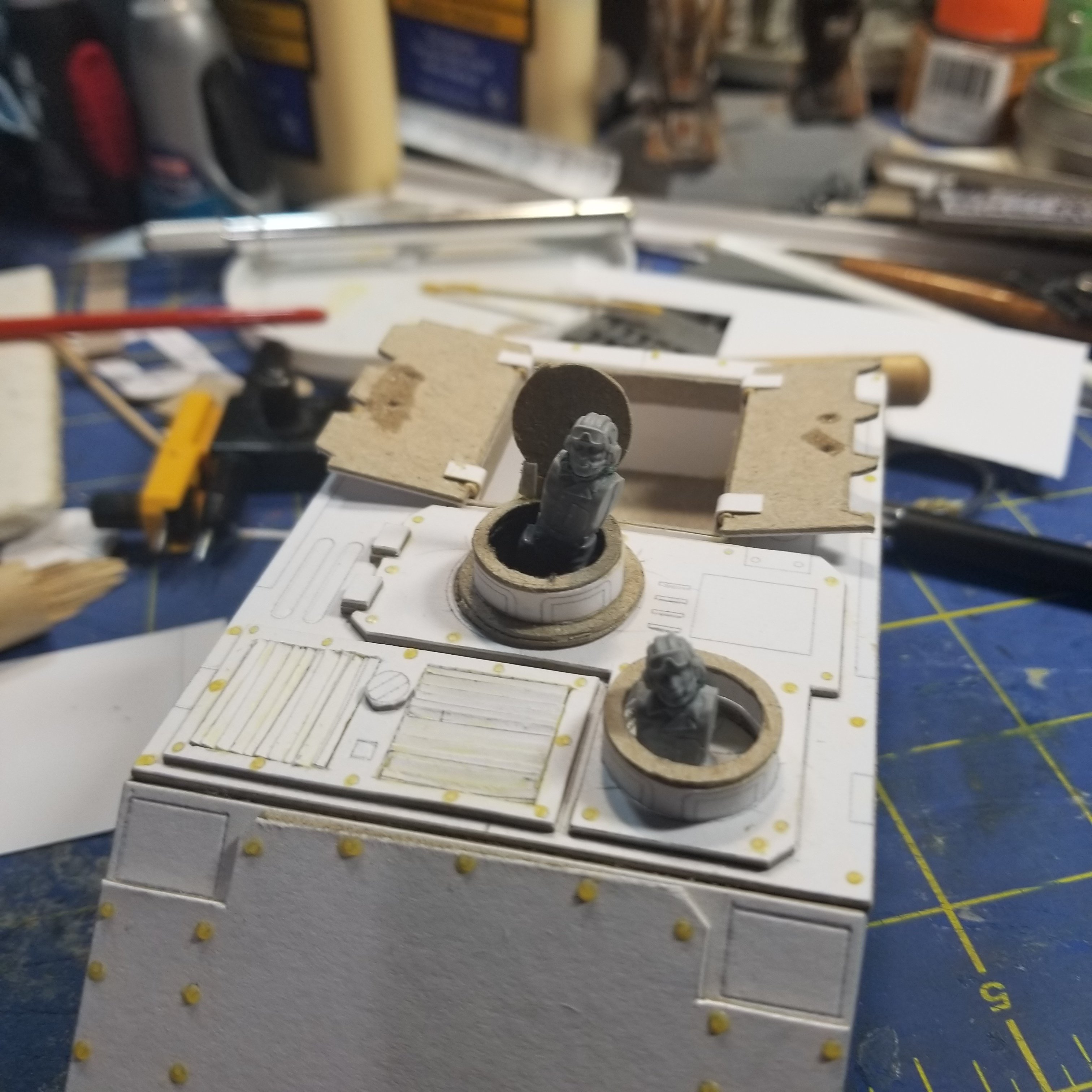

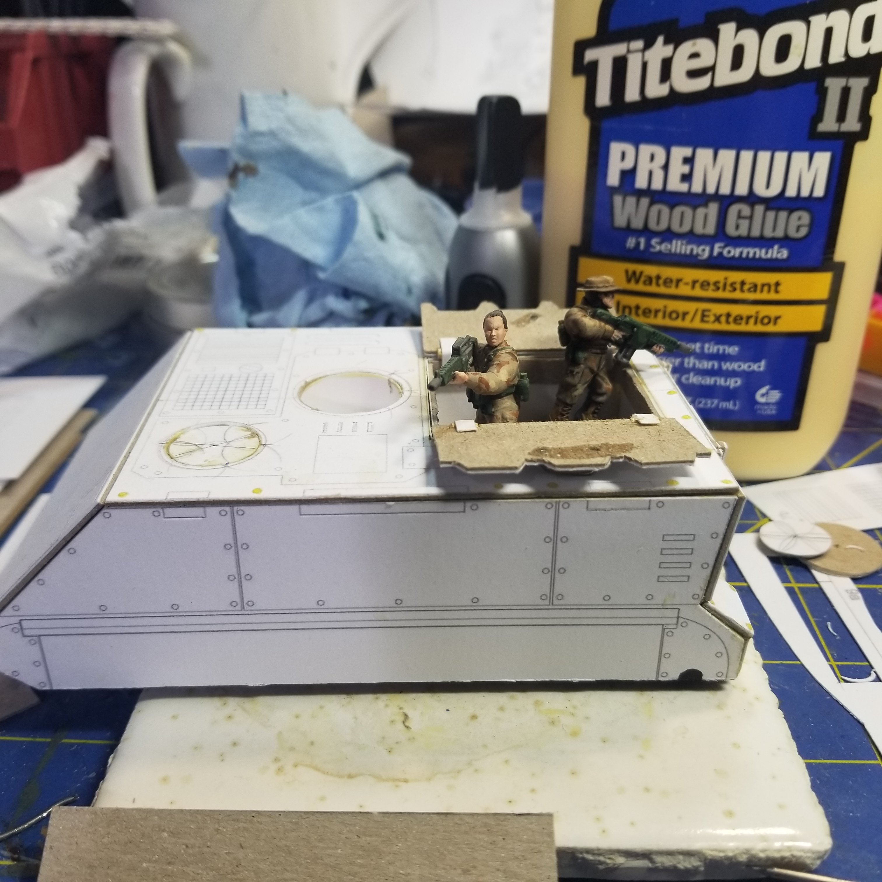

Used my holiday time off before the big feast to knock out the first insert, the troop hatch. It was exceedingly successful so far! Especially with how good it looks with a couple discounts inside.
Started greebles on the top and front. Good stopping point for now.
