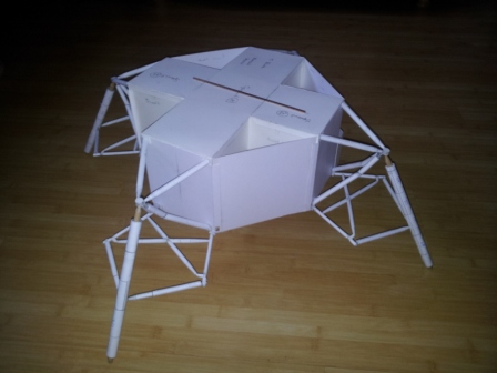

after some small projects in xxs i will starting something in xxl. I don´t know how long it will take to finish this project because it has not the first priority in my life. But I hope that it is possible to get a model who is relevant to the original. The first step was to get the plans and photos of the LM5. After that I made the decision about the materials that I want to use.

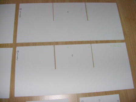

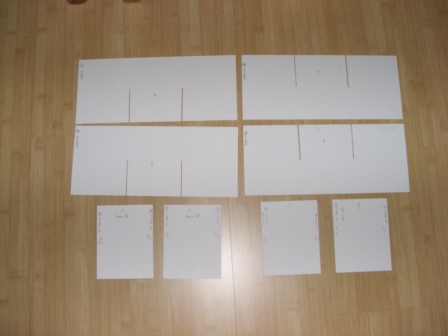

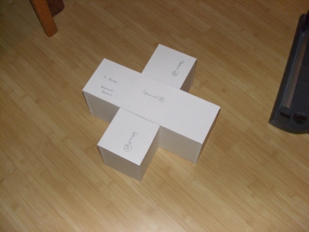

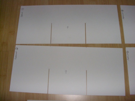

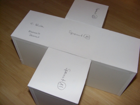

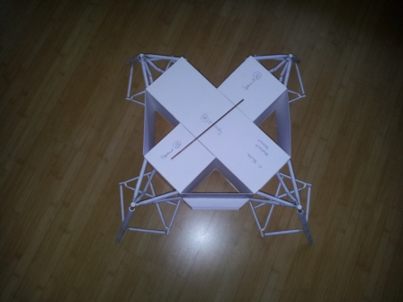

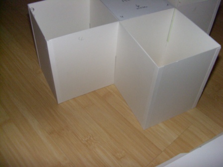

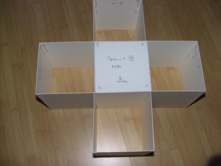

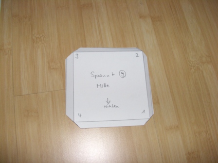

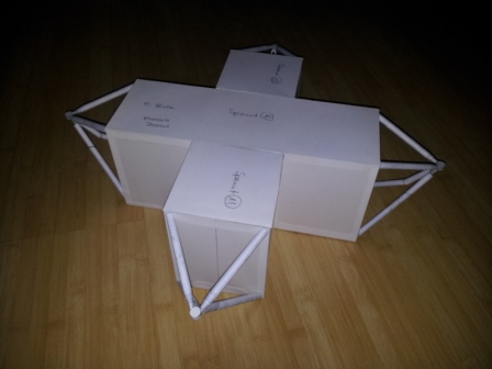

The Cross will made from Bristol with a weight of 300 gr/m².
I don´t build the tanks in the descent stage or any other details from inside.

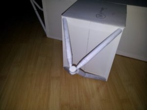

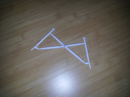

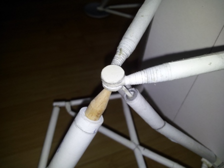

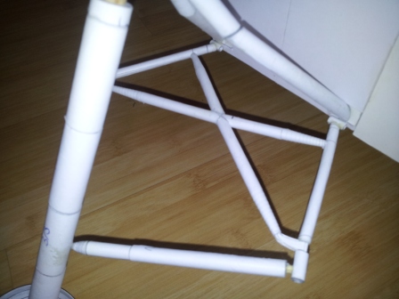

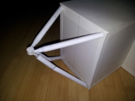

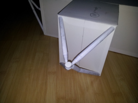

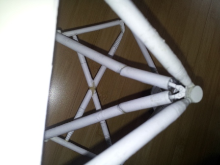

Outrigger truss
The Outrigger truss is made from normal paper with a weight of 80 gr/m². The tubes are wound around a core of 3 mm. After the tubes were dried, the core was removed. For connecting the truss with the mainstructure of the descent stage I use parts of 3mm wood sticks as a bolt. The knot was made ​​of Bristol and superglue.

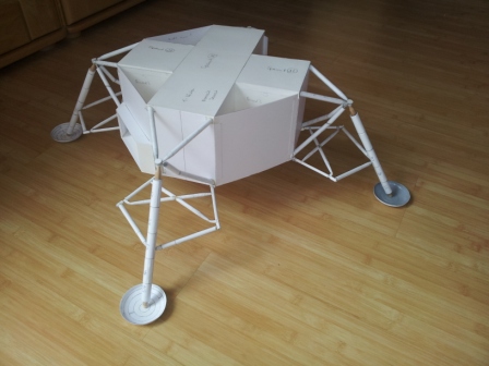

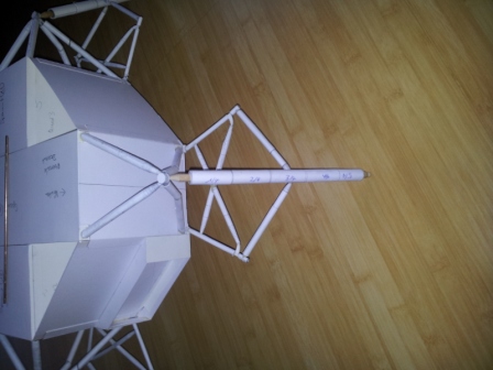

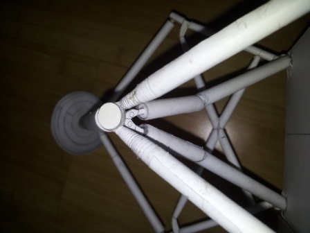

Because the weight of the hole construction I decide me to use 8 mm wood sticks for the core of the main strut.

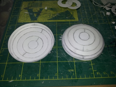

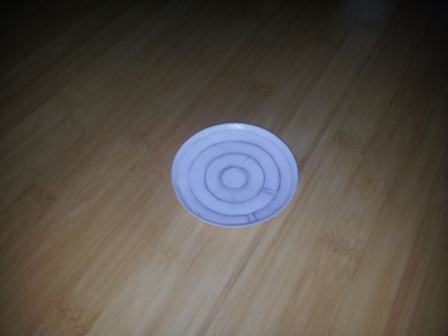

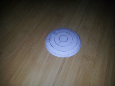

The pads
The next step is the construction of the pads. That will be a little bit tricky but not impossible.

A great start. The landing pad looks great and the strts are excellent. I look forward to seeing this come together. :)

Pads

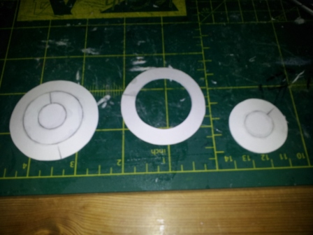

Ok, working on the LM went ahead. I'm going to draw the other parts of the computer. Here are the pictures of the pads. These must be re-drawn on the computer, so that the segments are long enough. They are a bit too short straight, so I had to extend it. I ordered black tissue paper for wrapping the pads. I'm still waiting for the delivery.
Regards
Michael

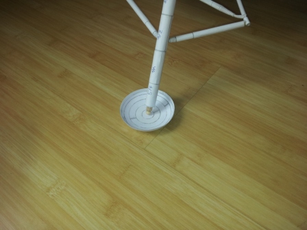

Some more pictures of the Outrigger Strut. I had used a pencil sharpener for the upper end. The other end was built with a wooden ball. Fur the main strut I had used a wooden stick (diameter 8mm). The main strut was covered with tubes made from paper with 80g/m². The inner diameter is 8mm and the outer diameter is 14mm. The main strut case was manufactured in segments, that is easier to handle.
Regards
Michael
