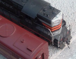

Any large steam---4-6-2, 4-8-4, etc. would do well up to about 10 cars and be within realism. Diesels usually go 6-8 cars each, Amtrak rated their FP40s at 6 cars each I believe. While there are few really outstanding details on steam for passenger service, diesels have more noticable details. E, F and PA/PB (pictured) units toward the rear of the loco, on the last roof hatch have prominent steam generator details for heating passenger cars, freight units would not. Hood units like the GP shown usually have the steam equipment in the nose like the one in black pictured. Keep those on your diesel fleet and you'll have a happy bunch of LPBs on your pike---especially in the winter.
