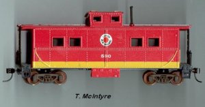

Here is my latest custom car. It is a LNE caboose.
The caboose started as a Mantua Radio Dispatched Caboose. I stripped the lettering off it and painted it red using Polly Scale paints. The paint gave me nothing but troubles. It didn’t cover correctly, the airbrush clogged. Finally after about four tries I got the paint to look good. I then began to decal it as a Western Maryland caboose. Well that turned into a disaster. If it had not been for some reassuring from a few folks I would have given up on custom cars.
Well I then stripped the Polly Scale off with brake fluid. The first time I used brake fluid. I then repainted it and used some leftover decals for a LNE boxcar. The car still looks a little shinny right now. I still need to weather it and hit it with some Dullcoat.
For those who interested here is the list of materials:
Mantua Heavy 36’ Caboose Radio Dispatched (726-174)
Kadee # 38 couplers
P2K Flat Back Metal Wheels
Undercoat: Folk Art Dove Gray (708) thinned 1:1 with blue windshield washer fluid
Sealer: Plaid Clear Acrylic Sealer-Matte (CS200306)
Final Colors: Apple Barrel Kings Gold (20760) thinned 2:1 with blue windshield washer fluid
Apple Barrel Red Apple (20784) thinned 2:1 with blue windshield washer fluid
Sealer: Plaid Clear Acrylic Sealer-Gloss (CS200304)
Decals: Walthers Box Car Lehigh & New England WHT 67-15
Paint: Americana Burnt Sienna mixed with Folk Art Bright Peach (682) 1:3
Trucks
Paint: Folk Art Dark Gray (426)
Drybrush: Americana Burnt Sienna

Tom - now in earnest: Does this washer fluid contain some alcohol? And did you notice a difference in spray paintig compared with water-diluted paint? E.g., does it dry faster?
Ron
Thanks everybody for the comments.
Ron
When I tried distilled water I did not like the results. The paint seemed to not adhere as well and I got a fair number of runs. Also things kind of looked chalky. I don’t use tap water. Our local tap water is very hard and does not mix well. Heck it is so bad that I have to treat the “clean drinkable” water before I add to the fish aquarium otherwise it will kill the fish.:eek: :confused:
As far as the blue windshield washer fluid having alcohol in it, I read somewhere else that it does. Now I will have to check the bottle to be sure. To me paint thinned with it does dry faster and cover better. The use of the blue windshield washer fluid was suggested to be by several forum members when I was struggling with airbrushing. I would have never thought of it on my own.
I've found that if you try to use isopropel (rubbing) alcohol to thin water based paints, many will "shock." Denatured Alcohol is the best thinning agent for water based paints. You can buy it by the gallon at Home Depot, Lowes, etc. in the paint dept.

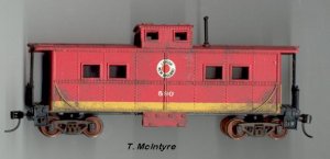

Here is the finished weathered product.
Weathering:
Drybrushing: Folk Art Dark Gray 426
Wash: Folk Art Dark Gray 426 thinned with blue windshield washer fluid 1:5
Sealer: Testors Dullcoat
