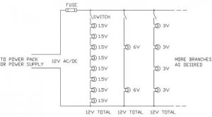

Hi Frank,
You would probably like to get away from the batteries.
You can use a power pack AC output, a DC power supply, or
even a larger 6v or 12 battery if desired.
This dwg shows strings of series-connected bulbs. The strings are then
connected in parallel. The bulb voltage ratings, or voltage drops, in each string
must add up to the power supply voltage. The bulbs in each string must
be the same rating, but you can use a different type of bulb in a
different string. Each string can have its own separate ON/OFF switch.
You can have fewer or more branches up to the current capacity or VA rating of the power supply.
If using a larger battery or larger DC power supply, the thing to watch out for
is the size of the bus or supply wires (too small wire will overheat) and ensuring
some kind of short circuit protection, like a fuse in the main wire to the
supply.
This way you can have a single source for your lighting power. You can
also use LED's in the circuit if you want.

The big drawback to that is that you will need a series resistor for each lamp that requires less than the power source voltage. That's going to eat up a lot of power, especially those 1.5 volt ones.
The diagram that Cid has there is worth considering, he's got all the same voltage lamps in the same leg of the circuit. Just be sure that each lamp in the individual legs are the same type, or are rated for the same voltage and current draw. Just as an example, if you had four 3 volt lamps in series, and one was rated at 100 mA and the other three at 50 mA, the 100 mA one would probably burn dimmer and the other three brighter than the bulbs are designed for. I could calculate the current, but suffice to say, brighter than designed for is not better, as I pointed out in an earlier post.
