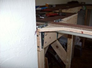

HI everone:wave: . This is my temporary lift bridge. It worked fine until I put the track on the bridge. Now the tracks hit and I can not lift the bridge. It looks like I would have to put a 1/4 to 1/2" gap in the track to get it to lift. Any ideas on what I can do to get the track to clear?

You don't need to do a lot of "rebuilding." Basically the hinge just has to be above the top of the rails. I think raising the screws in the long side of the hinge and putting a shim made of 3/8-1/2 inch plywood under each of the smaller hinge plates will fix it.

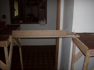

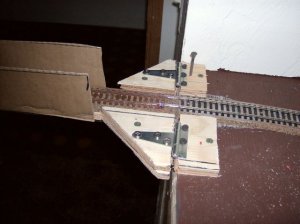

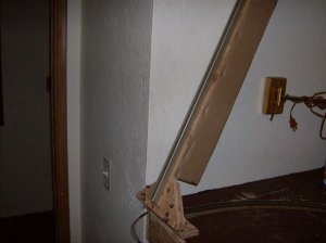

This is the change I made that LoudMusic found(sorry Russ,I was done before I saw your reply).
The screw sticking up is a stop to keep the bridge from going all the way over.
Loren

Looks good. How's the alignment on the receiving end?

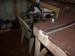

It is all made out of stuff I had laying around. The channell underneath is a old curtain rod. I used it because the plywood was warped.

I thought about what Russ wrote, I am going to try using a strap hinge raised up on the table edge and screwed to the bridge from underneath. I'll let you know hoe it turns out.

I used a "pin" pivot just below the table level but back a few inches from the opening. This allows the track to overlap the connection and meet on a single surface, Since the angle of the track motion on the left side is only about 7 degrees from vertical you can cut it at a very slight angle if you want but a few thousands gap is all you need for clearance. I bend the track extensions down just slightly. When the lift closes and the tracks contack the cork they bend up flat for a perfect fit. Final version will most likely have some material other than cork where they join and may have some small tie alignment bumps on either side of the track extension landings.
I plan on re-working it later for looks but will stay with this design because even without alignment pins I have not had a songle problem and nothing extends above the surface.
I think I will add some sort of micro switch & relay safety cutout to disconnect the power for a few inches before the opening on both sides to stop trains when it is up. With this design they can fall off the table from both sides.

BigJim's solution looks interesting. Thanks for posting the pics.
Do you have any concerns about the messing up the track where it extends past the bridge?
You mentioned that you might use something other than cork on the stationary side where the track extensions touch. What if you just took off the cork and glued some roadbed made out of wood to the track extensions and let this rest on the stationary part?
Big Jim, that is a great idea. I think if you put boards on the side extending out past the opening, that should hold the alingment and still be below the table. Using switches to cut the power is another great idea. I really like that idea better than what I have know, but I would have to rebuild my table in that area, and I am far enough along that would be a major overhaul:cry: .
