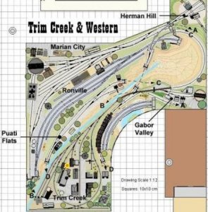

Hi Iron Goat,
it depends somewhat how much you want to spend on software.
I recommend 3rdPlanIt. IMHO it is by far the most sophisticated track planning software around, and it is well worth the prize of around $100.
For this price you get lots of CAD tools for laying tracks (with any form of easement), helixes, turnout ladders etc etc. There are two different ways to construct the landscape, complete with ground texture. You can construct the whole benchwork - and all this you can visualize in 3d views from every angle. You can even ride the rails yourself (the 'camera' also moves along the track if you want), or you can run trains on the layout and test switching moves before laying one single piece of track.
If you want to see what you can do with 3rdPlanIt have a look at my website - e.g. starting on this page. I'll take you for a ride on my future layout...
To give you an idea I include the plan overview of my TC&W RR, although the picture is not so sharp (due to the necessary size reduction).
Ron
