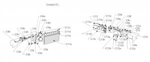

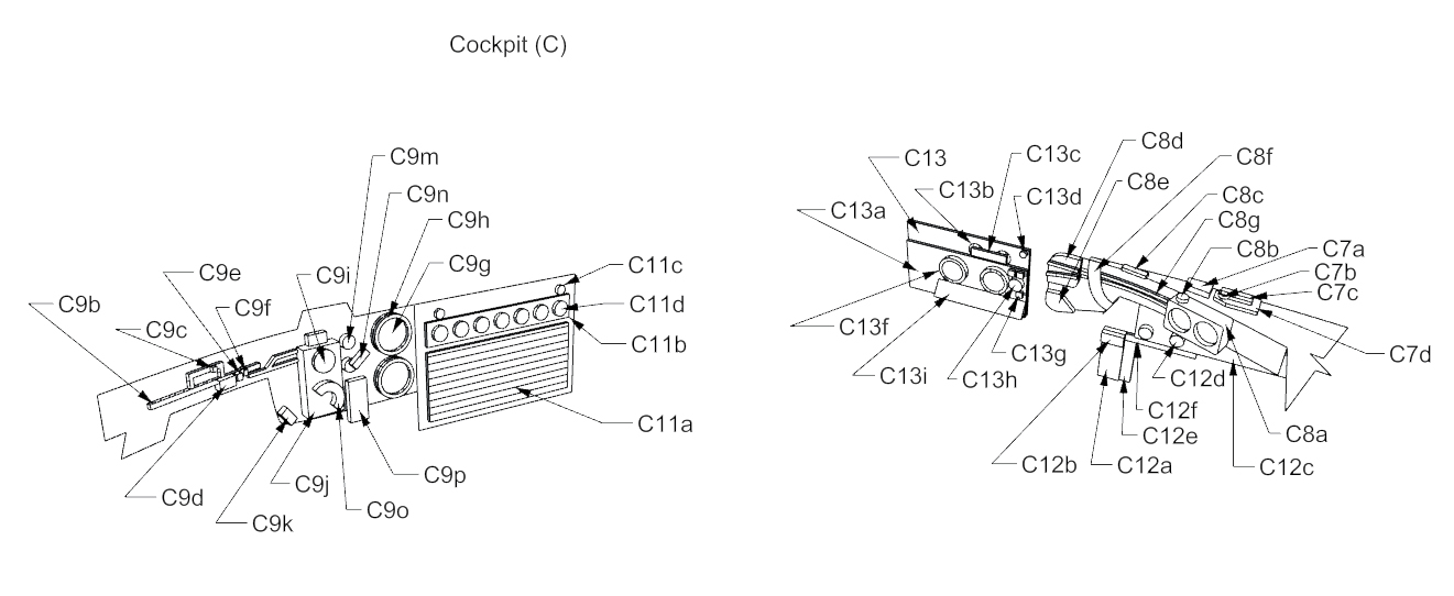

I am numbering each subassembly by its name first letter and number. For example for engine it is part E1, E2 etc. if there is some smaller sub asembly at the engine subassembly then it is numbered by letters E3a, E3b etc. Sometimes I add L,R, B or T for right, left, bottom or top side (or combination) like E3b LT. This way I have no long number lines, so I do not have to renumber to many parts when needed.
Image speaks for thousand words:).
Sorry for discrepancy - instruction drawing it is NOT from this Viper model by Revell-fan (it is from my A-wing model). I post it to illustrate my way of numbering parts.
All theese parts are optional. Modeler could pick what parts to incorporate to his model and what parts to omit for whatever reason.

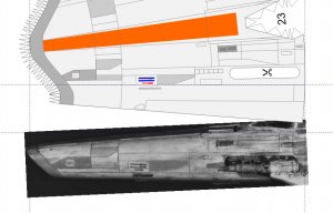

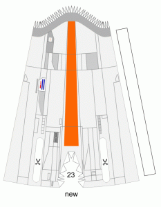

Alright folks, the revision is complete! Here are a few things that were changed: Maintenance hatches on the side engines moved up, detail on the high engine thruster moved down, added panel lines to the intakes to make decals for a Viper variant, added greeblies to the wings and undercarriage, extensive rework of the lines on the nose. To correct them I printed out the part and assembled it. Then I held it against the monitor and made additions with a marker directly on the part. Then I mesaured the difference to the old lines and updated the vector drawing accordingly. I could have cut the part apart again and scanned it for tracing but it was pretty tricky to draw the lines on such a small curved surface (no pun intended! ;) ). Then I thought about importing a part of the side view of the filming miniature and cross-check everything. One drawback is the perspective distortion of these images. That's what almost drove me mad when I desiged the Landram. ;)
In the end everything lined up very well. Here is a comparison between old and new:
