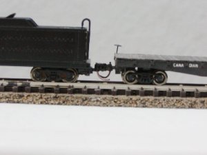

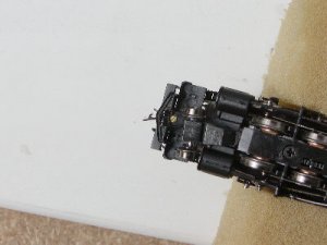

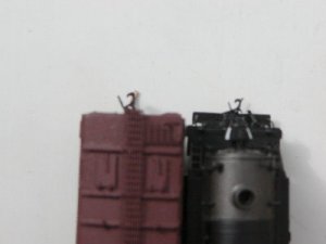

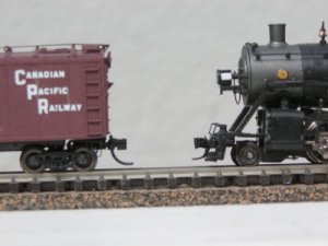

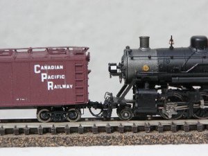

I have converted 2 of my 2-8-0's pilots by removing the non-working coupler from the pilot by pulling it sideways allowing one of the 2 hooks to disengage then pulling it straight out.
I then use a small flat needle file to slowly ream out the coupler hole in order to take a Microtrains assembled 905 Z Gauge coupler.
Have a Microtrains coupler height gauge handy to ensure that the coupler is at the right height and, once the coupler fits snugley into the hole I drill through the pilot platform, tap the hole and screw the coupler in place, trimming that part of the screw that sticks out ot the platform top with a pair of nippers.
I find that the Z Gauge couplers work well with N couplers provided that they are the right height.

Thanks for the photos. I am convinced. Tried 3 different hobby stores but none carry the Z couplers or anything else in Z scale. Now that I have seen what they look like after the conversion, I will place order for Z scale MT#905 couplers.
