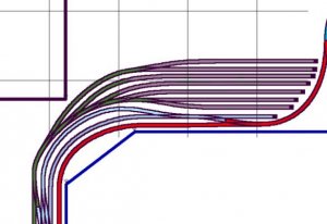

This is one solution I came across to help out in yards.
All of the switches, with the exception of the mainline in red and the A/D in darker blue are #4 Atlas Customline switches.
Having some problems uploading the image.

Is there a link here? Otherwise, I'm not sure what you mean with the colors. Also, I'm not sure with the meaning of A/D. Ooops! Spoke too soon. The plans are there now!
Thanks!
Ha Scott, welcome to The Gauge. A/D stands for arival and departure. Usually the A/D track is between the main and the yard ladder.
I have two #4 atlas turnouts as crossovers and into a yard with the only derail problems I've had is with hoppers that aren't up to weight.
