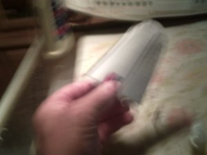

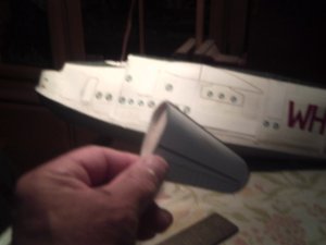

Installation of the forward plane on this step i had to trim down the forward plane to fit when well formed i airbrushed light gray

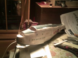

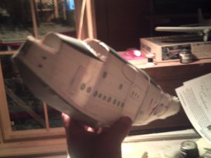

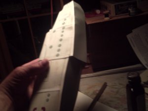

Starting to detail a little bit on the fuselodge assembly I will glue on few more panels and set asside to dry for the night, much more tommorow a couple more attachments here.

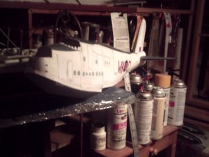

This is the last for tonight I,ll have more shots to come hard part is over the fuselodge is done Next step is to weather and touchup with the airbrush. I incorporated panels to give it the three dementional effect and bring out the detail.

Another shot this is it this old man is getting tired I put in 16 hours on it today, this kit is definately not for the novice ,

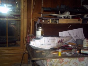

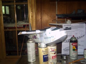

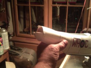

Ok fellas at it again the fuselodge is done i have all paneling done as well next step after the tail assebly is done is to touch up with the airbrush. Useing antique white and light gray. as the next attachments you can see the assembly of the the tail feathers they all have an enternal spar along with the ribs to maintain airfoil. Should have these assemblies done tonite. here are the attachments.

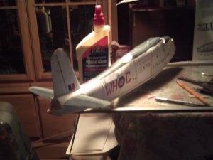

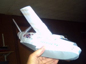

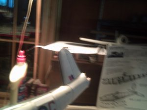

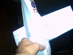

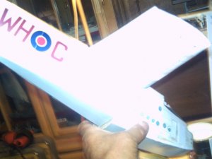

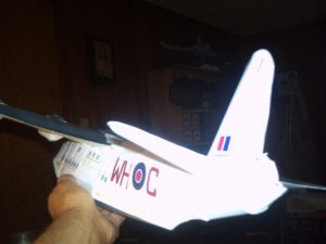

Here i have all the tail feathers in place next step is to touch up with the airbrush, before hand make any adjustments if necesary.

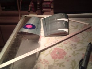

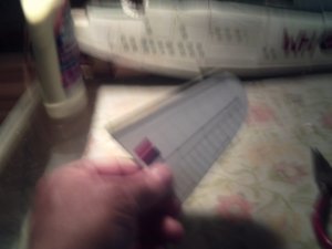

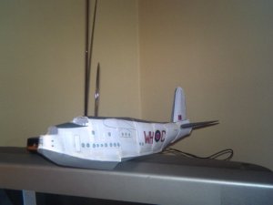

Ok fellas I think I had the lick for today I,m starting to sewe Shoret sunderlands in my sleep been at it most of the day Things are starting to slow down, I am starting on the wings there again a fit problem with the outer wing panel. The bottom tip is a tad smaller then the top wing tip souloution is to trim the top wing tip to the bottom sand well . touch up ends with glue and paint or use color felt pins. as you can see in this photo the iner and outer wing panels have their ribs installed, the wing spar is ready I will install same tommorow.
Also a couple more fuselodge shots to as you can see my ship models all over the place. here are the attachments.

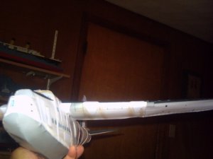

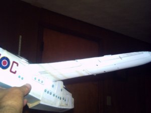

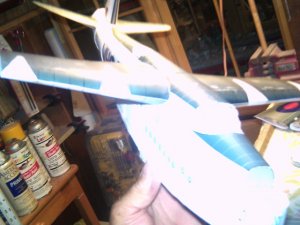

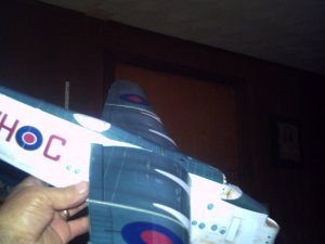

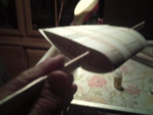

Back at it again, Here I have the Starboard inner wing panel in place prepareing to install the outer starboard wing panel. here are a couple attachments on the installation she is starting to look like the Sunderland flying boat. as far as I can tell the hard part of the kit is over with a little trimming here and there is the soloution to this kit.

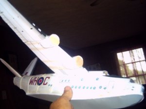

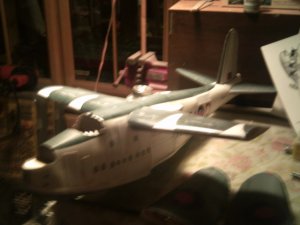

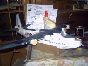

Here are a few more attachments of my sunderland I got wings all assembled let dry for the night finished up the touch up with the airbrush you wont find no seams on this kit. picking her a few time after i installed the wing she wants to fly a breeze blew in my shop the wind picked up underneath her wing and she wanted to fly. Handeling her reminds me of the old vacuform kits i use to build feels just like them I have loads of work ahead of me thing will be slowing down i have the hardest plart of the kit fuselodge and wings I logged in 17 hours today on this bird and I am bushed. Tomorrow i will take the day off and go sailing with my tugboat so here are the attachments.

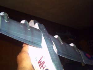

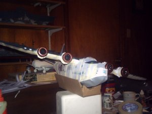

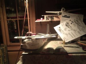

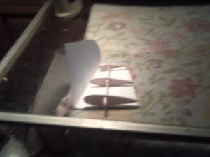

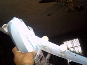

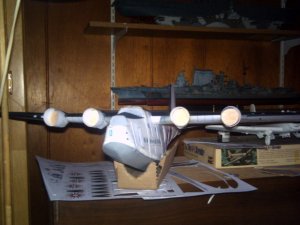

Back at it again I to windy and rainy out here in Ohio land No sailoing my tug today, What a better thing to do is to work on my Sunderland flyingboat. so far she is comeing along quite swiftly, i been working on the engine Necells all today have them all formed with balsa and skinned as you can see in the attached photos, thew engines are going to take some time but the small parts i can relax and do it justice here is the progress I made snince yeaster day and last nighht.
Howdy fellas

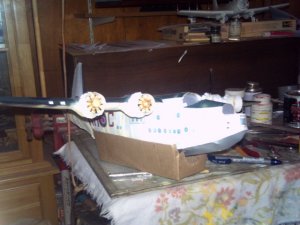

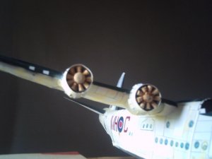

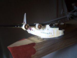

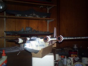

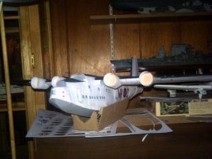

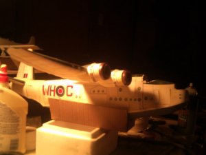

Thanks Sir for your reply to my Sunderland the attached photos here are the installation of the engines I turned 72 engine cylinders and I installed two rngine units, I also made cowling flaps and more touch up with the Airbrush I will get started on the Mars tonight. I should have her all painted out I will submit some attachments of her tonight. Here are some attachments you will all notice what is that big ship it is sitting on this is a 5 ft . models I am building of the Matson Liner Luriline that will be another build but I got to get these Flyingboats done.

Looks good! Yuo say you turned the cylinders - assumed wood then on a lathe? :)
Thanks
Chris
Chris
Thanks yes no sense on useing brass wood dowel work just as good I have them all the same size I should have the cowl front rings donee today this will face off the engine fronts Sunderland is comeing along quite well still needs a little touch up here and there. Amazeingly strong with all that dope I airbrushed on.

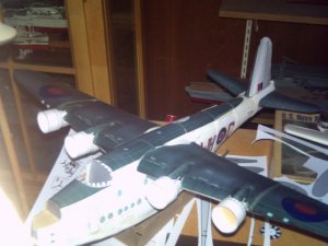

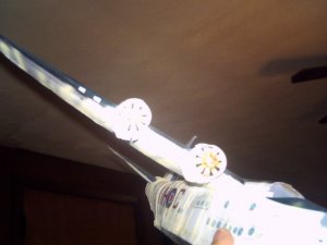

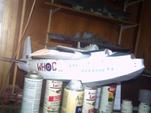

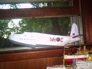

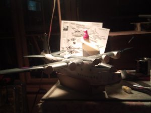

Back at again the Sunderland is almost done I have a little more work to do, took time off from it to finish up on my PB2M MARS. All 4 engine assemblies have been installed and painted, I have all 4 engine cowl front installed too.
Next phase will be the floats and props and install the cockpit turrets rigging and she is good to go. I made the beaching gear painted them Red. made them from wood and veneered them with card stock, the tires are rubber O rings Old Porkiepine will done by tommorow evening I should have built her longer than I should but I was haveing fun like a child with a new toy.
The very last procedure will be the weathering with the airbrush, Here below are up dated attachments
