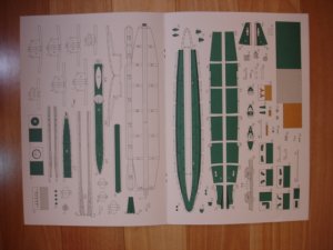

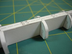

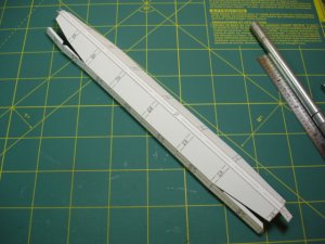

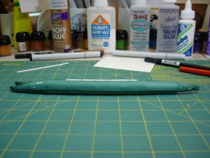

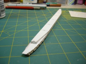

I've built enough free kits that I've decided to build something I actually bought. I'm not up for that big Shokaku yet, so a little 1:250 JSC WWI U-boat will do.

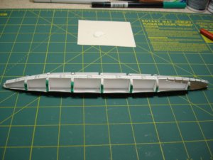

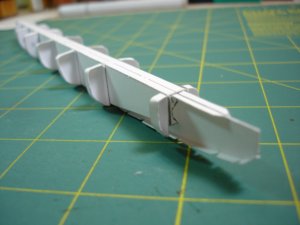

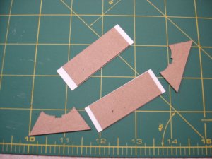

The kit is two pages with English instructions included and is hand drawn. The framework is different than normal as there is no laminating, the parts are made into little boxes for strength.
The hull is green and I'm wondering if anyone knows if these submarines actually were green?

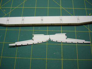

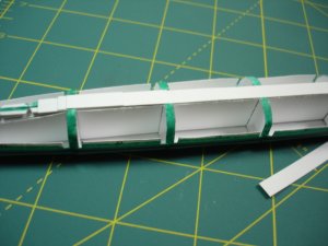

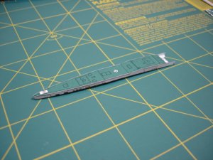

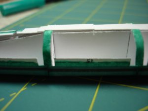

The side frames seem to be a bit oversized, but I'm not sure if the hull plates are sized for them or the keel. I glued them on flush with the top and figure I can do some surgery if the bottom plates wind up being too small.
The deck and top sides are all one piece and seem fit fine. I'll know more in the next step when I put on the bottom hull parts.

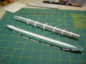

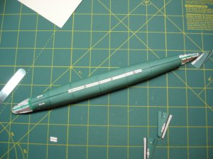

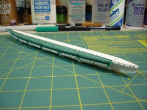

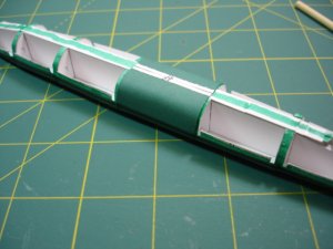

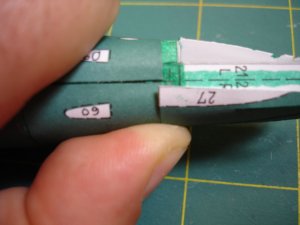

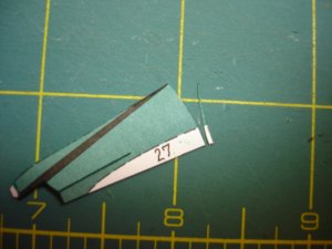

Here is some more progress on the U-Boat. It turned out that the hull plates were sized to the side frames, so I added cardboard to the keel to give me something to glue the plates to.
I also made a mistake and realized it when I was about have done plating. The tabs on the top plating look like they should be cut off and then glued back on aligned with the dotted line so you get a nice flush fit. Oh well, I guess it's not that noticable :oops:

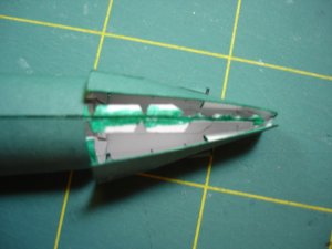

There are some fit problems and a number of the hull plates had to be trimmed in order to fit and then others were slightly too small. As can be seen in the photos, the stern was the worst. The bow needed the frame cut back a bit as well.
Now it's time for the superstructure...

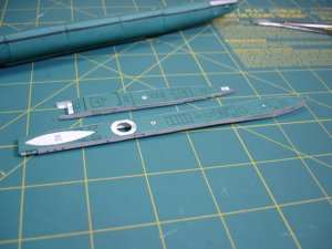

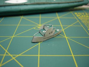

The deck is made in two sections and then glued to the hull with the conning tower on top of that.

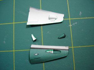

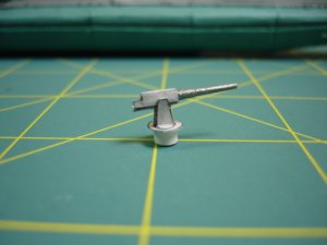

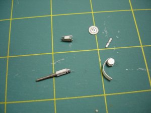

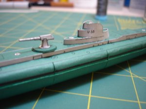

I made the gun by turning a toothpick against a file and sandpaper in my foredom tool. It's kind of neat, it actually elevates by means of a paper hinge. Then it just presses into place in a hole in the deck so it can rotate.
Now, it looks like I need to make some railings. The instructions don't show any around the gun and the only photo I can find is kind of fuzzy on that so I'll have to guess a bit as to how they should look.

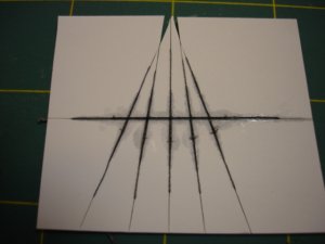

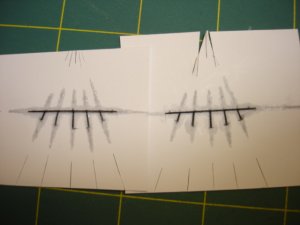

I took a break from modeling for a while for stuff around the house and a vacation. Now that I'm rested up, I've had a chance to get back to work.

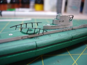

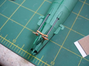

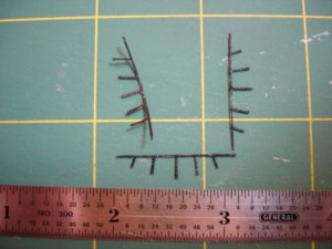

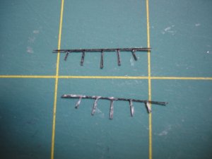

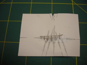

I started the railings and looked for a picture on Wikipedia of the U-35 to guide me. It showed extra railings around the gun, so I made those as well as the conning tower one.

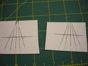

The railing in the kit is printed and I wanted something smaller than that, so I used silk thread. I made a template based on the kit part and wound the thread through notches I cut. Then I covered the thread with super glue. I used a really sharp blade to cut along the edges and then seperate it from the cardboard. Finally, I used a marker to color them.

Glueing them on was more difficult than making them. Because I had to bend them to fit I could only glue one stanchion at a time. I used gell CA, but it still detached a few times before it all held.
Now I've got the doubled parts drying and hope I can finish this week.

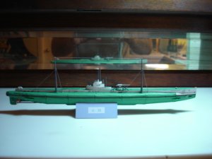

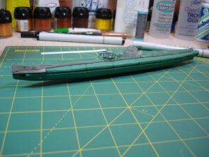

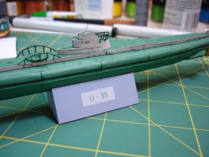

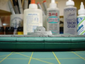

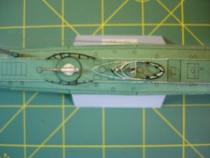

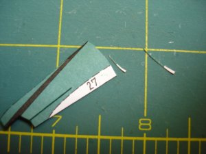

It's finally finished. I'm going back to a computer drawn kit next. A lot of parts didn't fit and even the templates for the periscopes don't match up to the side view drawing.

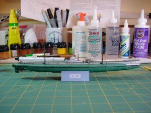

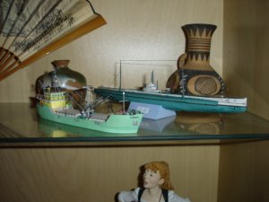

But, now I have a submarine! Overall, it looks pretty cool and my freighter has some company in port now. I made a little stand for it with photo shop and did a very simple rigging job. Every picture and model I found contradicted each other on the rigging so I left it pretty basic.
Here are the rest of the pictures...
