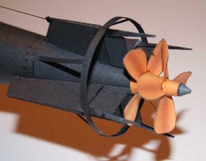

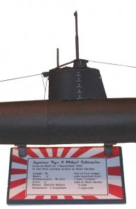

I followed the designer's construction sequence, starting with the bow and working aft to the stern, then adding the sail, the propellers and fins, and the torpedo guards. Finally, I built a stand with a simple paper cradle. The finished model is light and I probably over-engineered the stand.

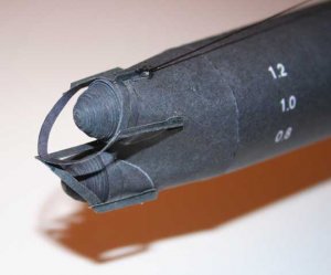

As you assemble the hull sections, be carefull to keep track of which is which. The boat is not symmetrical from bow to aft.
In 1/33 scale, the sub is 29 inches long. That made working on the bow and stern a bit awkward after the hull was assembled. If I were doing it again, I would assemble the bow section,(parts A3, C1, D2) and the stern section (D1, D3, C3, C4). I would detail the bow and stern (torpedo guards, fins, propellers), and then join the bow and stern sections to the center section (C2).
The sail is built as a separate assembly then attached to the center section. Be sure that the bottom former (A39) is clear of the vents/scuppers. I added a flap of black construction paper to the underside of A39, as a view block behind the scuppers/vents--probably not necessary in 1/48. Everything on the sail went together well except part A56. I hand-drew a replacement that was a little less delicate. I folded part A42 (the snorkel?) over a piece of fine piano wire and made a pinhole in the top of the sail to attach it. I rolled the periscope around a heavier (about 1/32) piece of piano wire and painted it with Testor's Model Master "Gunship Grey." I drilled a hole in the top of the sail and glued the periscope in place.
The last step was attaching the UHF antennas. I used dark brown thread from my wife's sewing kit and secured it with superglue.
The model scales out well and looks impressive. It was an enjoyable weekend project. Some of the parts were very small even in 1/33 scale. To build this in 1/48 would require smaller fingers and stronger reading glasses than I have but it should still be a fairly easy project.
