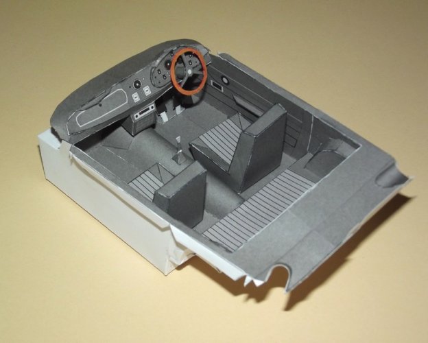

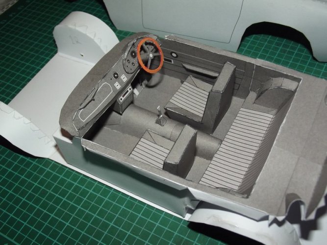

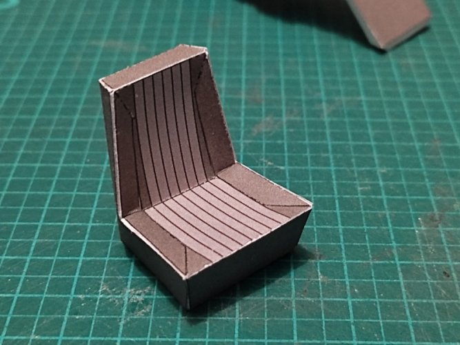

I still owe you a picture of the finished seat. Well, here it is. Assembly was straight-forward.
The edges were then painted with a marker.

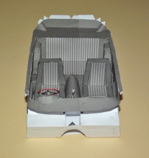

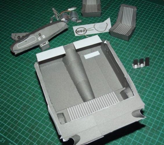

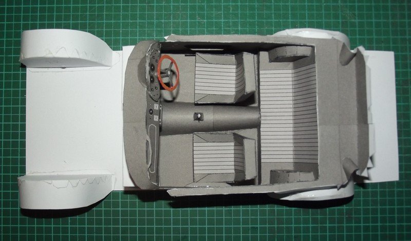

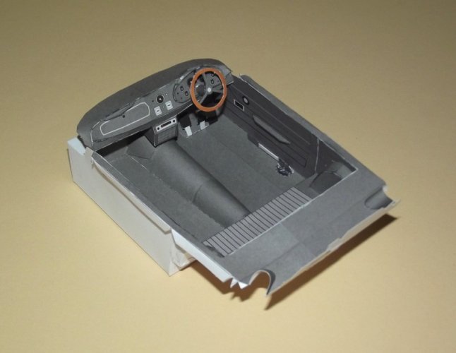

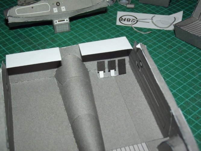

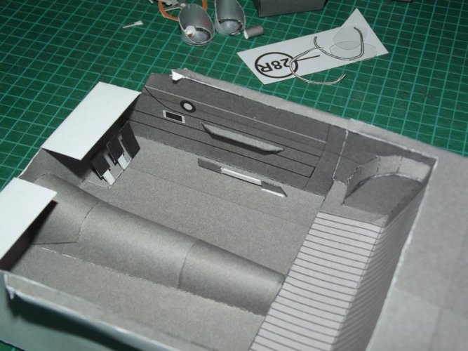

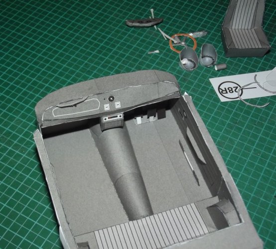

First test-fit of the main interior components:
The lack of position marks makes the assembly extremely difficult. This is why I put everything aside and waited till the outer hull was finished. The side windows determine the position the seats have to be glued to the interior tub. I chose to glue the instrument panel into the middle of the empty space of the dasshboard. I don't like flying blind and this is what can really suck the fun out of the build. Ah well. I have started it, I have to finish it. :)

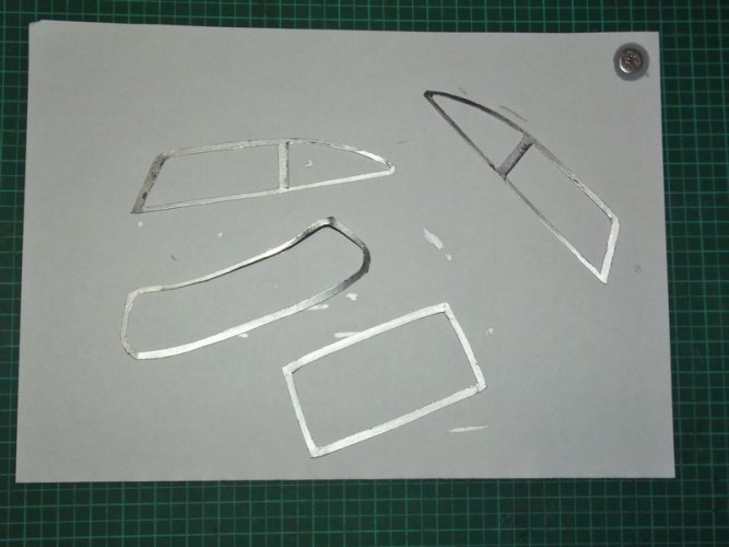

The window frames were painted silver and attached with double-sided tape.

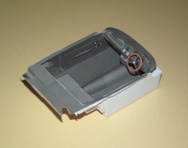

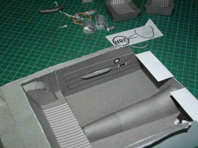

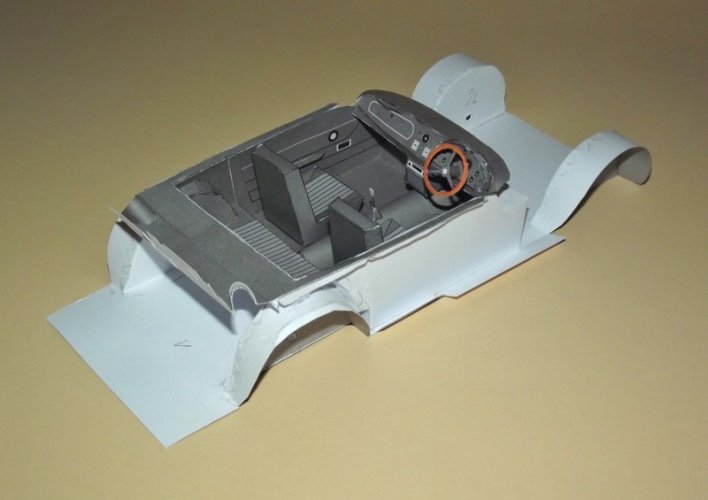

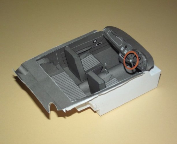

With the basic hull completed the interior parts are attached.
The only parts which have glue marks are the pedals and the indoor handles.

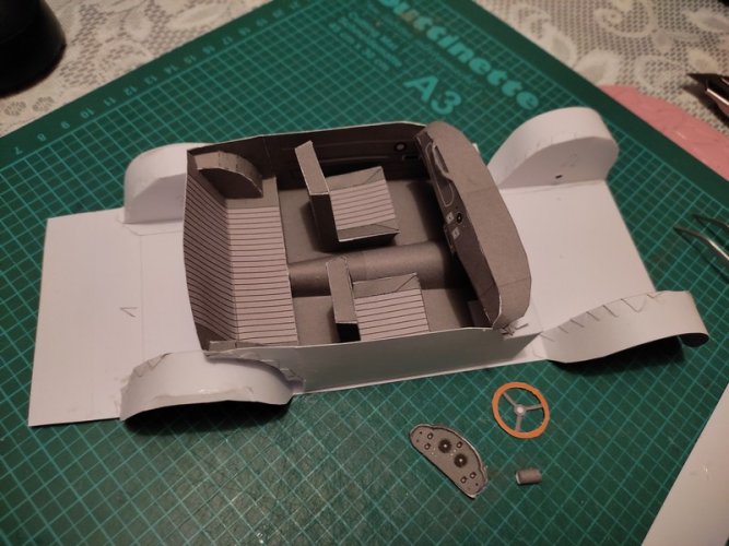

The position of the handbrake is to be determined. And of course I glued it to far away from the door so that the seat did not fit any more. So I ripped the handbrake off and glued it almost directly to the door.

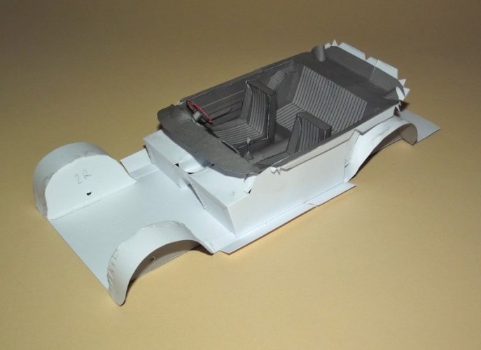

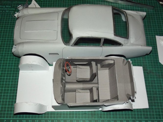

I put the hull beside the inner tub to see where the seats have to be attached.

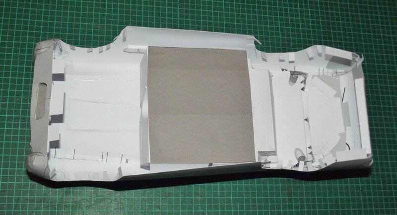

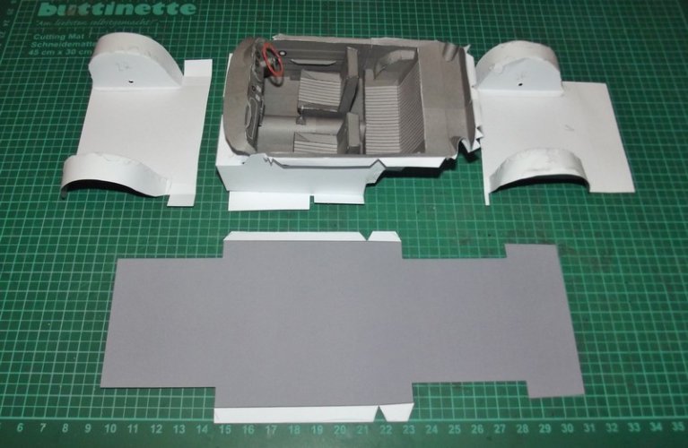

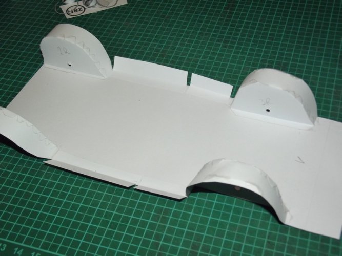

I added some flaps to the middle. More will be added to the rim of the entire bottom piece.
The tub was glued to the bottom.

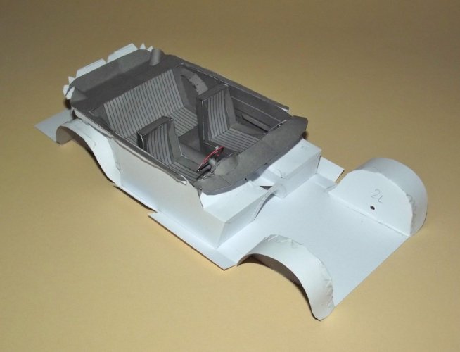

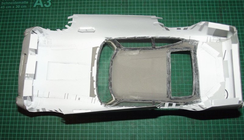

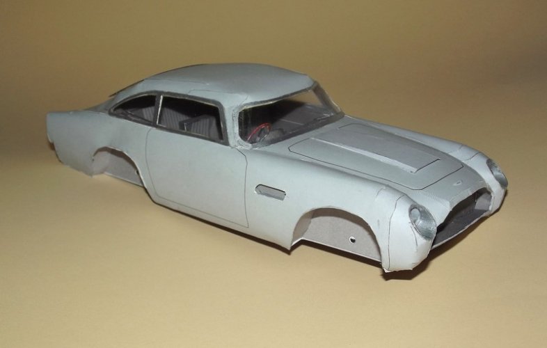

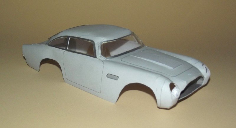

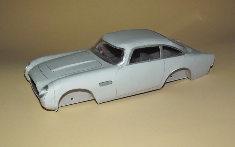

Time has come to join the two halves of the body.

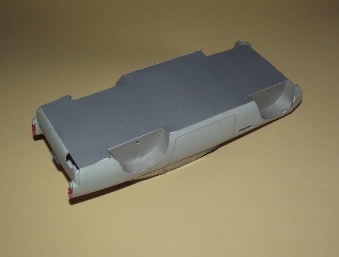

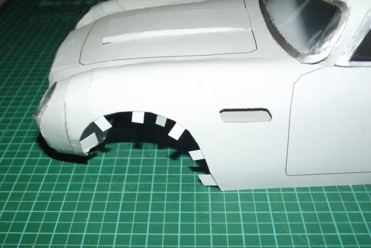

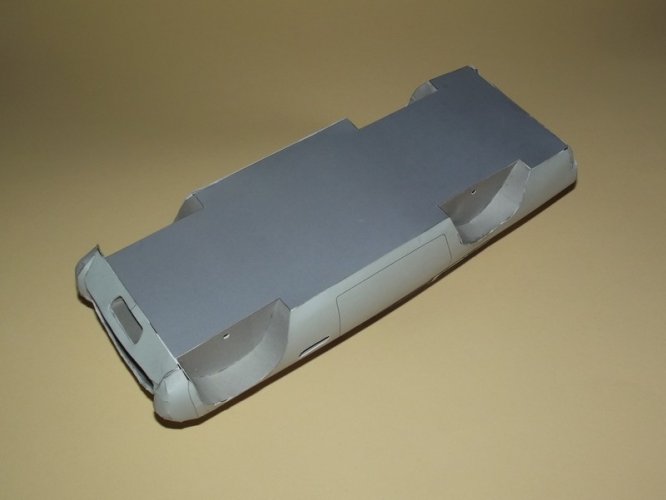

I added some flaps to the wheel boxes to give the bottom something to hold on to.

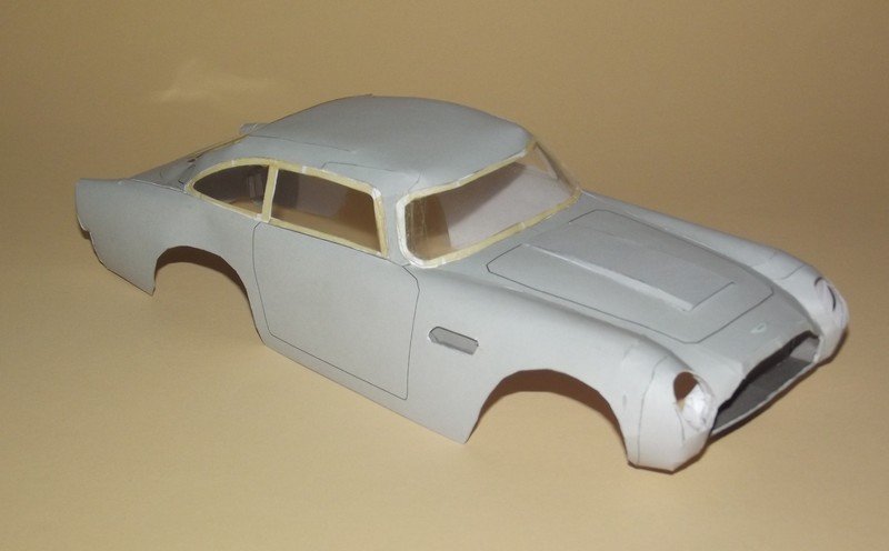

I painted the inner window frames grey to blend them into the basic colour of the interior. Leaving them light grey would make them show on the final model.
When I was dry-fitting both body halves I was shocked: The driver's cabin sat much too low in the body! I was trying back and forth to make that darn thing fit as intended but to no avail. The instructions do not tell you whether the tub has to be attached to the bottom or to the body frame. As I found out the hard way it has to be attached to the body frame. My mood was not the best, I can tell you. :(
So I printed another bottom (this time with added flaps), cut the old bottom to pieces to retrieve the cabin and glued the cabin to the body frame.
As a result of this the bottom looked much cleaner now since I had re-arranged the parts to print the part on one page. In addition, because of my sponsored ink I used the high quality printing setting so that there are no longer visible streaks on the bottom.

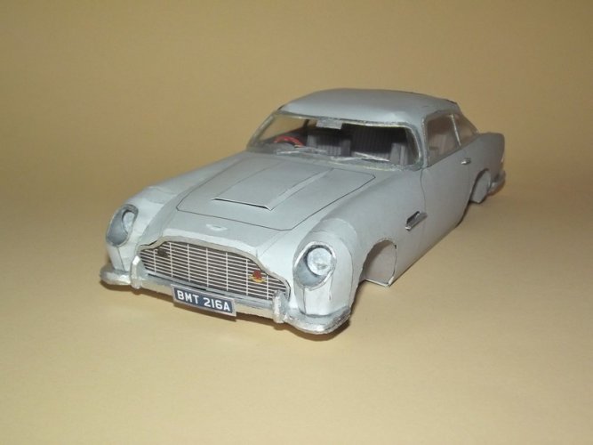

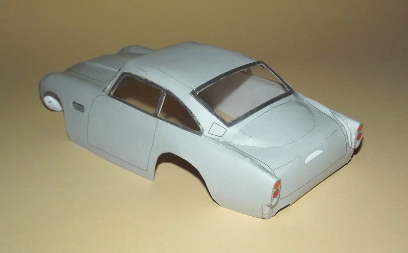

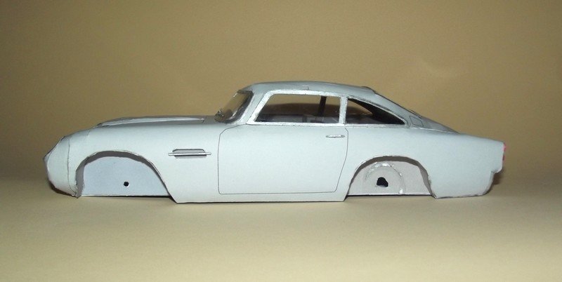

It was quite a struggle to line everything up. Due to the tropic temperatures here there was a constant danger of leaving sweat stains on the body but I was lucky. I started at the rear and worked myself to the front. Everything proceeded as planned. A few edges were visible but they were painted. I liked the result pretty much.
After that I began work on the detailing.

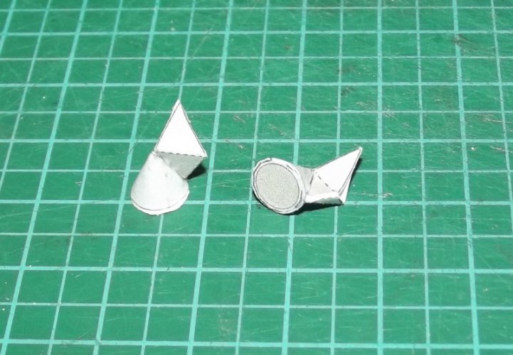

These are the parts for the side mirrors and the rim detailing.
The mirror mount was straight forward. Just follow the folding marks.
The open area is glued to the chassis later.

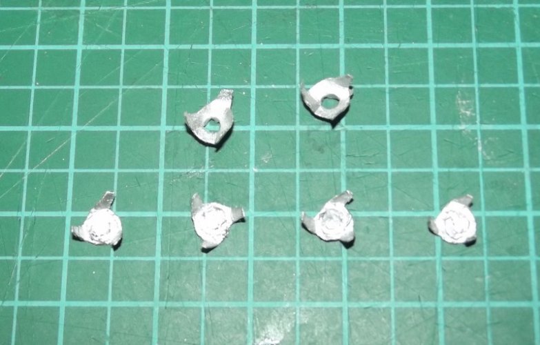

I added two more parts for a special effect. All parts were painted silver. So far so good. Then came the wheels.

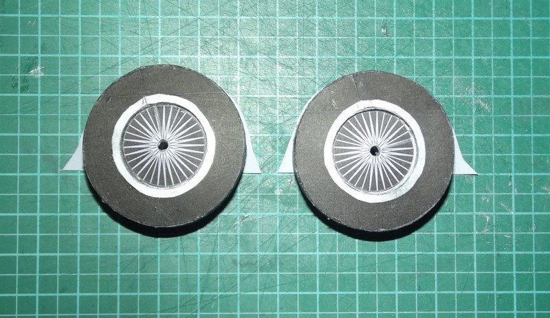

The wheels are designed in such a strange way. A traditional wheel would feature two even sides which would provide enough material for mounting. The wheels of this kit are nothing like this. I am not a fan of them and I have no idea why the designer created them that way. They consist of way too many parts, construction is very time consuming and on the finished model you do not see most of the work that went into its construction. The inner rim is hollow. The provided holes in the middle of the rim are good for positioning but they are too big for toothpicks and too small for shashlik rods. So I chose to glue the ring of the inner rim directly to the wheel box. That of course looked strange, the wheels sat too close to the body. So I cut them off again which led to some minor damage to the wheel boxes and rims.

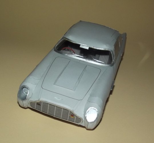

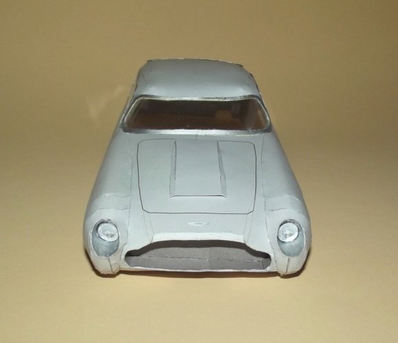

Looking at the front of the chassis I noticed that there was no rear mirror included. Of course the main body was glued tightly together and every attempt of opening it again would lead to its imminent destruction. So I decided to glue a small rectangle painted in silver to the outide of the front window.
Since it is reflective you don't really notice that the mirror was glued to the outside.

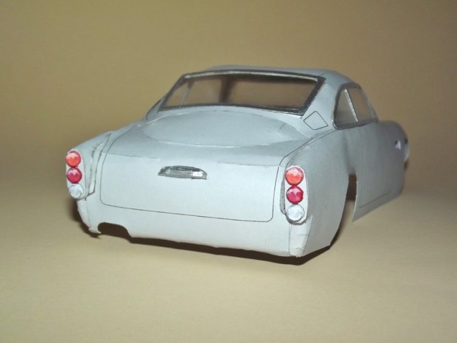

The front lights were equipped with clear lenses. Again, the kit does not offer a template for them.

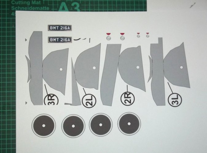

New parts to heal the scars:

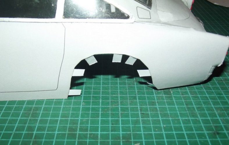

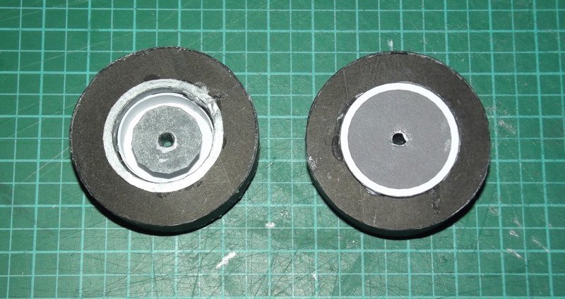

Front wheels boxes fixed. Rear boxes will be next. The old holes were widened for the special effects.

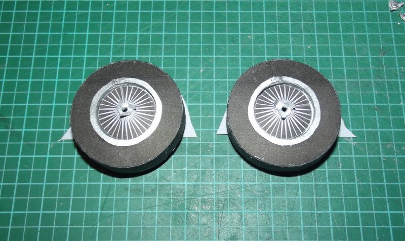

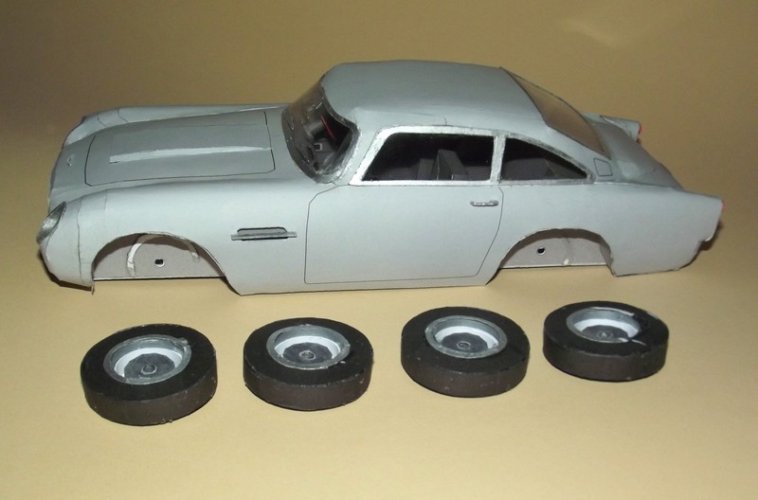

All wheels have a closed inner rim now. On the left you see how they looked "oob", on the left the more stable version.

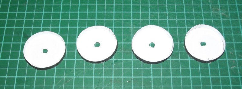

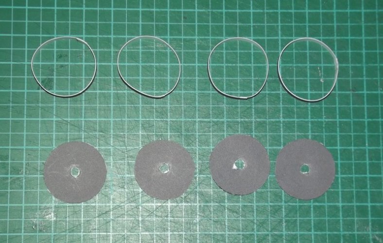

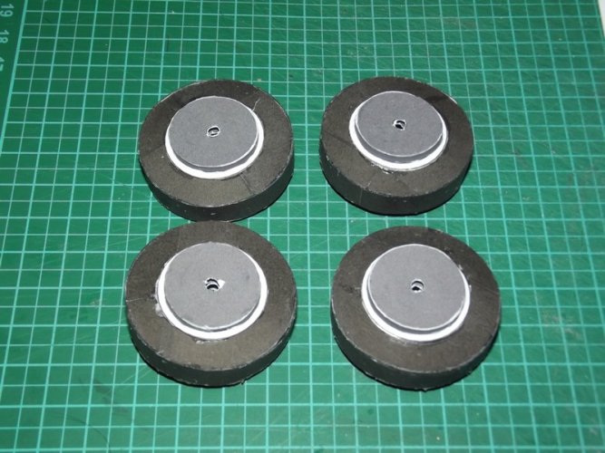

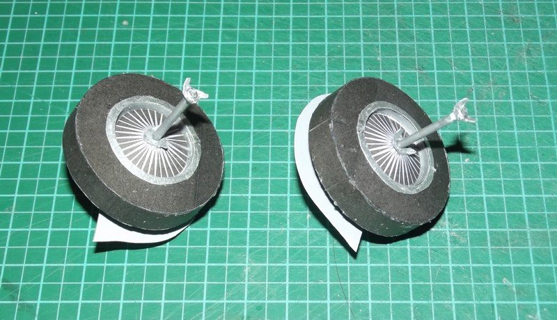

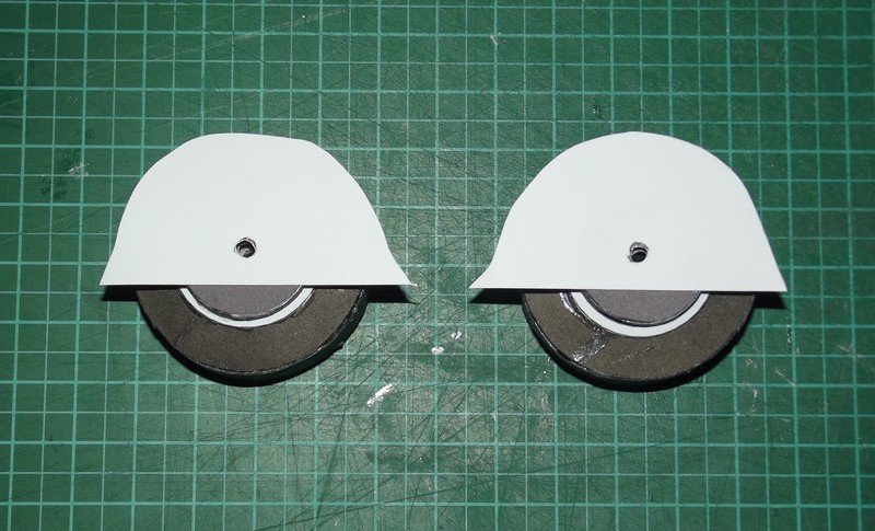

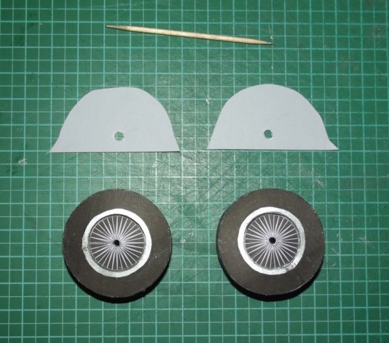

I tried to come up with an effective solution to the mounting problem which would not require too much additional work. So I cut out four strips and a new disc.
These were edge-glued together and then attached to the inner rim of the wheels.
The body received its bumpers and number plates. Much to my surprise the bumpers fit like a glove and this time the sketches in the instructions showed the correct position of the "battering ram thingies". :)

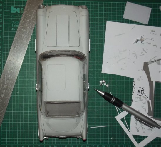

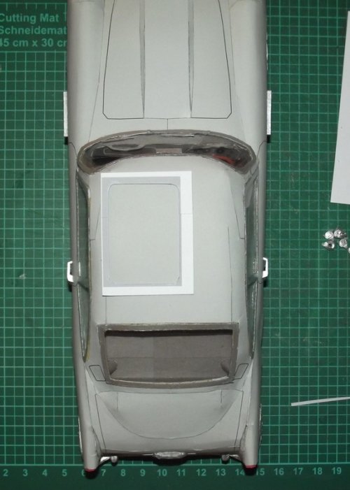

When I looked at the chassis I noticed that a crucial element was missing: The opening portion of the rooftop which is activated before the ejector seat sends the passenger to the heavens. I created a hatch and printed it. Unfortunately the colour was different because I had to replace two empty ink cartridges. The print could not be used and I had to switch to plan B. Using the print I created a stencil and traced the shape of the hatch with a pencil.
Due to the flash the line appears lighter in some places but please believe me, everything looks good. ;)

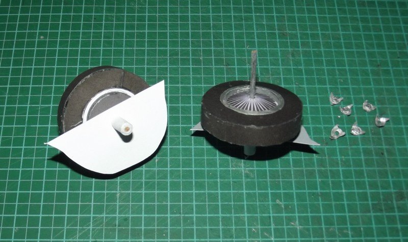

Now I returned to the wheels.
I used some toothpicks to determine the exact position on the chassis which worked extremely well. The front wheels were attached and then left to dry.

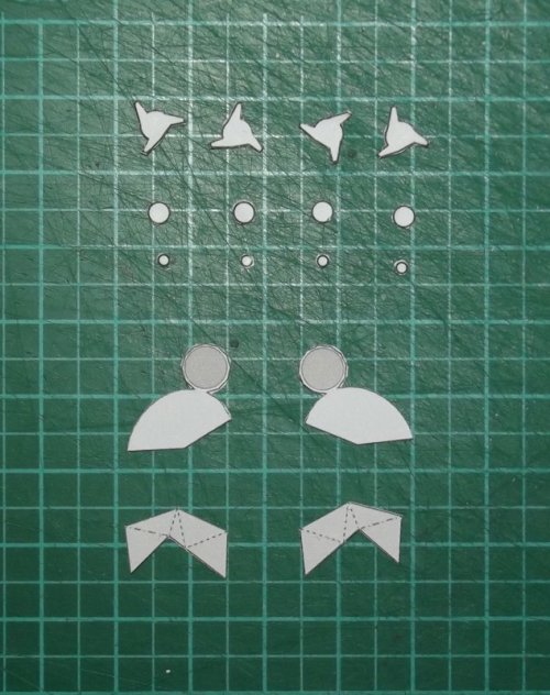

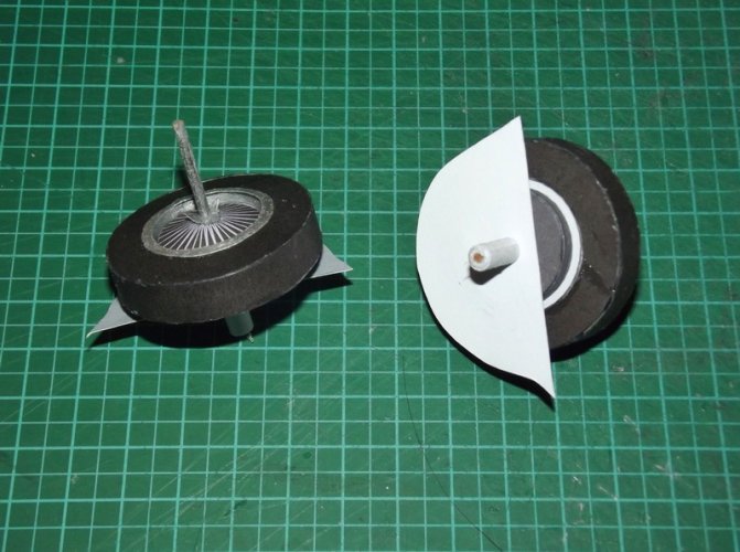

Then came the special effect.
Basically it is the same procedure as with the front wheels EXCEPT for one little difference:

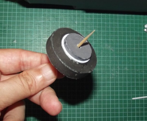

The wheelbox coverup is glued directly to the wheel now.

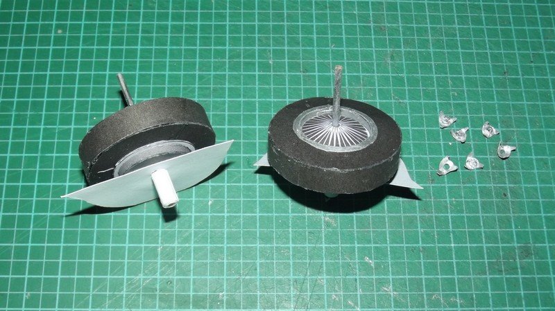

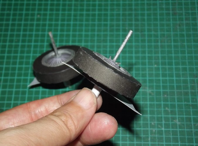

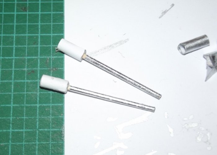

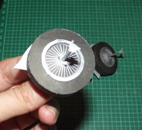

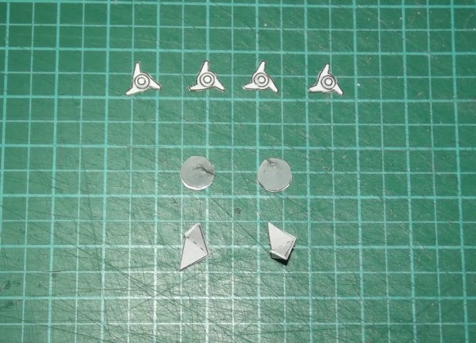

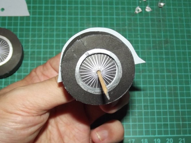

The pointy tips of two toothpicks were cut off. One end was covered with a paper strip, the other was painted silver.
The toothpicks were pushed through the holes in the middle of the wheels.
OK, they fit. For a moment I removed them to add a new part:
Another test fit:
Everything went as planned.
The final component was added to the empty tip:
And here we have fully functional wheel shredders! They move in and out and turn around, just like in the movie. Now you may understand why it was necessary to cut a big hole into the wheelboxes: To allow the bigger end of the toothpick to be inserted into the chassis when the wheels are glued tightly to it.
In retrospect the missing wheel spacers made this possible. My initial plan was to add static shredders to the build since it would have been too complicated to add them during the mating of the two body halves. This solution gives the model some authenticity because the shredders are one of the key features of the car I wanted to replicate. To quote my dear friend Bob:
