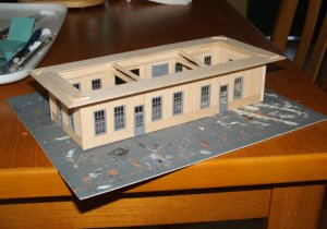

Ok, I don’t think that I’m going to finish this project by September 15th, but I’ll post updates anyway. This scratchbuild is based on an old Erie RR station in Avon, NY. Today it houses a bar. We just bought a house about ½ mile from this station and I thought it would be a cool model. I’ve been having problems resizing my own pictures of the station, so here’s a link to some 1970s pictures. Basically the building is unchanged:

Fortunately, elevation drawings for this station can be found in the October 1978 issue of Model Railroader, so I didn’t need to go out and do my own measurements. Getting a copy of the elevations and then ordering the needed parts took up a lot of time, so I’m getting really late start. I’m going to model this to how it looked in the late 1920s/early 1930s, so there will be a freight dock along the front of the station and the colors will be Erie’s cream and green scheme. Because there are so many windows, I will do some detailing of the interiors, and if I’m feeling really ambitious I may add lighting.

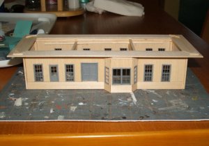

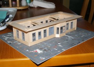

So far, I’ve built the body of the station. Basically it’s to the MR specs, but I compressed a little (the real station is 95 feet long, mine is 85 feet long in HO scale). Windows and doors are all Grandt Line castings; the walls are a mixture of board by board and sheet siding.
Next up is the roof. I think this is going to be the biggest challenge because of the multiple surfaces and angles that need to be worked in. I also need to decide on shingles vs. ribbed copper (copper was the original material, but was swapped out at some point). In the original station there is also all sorts of complicated gingerbread trim under the eaves. I’m not sure how I’m going to handle that on the model.

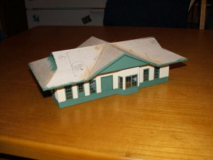

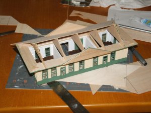

Slowly but surely making progress here. I think there's too much work to be done in the summer (work entailing barbecues, baseball games, and the dreaded honeydew list). Anyway, I've finished the roof and made some decisions about the structure overall.
Framing the roof ended up being not as bad as I thought. Basically I added basswood supports and then used basic high school geometry to figure out the right angles and measurements. I say "basic high school geometry", but that of course required getting gears that haven't been used in two decades moving in the old noggin....
I also painted the structure prior to installing the window "glass". My sense was that it would be a lot easier to paint the frames before the glass was installed. I still need to go back and do a lot of touch up, but all that comes later.

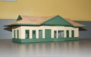

I also had to decide what to do with the gingerbread panels under the eaves. Below is the worst photograph in the world, but it shows the prototypical arrangement. I went out to the station and looked carefully, and each of the lines you see is less that 1 inch in width.
For the life of me, I just can't figure out a way to make this work on an HO model. The MR article has a diagram of the patterns in O scale, and even then it would take months to carve the panels; I can't imagine doing it in HO. I tried a less complicated pattern in styrene, but was really unhappy with the results. The author of the MR article suggested photoetched brass...Great idea but expensive to have someone else do it, and too steep a learning curve for me to do it on my own. If anyone has any suggestions, I'm game...
So I compromised and went with clapboard. This way I can go back and add the gingerbread later if I want to. I still think it looks pretty good.

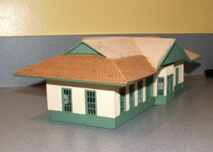

Next up are shingles and different pieces of trim. This is after about 90 minutes worth of work. The octagon cut shingles are from Rusty Stumps, and I highly recommend them.
