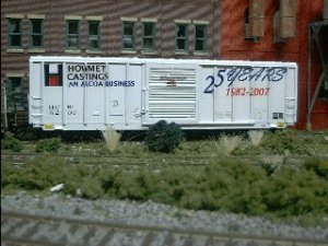

I'm always making my own decals.
Here's my lastest..I did for my companies 25th Anniversary.

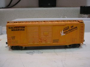

Ralph... I designed my decals today and printed them earlier this evening, let them dry, then lightly sprayed them with Testors DecalBonder as recommended. Let them dry for a couple of hours, and then did the application on one side of my boxcar. So far, it went well, they look pretty good.
The ink went onto the paper just fine, but for now I have only used black ink and a little bit of orange. What I am doing is a Galveston Wharves scheme on a 40footer, yeah, I know, not prototypical, but what the heck.
My findings:
The decals seem to be a bit more "finicky" than factory made jobs, not as easy to position, but that could be because my paint job was a bit less than glossy.
I used microset to position some, and just water for others. The plain water seemed to be better for positioning the decals.
Right after application, the decals had mini-wrinkles all over them which had me disturbed, and any efforts to smooth them only served to "de-position" the decals.
After they dried for awhile, I put microsol on them, and after 10 minutes or so the decals had pulled down nicely and the wrinkles are gone.
Special efforts have to be made to do white, as was mentioned in a post above, due to the inkjet not printing white ink. Testors makes white decal paper and clear decal paper. I used clear for the black lettering, and white for the seagull logo. To do the white seagull, I basically outlined it in orange, approximately the same color as the car. This was done in Microsoft Photodraw and Microsoft Word. I'll have to use some paint to blend the orange decal outline into the carbody. I'm not sure how this stuff could be used to do a lot of white lettering, except to design the white lettering over a textbox that is the approximate color of the car, and then blend it into the car body with paint.
I'll take some pics sometime soon. So far, I am happy with the results.
Okay, I'm doing three cars, just finished one side of each car. I figured out to put plenty of water on the spot where the decal goes, that made it much easier to slide the decals around into position.
So far, so good, I'll let them dry overnight and do the other sides tomorrow.
Update on decals:
Here is a shot of the boxcar I lettered using the Testors decal paper. I'm pretty satisfied with the results. Now I will finish weathering it and call it good.
Using the Micro-sol is a must, plus I sprayed dull-cote over it after it was done. This definitely helped hide the decal edges.
I enjoyed the process and intend to do some more oddballs like this one.
Very cool. And i am gald it worked out for you it looks good. Now what program are you useing to make the decals.
Thank you for the kind words. It obviously doesn't look as good as factory lettering, but once I get it weathered, I figure it will be satisfactory.
As for software, I used Microsoft Photodraw for the seagull and Microsoft word for the lettering. I found a photo of a Galveston Wharves boxcar, opened the pic in Photodraw, then "drew" along the outline of the bird. I put an orange outline around the seagull, then I copied and pasted that into Word. The seagull was printed on white decal paper. The black lettering was printed from Word on clear decal paper. The boxcar data came from a microscale decal sheet.
The seagull was a bit transparent once it went onto the car, so i touched it up with some white paint. I also blended the orange outline into the carbody with the paint I used on the car.
Doing white lettering may be difficult.

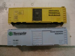

Here's a couple I just did, still need dullcote to blend in the decal edges and then some weathering.
It is pretty fun doing these things, since mine RR will be freelanced, I can come up with railroads that never existed. If you haven't tried it, you should.
