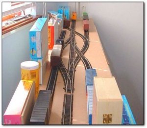

This is one of my designs called Ness Street (HO) Peco code 100 track with boxes used to mock-up the buildings. Hope it helps - though it may be too late!:cool:
Shortliner(Jack) away up here in the Highlands

Interesting layout, those crossings will give you a challenge :thumb: Bet you spent a fortune on those buildings, LOL :D I know some guys who started their switching areas by picking and building the structures and then arranging them how they look the best then run tracks to them. Seems to have worked. Guess there are all sorts of ways to go about it.
2slim
It was great fun to switch - but slightly too long for the space I had available.
I tend to get taken by new ideas, and build new ones every few months, so they rarely get as far as actually having scenery.
