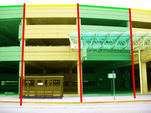

Something I noticed is that the curves on the original consist of a series of straight bars which are assembled in a row at a constant angle. This is exactly the way a 3D program forms curves. You could make advantage of it. Those tiny edges may be used as natural folding / cutting lines on the model:
.jpg
The red lines represent the edges forming the curve. Everything with the same colour is a straight face. This little trick can be used to acurately place the coloumns, too. They should be on each red line.

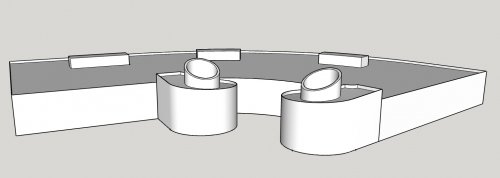

And here we have the entrance/exit ramps built and attached. The ramps extend above the top of the garage because they were intended to accommodate a further expansion of the garage which never materialized. The parking garage itself is now complete as far as the 3D design goes. I do have a concept for a more detailed version of the ramps but I'm concerned about the technical feasibility of physically executing it in 1:400 scale.
Still to be added... the office/pay booths (it resembled a highway toll booth as far as I can remember), and the two road and 3 pedestrian bridges that connected the parking garage to the airport terminal.

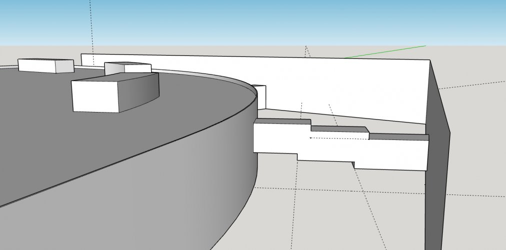

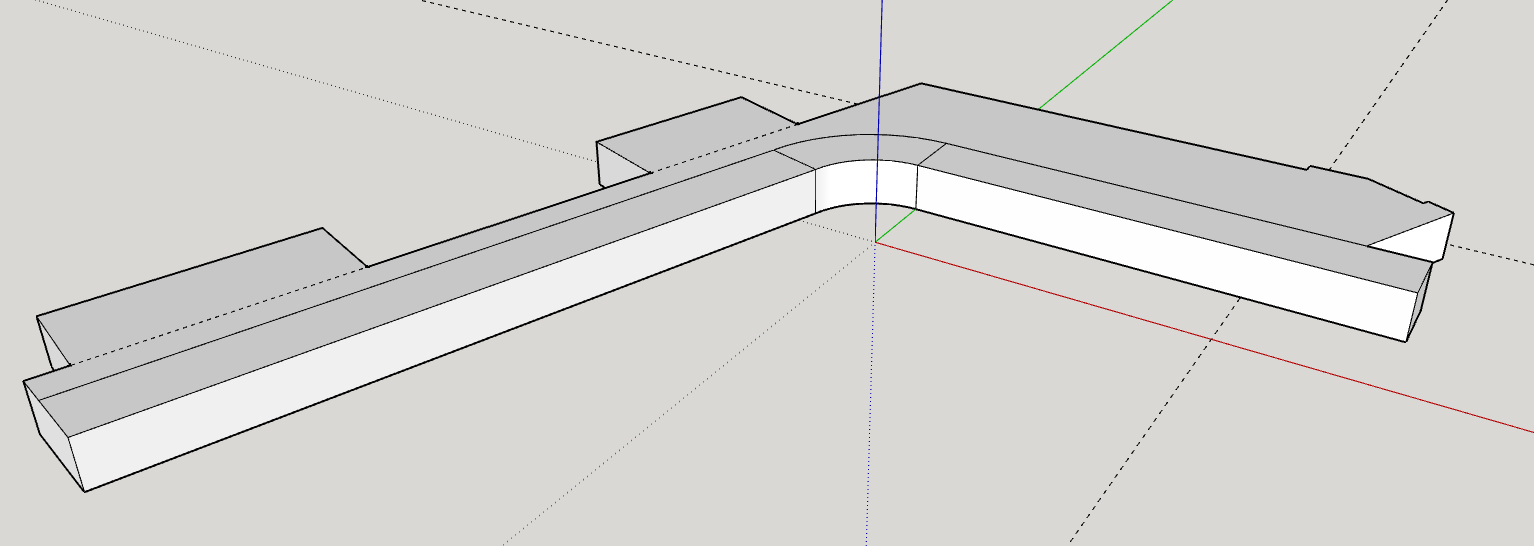

Temporary mockup put in place to show location of outer wall of landside facility. Skybridge A fully modeled. B-C (one bridge serving two concourses) and D roughed in but not fully shaped. The walkways slope downward from the parking garage to the terminal, from parking garage level 3 to terminal level 2. By my reckoning it's a 7-foot drop. The bridges have a 3-section stairstep appearance, but the pedestrian walkway inside is a smooth slope. The support columns might not get modeled here as it's probable I will make those of wooden dowels rather than modeling them in paper.

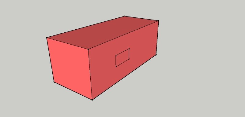

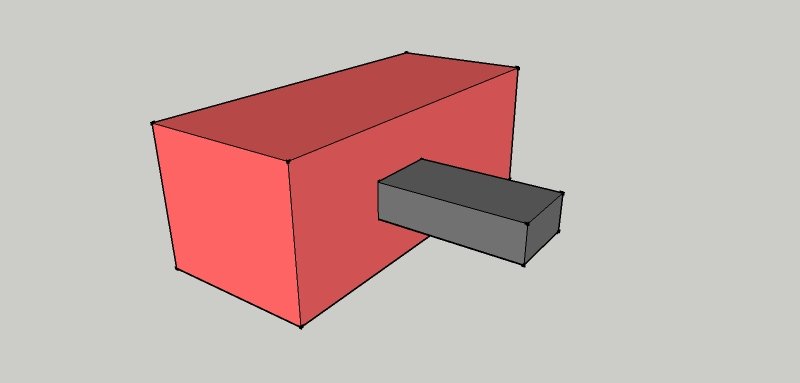

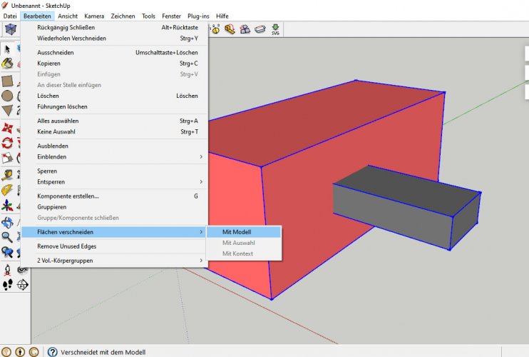

When you have set the correct position you should do this:
Select both shapes. Go to Edit - Intersect - Intersect with Model:

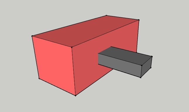

Both shapes are cut to pieces where they meet:
Delete the bridge parts sticking out of the garage to edit the garage only:
Right-click on the rectangle in the face - Delete:

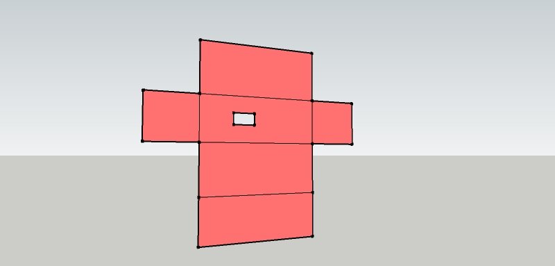

This will create a hole in the geometry. When you unfold the shape it will look like this:
The hole can be used to position the bridge.
One thing is very important: When you do these kind of operations ALWAYS WORK WITH A COPY. You will need to edit the bridge part separately later in a similar fashion and if you do not create a copy you are in danger of overwriting and losing the original. ;)

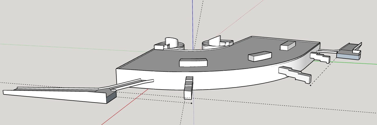

All bridge ramps which will connect the parking garage to the main terminal are now complete: pedestrian sky bridges A, B-C, and D, along with the bypass road entrance and exit ramps. There was a bypass road which split off from the main road into the Departures section of the terminal, which crossed over the lower level roadways, passed along the perimeter of parking garage level 3, and rejoined the main road at the exit.
