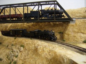

I use all sorts of tools to carve mountains...A good keyhole saw with interchangeable blades is a good one to start with. You can use it give your mountains a rough shape. Then use a rough rasp (like a file for wood) to further shape them and finally small Exacto saws and blades to finish up the job. Once you've got the look you want, you can put on a layer of plaster or sculptamold to blend everything together and give them a rocky texture. With some time & patience you can come up with something like this....
