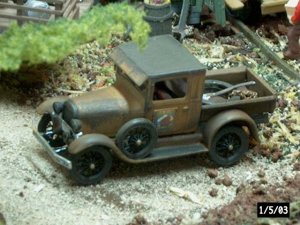

When I have my camera set up on 'macro', with 'aperature priority', then zoom right in, and it is on 'auto focus'. How can I tell what it is actually focusing on?
This shot was supposed to be focused on the truck.

Nice shot Drew!
I really like all the clutter, & junk laying around...the stuff in the bed of the truck looks exactly like what's in the back of the one out in my driveway!!:D
It looks like maybe they've had a flat tire, & have the right front jacked up to change it...:)

Prob. are more ways AF cams focus than brand names of cameras. Some just focus on whatever is in the center, but many are more sophisticated than that. Perhaps the camera documentation will tell you, and understanding how it "thinks" may lead you to better control. My old Canon has a red light I can see on the subject only if I hold it out and don't use the rangefinder and where the red dot is, is the focal point. What a cool truck!
Agrees with Jon. Maybe Shamus can help ya out. I have found that my digi cam often focuses on the brightest/lightest thing in the feild. which seems might be the case in your first pic.
Nice modeling anyway ;) awesome truck!

Thanks to all for the reply, sorry for the late reply. Just got in tonight from work and thought I better write back!
Shamus- OK, I won't use macro and zoom at the same time:o :o But when I do zoom in a bit to fill the frame better, the fstop # does increase automatically to about f4, then I can bump it up to f16 manually, which I try to do on all shots.
