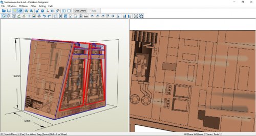

When I built Shunichi Makino's Sandcrawler I chose to re-design the rear end of it. To do so I replicated a virtual rear section in SketchUp and unfolded it with Pepakura Designer 4.
The texture image was 2050 x 2874 pix, so it should be processed quite nicely. Yet, the texture is displayed totally blurred and of very low quality:
This gives a false impression of the quality of your model's texture. It looks way worse than it really is.

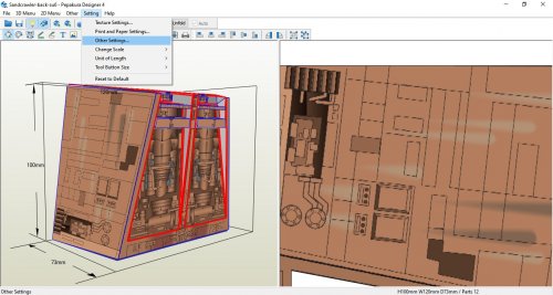

Setting - Other Settings...

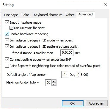

Advanced - ENABLE HARDWARE RENDERING - OK

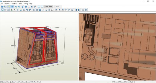

Restart the program - et voilà:
What a marvel to look at! :)
Please note: This trick is not able to improve the quality of the printouts (these are ALWAYS done with the highest quality possible). It only affects the display window. :)
