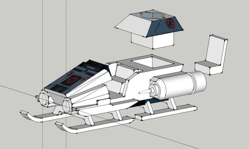

Not perfect but enough for me to fire up SketchUp:
With the basic shape set it was time to revise the droid compartment. The hood still looked more like a Xmas sled and was not very aerodynamic, so it had to go. Like this:
The compartment is multifunctional: It is able to hold a droid and can be replaced with a different plug for various purposes. A quick research on sled and skids gave me the info that two pairs of skids make a vehicle faster, more stable and safer in rough terrain. So I kept that idea. Even if I did not tell Gemini that it took that into consideration. Good tool. :)
But of course!

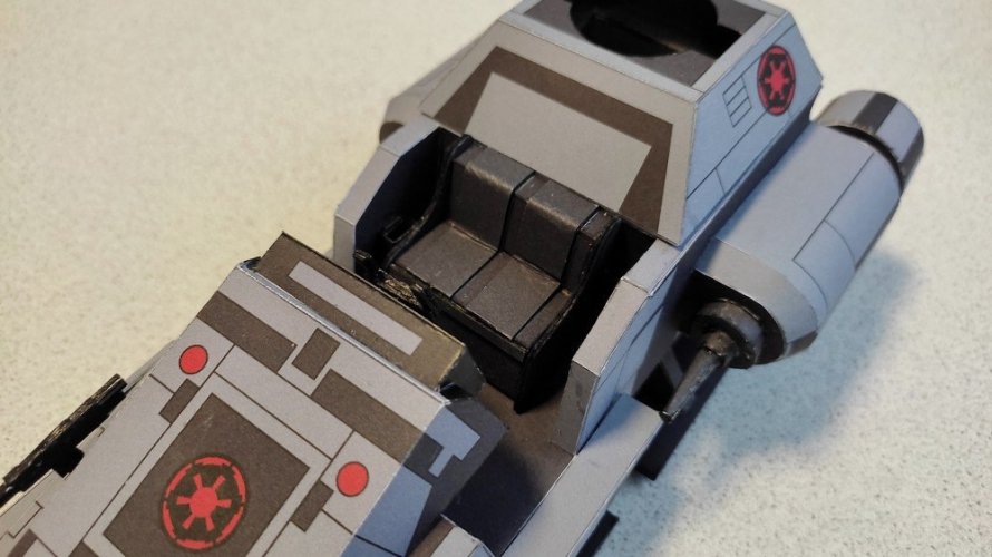

I especially liked the seat Gemini came up with:
Unfortunately I had to cut down the back rest because the trooper wears a grenade on his back. I had to make sure that he was able to sit properly. The overall design did not suffer from that though. :)

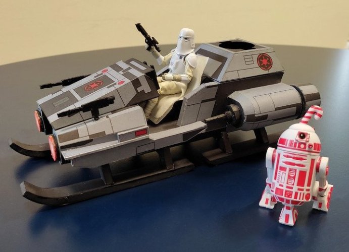

The project started on December 6th, and on December 18th it was finally printing time! :)
You can already imagine the pressure on me. Dispatch day was December 23rd, so there was no margin for error. To save time I skipped adding flaps to the template and marked the areas which I thought would need them. I took a picture of each page to remember the positions when I had the time to add them to the parts in Corel.
I started with the engines. You know how much I like assembling tubes... :hammerhead:Thank Goodness there are not too many of them. :)
The main body assembly is a bit different from what you might expect. Usually you would assemble a big block and the engine tubes separately. However, this time both components are fused together. This was done for two reasons:
1) Assembly was faster.
2) You will not get any gaps between the main body and the engine tubes. No matter how accurate you will build them - if they are separate, you will always see a gap. I wanted to avoid that.

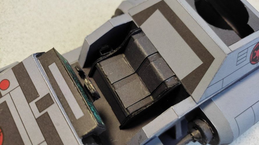

The seat area including the inner and outer shell:
Necessary flaps were added on-the-fly:
The droid compartment:
Please note the hole in the middle. This was done to enable you to insert the droid without removing the center foot. That way you can put the droid in and out faster and do not run into the danger of losing the leg.
Compartment installed:
The seat area is glued to the outer hull step by step:
The droid cover:
The back side is black so that you don't see any white areas when you look inside.
Cover completed.
The hood:
The first nose box:
Note: The box was heavily altered in the course of assembly, so the final version will look different.
And everything loosely put together to see if everything fits:
YAY! There is enough space for the trooper and the droid! Success! :)
Yes, you have enough space for greebling and enhancing the panel lines! ;)

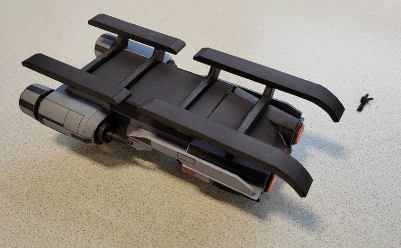

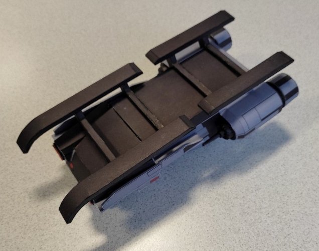

Next I tackled the skids. They are assembled ver traditionally. Due to the flatness of them it is easier to insert some corrugated card for stability rather than adding a skeleton:
The skid mounts are very stable and much to my surprise nothing warped! :) Of course you may choose to add some card inside. If you dare. ;)
Several parts have to be laminated to 1mm card:
Despite the height correction the seat still looks VERY neat and practical:
Sorry for the blurry pic; I took it late at night under very bad lighting conditions. The second one is sharper but ugly because of the flash. Ah well. :hammerhead:
I had to cut the sheel open again to insert a stabilizer on-the-fly:
This was improvised to save time (reminder: we have December 21st, two days till dispatch!). The final model will have a proper skeletion piece.
After closing everything up again the base looked like this:
As if nothing ever happened, and the trooper will sit securely without sagging later-on. :)
Next we revisit the nose piece. I noticed that the first unfold was not good. I separated the front lights from the center block, thinking it would be easier to assemble them that way. However, the back plate where the front lights were supposed to be attached to the nose block proved to be unstable. The parts shifted and could not be controlled which would have caused a wonky result. So I went back to the drawing board and fused the lights and nose together into one solid block with no way of shifting pieces:
I was afraid this unfold would be too difficult but much to my surprise everyhing went together very well. It is the most difficult part of the kit (in fact I think it is the most difficult part I have created since the back halves of the Colonial Blaster) but if you work your way through one step at a time you will succeed.
A much simpler piece is attached to the bottom.
I added a crude piece of corrugated card before closing. The final kit will have a proper skeleton. The part is as solid as a rock.
All main parts are glued together.
December 22nd - time for the detail parts.
The foot rests for the vehicle.
Test fit of the skids:
Perfect! The skids are attached:
The parts for the thruster tips:

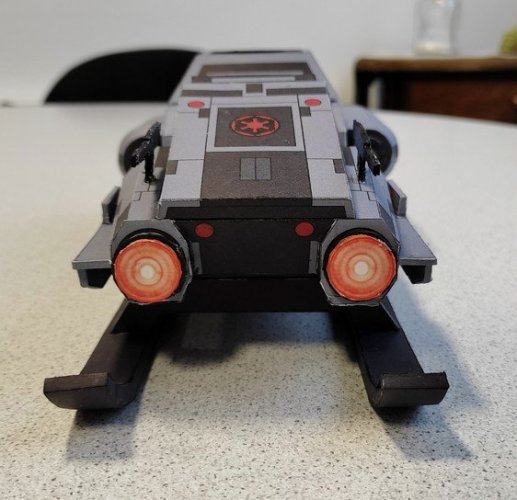

The front lights:
The guns are flat pieces (because of time constraints) but they look the part:
Then I was thinking of where the trooper would put his gun wile driving. Well, he would put it into a gun tray:
The foot rests are cleaned up using coloured paper strips, exactly like the edges of the AT-ST were cleaned up:

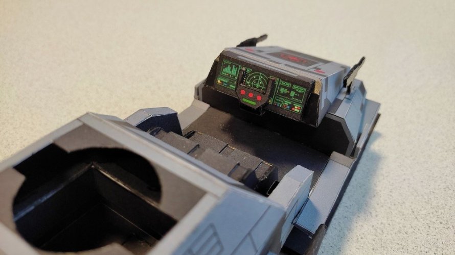

The steering:
Gemini gave me the control graphics. And yes - I had an accident when I was cutting out the laminated parts. I cut into my index finger and almost sliced off a good portion of the tip. It was held in place only on a 3mm wide area of skin. Fortunately I did not hit any major blood vessels, the bleeding stopped almost instantaneously. However, I still feel the spot, 5 weeks later... :sticktongue:

Sorry for the wait but here is the continuation of the build! :)

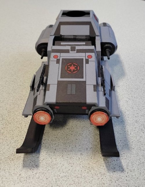

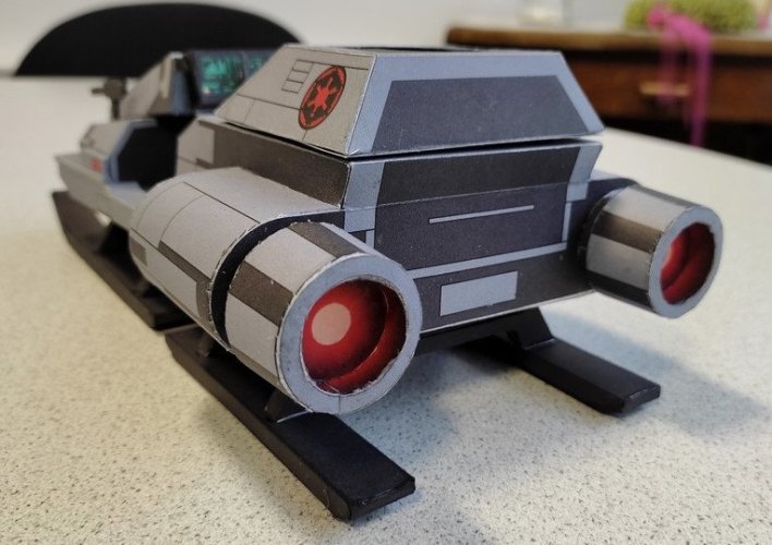

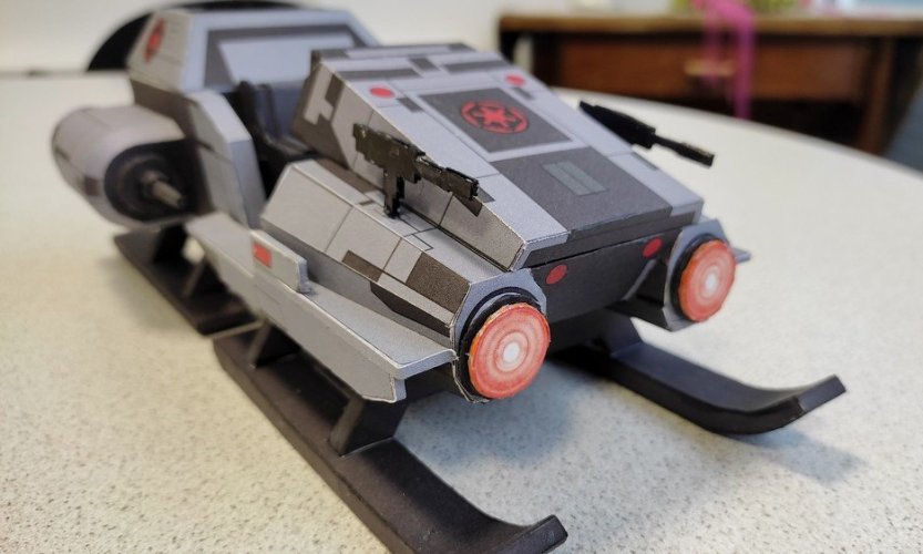

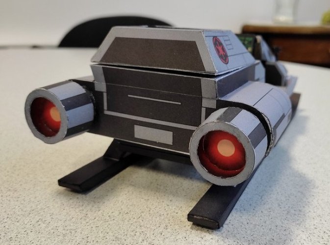

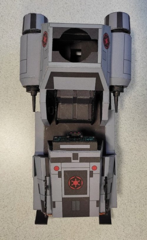

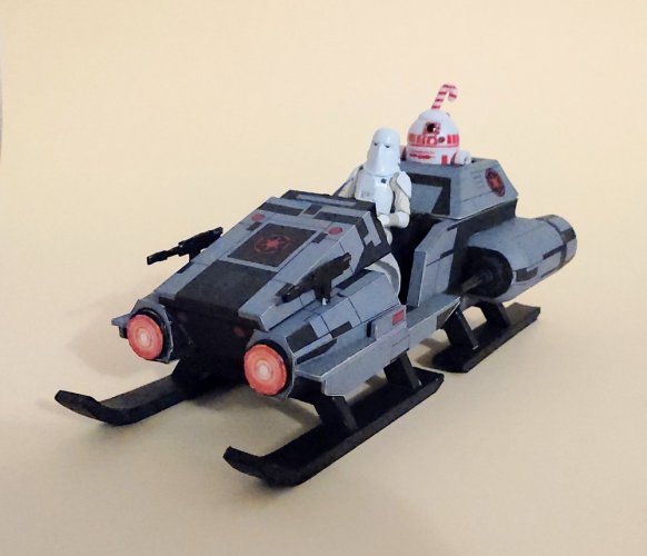

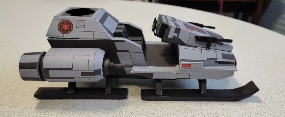

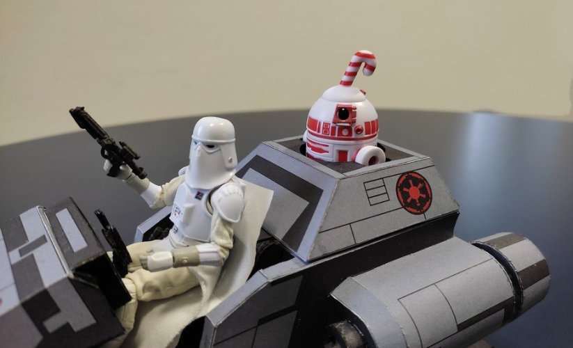

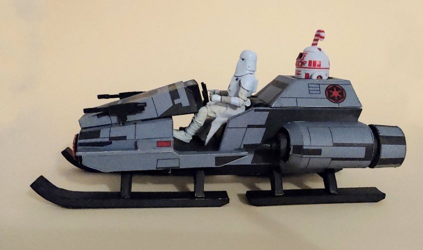

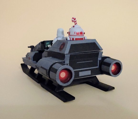

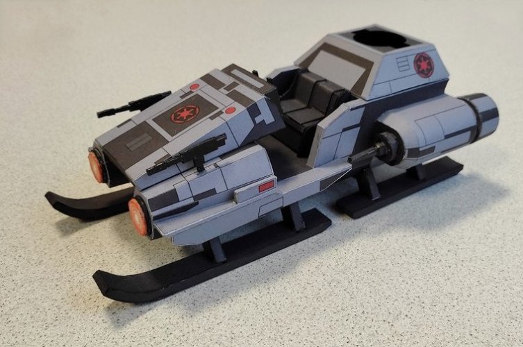

With all parts set it was time for the final assembly. Everything fit as intended and this is how the model looks:
Due to time constraints (and my wound) I left the cannons flat. Of course you can use it as a template to roll paper around a central tube and attach those; this might look a bit more authentic.
The trung can be inserted and exchanged easily and the gun holder does its job. The skids are firmly in place and do not wobble (much to my surprise and elation). :)

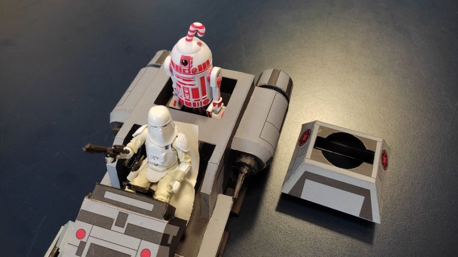

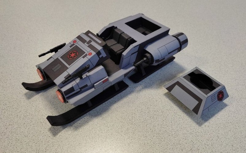

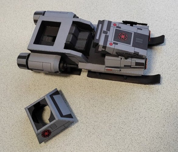

The trunk lid is removable for two reasons:
1. In order to mimick the usual droid in a socket look you need a close skirt around the droid's upper body. This means that the hole must follow the shape of the body tube and the upper arms tightly. As a result of that, the legs will no longer fit through.
So you remove the trunk lid and insert the droid
and put the trunk back on.
To make sure that you do not lose the center foot of the droid the trunk has a hole in the middle so that you can insert the droid without removing the foot. Clever, eh? ;)

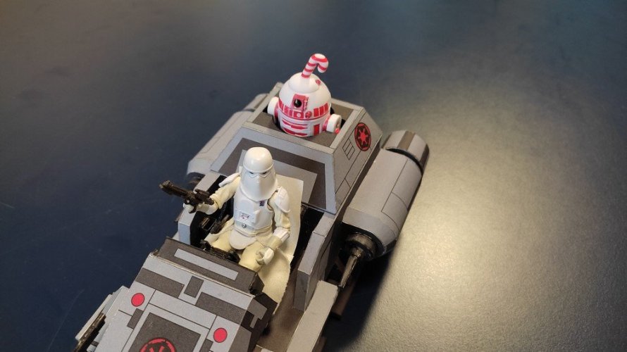

And another view at the screen. The graphics are gorgeous!!!
Please note that I put a piece of tissue paper between the trooper and the vehicle so that the ink does not bleed into the fabric. I don't know if this might be an issue but better safe than sorry.

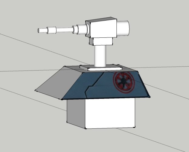

2. I have a few more ideas for replacable trunk lids. One of the most obvious ones: A completely closed one. The next: A rotating turret.
