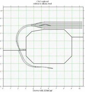

im stuck on my layout

It is a very nice plan , sometimes its very difficult to add in a staging yard to a plan thats already completed. A double ended staging yard would be ideal, obviosly one end would be easy enough to add on its the other that would be the problem. To bad you couldn't decline to below the bench work like I did on my layout. 10 foot sides is really quite a bit to play with.
tell me about it!i had staging on the original plan but i took it off.now since the benchwork past the steel mill section is 6 inches lower for more dramatic scenery,im running under the steel mill!so it worked out pretty well,IF i can get it to work :D .TIA--josh
OK guys,here how far i have goten.it isnt much but i still cant find a way to keep my 5ft minimum yard length wall1.this is a weird angle to work with also so any help is appreciated :mrgreen: .TIA.--josh

thanks for helpin josh,but ill still need a way to turn the whole train or atleast the engine,cause steam rarely ran backwards on a mainline.i was thinking of building a turntable under it but it could be hard to check the alignment of the tracks under 8in of space.--josh

my minimum radius for hidden track like this is 20in but for my 2-6-6-2 id like to keep it around 22in.and this is hot it goes,that dead end track is seperate it is for the depot.the engine will leave the mainline to go to a "destination"then return heading the opposite direction,not backing out of the yard.i hope im not confusing anyone with my un-edumacated lingo :D --josh
