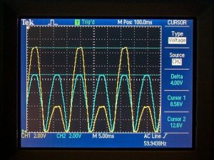

This may be a bit late, joined the Gauge after your first post and haven't seen this till now. If you haven't bought one yet or are looking for a second one, there is a big performance difference between the MRC 1300 series and the MRC Tech II series for a slightly higher price.
The 1300 outputs 120 Hz full wave rectified unfiltered sine pulses of varying voltage as set by the position of the throttle knob. The incoming 60 Hz AC is frequency doubled as a normal product of full wave 4 diode bridge rectification from AC to DC.
The Tech II outputs pulses in pairs - higher voltage 60Hz pulses interleaved with lower voltage 60Hz pulses. Both pulses have a peak voltage as set by the throttle knob, but as the knob is set for higher speeds the voltage difference between pulse pairs decreases so at full throttle the output is 120 Hz equal level pulses. But at low throttle the main pulses are predominantly 60 Hz followed by very low voltage interleaved pulses. This lower frequency 60Hz gives smoother running and higher torque than 120Hz.
In the photo the blue trace is the MRC 1370, the yellow trace is the MRC 1440 Tech II. Both are set to medium speed, 55 smph for a Z scale Micro-Trains F-7 locomotive. All my trains, both N and Z scale, run much nicer at slow speed on the Tech II .
