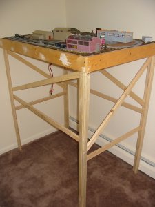

I finished my platform legs. It took me a second trip to Home Depot though. I had to get more wood to make the diagonal bracing; the layout was a bit wobbly with only the horizontal and vertical pieces.
I see what you mean about the height. I am a little over 6 ft and the layout is about 4 ft off the ground. When I reach over my sleeve just brushes the tops of the building.
