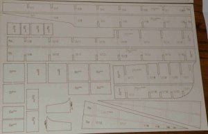

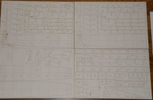

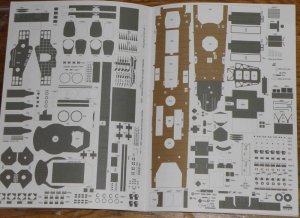

I purchased the laser cut hull frames, 1st time to build with them. I figure why not, I have built plenty of and will continue to build many more hull I have to cut. Probably a wash between the cost of the laser frames and all the number 11 blades i won't need to use up and it will save a tom of times. Plus I think I will get a feel for how good I really do with cutting my own hull formers.
Here are some pics of the parts.

This certainly looks interesting. I will follow your thread closely.
Greg
I've been looking at this model for a while. I've not seen one built, so this should be fun.
The laser cut frames look like money well spent.
Can't wait for some more updates.
Got the same kit w/laser cut frames, and w/the laser cut frames you also get some PE as well. All that is missing is a set of barrels. Will watch this build since I too will build at some point. INJ are some of my favorite ships. I thought I would add the following, the PE is laser cut paper/card parts that are amazing.:eek:
Looks good! Dumb question, I know, but are the frames full thickness? Looking forward to seeing this one in action!
-Ski

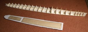

Nothing like these laser frames. they doubled up the supply for the 2mm thickness frames, all the bulkheads and waterline deck. Just laminate and install, I cut notches where the tree was still connected to keep the parts square. 3 hrs work and the waterline up frames are installed. I still laminated the after deck to 1/32 balsa (close to 1mm). The deck is interesting as parts are printed inside the outer area. They have a .5 mm double deck for the Japanese linoleum deck to build up. I will install some spare card so the next level does no sag into the gap. Very fun build for such a short time.
This is the 1st time I ever started a model the day I got it. The guns are 5.7 inch (140 mm) so I will be using the clock pin that I just bought with paper rolled over a portion of the barrel to simulate the telescoping form, I expect it will work fine. I draw the line at 8 inch CA barrels for turned CNC, smaller guns are not noticable from any normal viewing range and not worth the $'s unless they come with the larger mains.

I've been looking forward to actually seeing someone building this Yubari. It's a ship I love a lot but the details all look a little forbidding... :D Good luck!

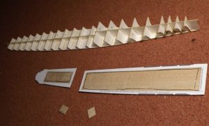

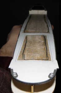

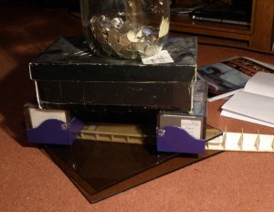

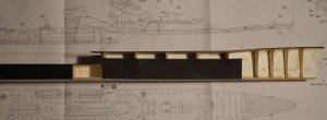

After placing the upper bulkhead formers I glued the center of the hull with a dab of thich CA in the middle of the hull under former 14 and attached it to a plate of glass. This made the hull very straight. I did this because there was a bow upwards at the hull mid section. I attached the 2 black card stock hull sides, not kit supplied. Once dried I twisted the hull off the glass leaving a small hole under 14 but also a very flat waterline section. If the hull was bowed upward at the ends I would have glued them down at the tips and proceeded accordingly.
I then added the 2 bow false sides making that portion of the bow stiff and square. I did this bacause the bow tip 5 formers were twisted slightly to the starboard. This did not remove the twist until I added the foward main deck. I glued it to the 5 formers with the false sides attached. After that was dried I forced the bow twist out by using the deck and gluing the remaining formers one at a time foward until the tip was attached. The final hull frame became flat as glass.
Last, just attach all the lower bulk heads and keel.

Funny on the jar of coins. I look for anything and everything heavy that I can find to put on the deck during mounting. I'm glad to see I'm not the only one with a unique idea of what classifies as mounting ballast...

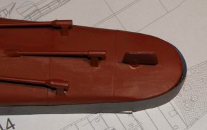

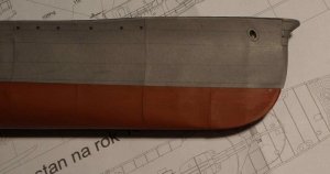

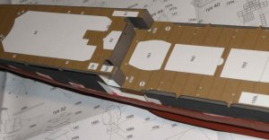

I got the lower hull done Saturday. Overall the fit was excellent. I wrapped thin copy paper over each former then added the hull plates. I started at the center and worked both foward and aft. The only poor fit was the usual culprit the stuffing box protrusions. They do not offer a very good angular fit for the shafts. I painted the lower hull with my home mixed IJN red, 1 part each Testers flat red and rust. I laminated the main deck linoleum as specified and will install them next, followed by the main and bow deck supperstructure. After that I will add the upper hull sides.

She's looking really good. I'm starting to leave some extra length on the lower hull pieces where they meet the upper hull, a lesson from my HMS Hood build. It seems like you never have enough left at the top ends to cover the seam between the pieces.
-Ski

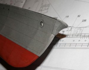

I left about 1/8th inch, always have. In this case it did help. The model leaves no added margin. Even the printed parts fit just line to line so I have to color the white edges. I wish printers would not print the glue edge in white but onle use hidden lines to aid in alignment. Also even though the fir was good the decks are about 1/16th inch too long. Since the end of the deck is used for depth charge racks I decided not to shorten it but leave a gap between the hull side and bottom, this will only be visible when viewing the model upside down anyway.

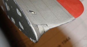

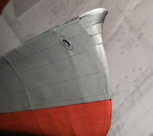

The decks, hull sides and bow are finished. The biggest problem shown was with the fit of 3 small bow pieces to blend the upper rake of the deck with the sharp cutter bow. The pieces shown attached left a lot to be desired. I improved it bt delaminating some spare card stock and paper machaying it to the bow. I think it improved the look well enough not to be an obvious focal point of the ship. Also shown is the gap at the stern, not visible from the side or above. I could have trimmed the deck to fit bit would have left the upper deck obviously too short. I feel displayed the overhang will not be so noticable. The bow I did trim back about 3/32 inch. Normally I would contribute the miss match to my skills cutting formers but not this time. Overall the decks are to long by almost 1/4 inch and either the laser cut decs are wrong or the kit is and the laser cut parts were modeled from the kit. Overall I like the way she looks so far.

What is the purpose of the black card attached to the sides, is this to stiffen or to black out something behind the hull? I was just curious if the card served another purpose. Thanks.

I usually build the keel full up then add the bulk heads as single pieces. After installing, no glue the bulk heads, I add the two waterline plates. I have found that building the hull in one segment and not restraining it until all the parts are fitted gives the best results. I physically hold the 2 waterline plates, sqeezing them to force the keel to be straight then drip part by part thin CA glue to the bulk heads, aligning them vertically one at a time. Last I glue the horizontal waterline plates.
For this model I purchased the laser cut Yubari frames and was forced to build upper and lower separately. The black paper was added to maintain the upper section straightness while I added the lower frames. I noticed long ago the hulls are not solid (straight) until the paper plating is added, so I cheated. It worked very well. This was the 1st time a used laser cut parts and I guessed or hoped that this method might work. It did.
As it turns out I added the black card stock to the bow even though I already framed and sheethed her lower hull. I got the smoothest raked bow ever, few ripples if any. I think I stumbled on to a nice way to add upper plates without filling and sanding styrofoam as others do. Black works because the seems are dark anyway and white is obviously not.
