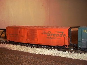

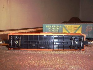

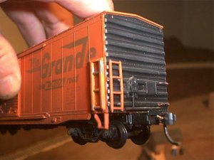

Here's one I am not sure of.

Ray, that car also looks like it has a Details West underframe. Any chance the carbody is from Robin's Rails? I had a Great Northern car that looked similar to yours, although the underbody was different.
Other guesses would be McKean or Front Range.
Wayne
