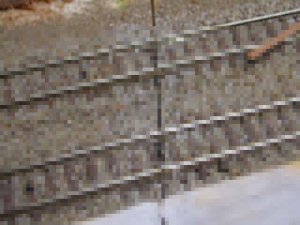

This is the kind of connection i want to have between my modules, but hw can I achieve such perfection?
btw, the modules are not yet completely screwed together in this picture. (seen at http://www.modell-bahn.de)

How can I achieve this kind of perfection building this kind of interface between my modules?
Btw,the modules are not yet completely screwed together (seen at http://www.modell-bahn.ch)

Luis:
The NTrak way to do it is to leave room for a section of track at the joint (half on each side) and put the section in when you join them. The sction of track is ballasted (or not) to make it less visible.
Some people do it just like the picture, with space to slide the rail joiners out of the way. I would leave the ends a little loose for alignment.
I have read articles where brass screws are put into the roadbed close to the end and the rails soldered to them. This makes a very solid location. The people using this usually omit the rail joiners.
Joining the baseboards?
C clamps.
6 mm (1/4") bolts and nuts with washers.
Hinges bolted flat to the sides of the baseboards so that the pin can be removed/inserted to hold them in place.
Dowels in the end boards to force a match.
I had one where the builder had cut the under-plywood in a tooth/indenture shape to force a match. (This was very heavy construction.)
If you are building a permanent layout where the connections won't be taken apart and put together regularly, you can do it just like the picture. For a module that will be taken apart and put together regularly, track coming to the edge of the benchwork needs to be protected in transit. Some members of the modular club I belong to have done similar trackwork between modules, and they put a piece of aluminum angle over the tracks to protect them in transit. If the rails extending to the edge of the benchwork get bumped, they will be damaged.
