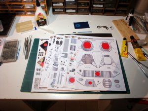

OK let's start with the printer... well... this was easy :D

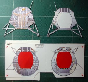

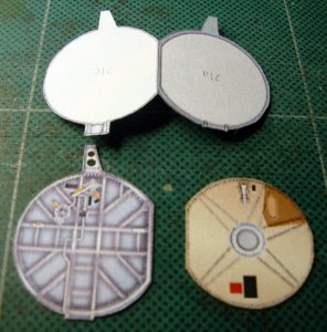

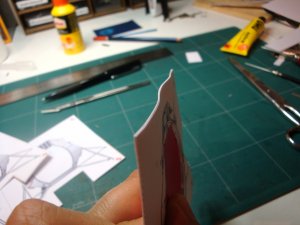

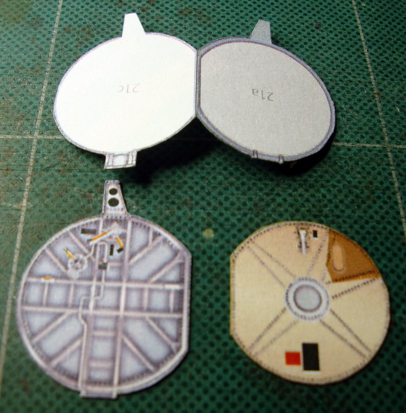

Well... the start was not very lucky. I used white glue to laminate the 3 layers strucutre (as indicated on the sheet itself) but, perhaps used too much glue. So, even if I let it dry inside a big dictionary all night long, my first LM piece came out badly distorted.

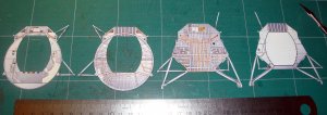

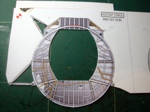

The good part of card modeling is that you have a second chance all the times: just print again and retry. This time I want to use my preferred glue, a solvent based one (UHU) and, instead of 3 sheets together, I'll laminate 2 sheets only (a clean piece of cardboard under one of the printed halves) and will cut separately the third layer. I prefer to cut twice and then align the parts while glueing instead of folding the page before cutting (using the little red references), because I'm sure that one of the sides (the one faced down while you cut) will probably result screwed up due to misalignment.
Up: the second try, much better. Under: on the left the laminated piece, on the right the single sheet.
Moreover, two layers are easier to cut than three
The four halves already edge-colored (with grey felt-tip pen)
After another thin UHU layer the first nucleus of my LM is ready...

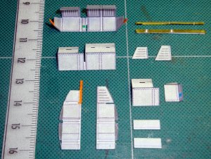

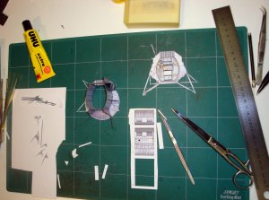

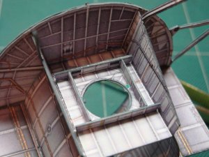

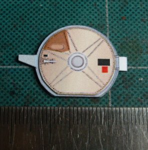

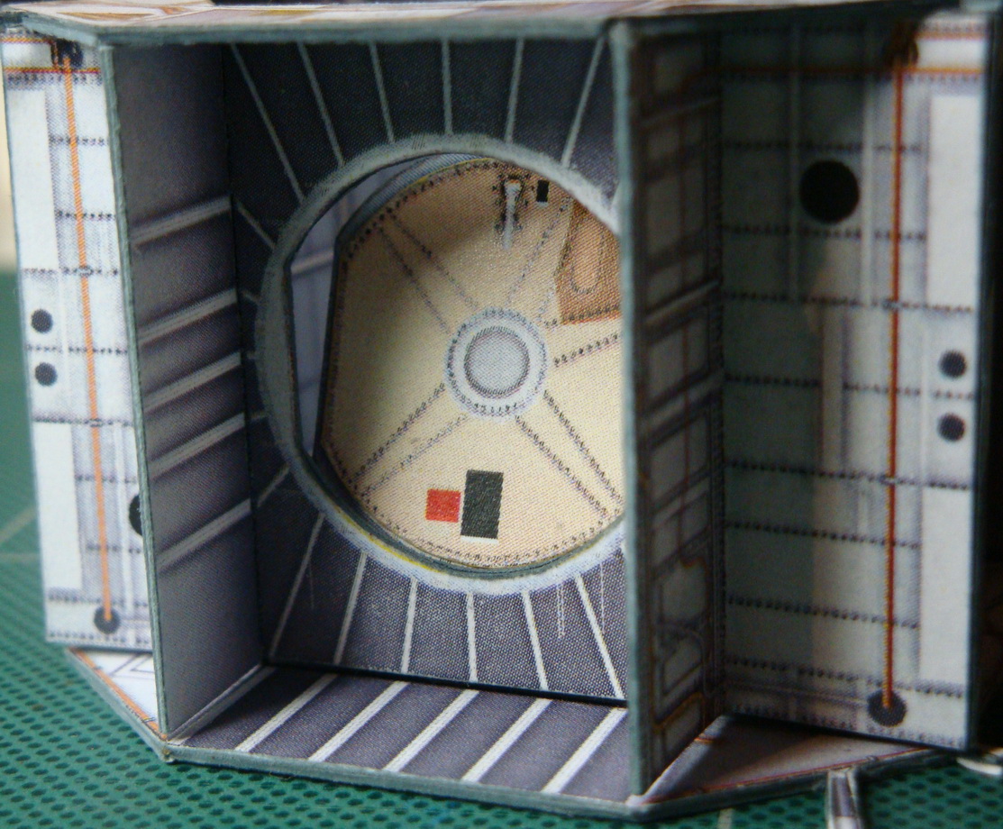

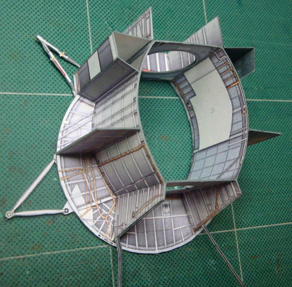

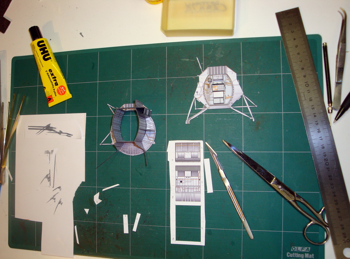

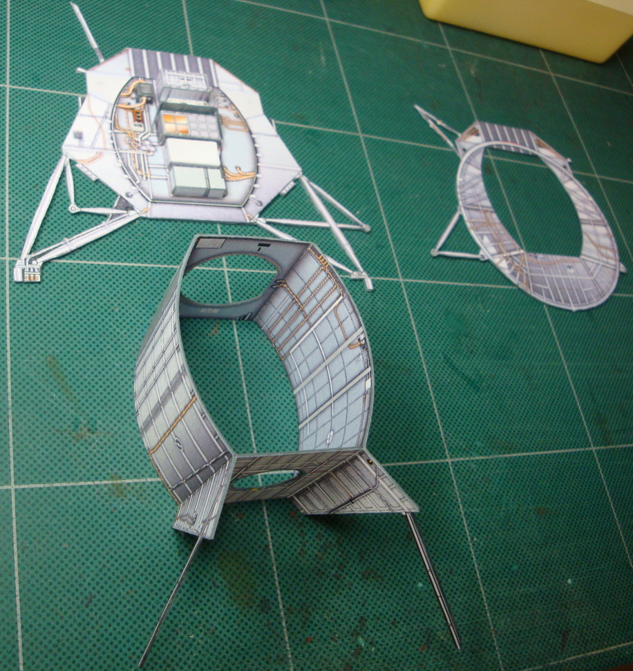

Well, let's proceed. Here's a little update.

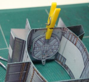

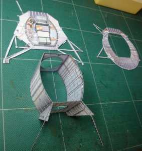

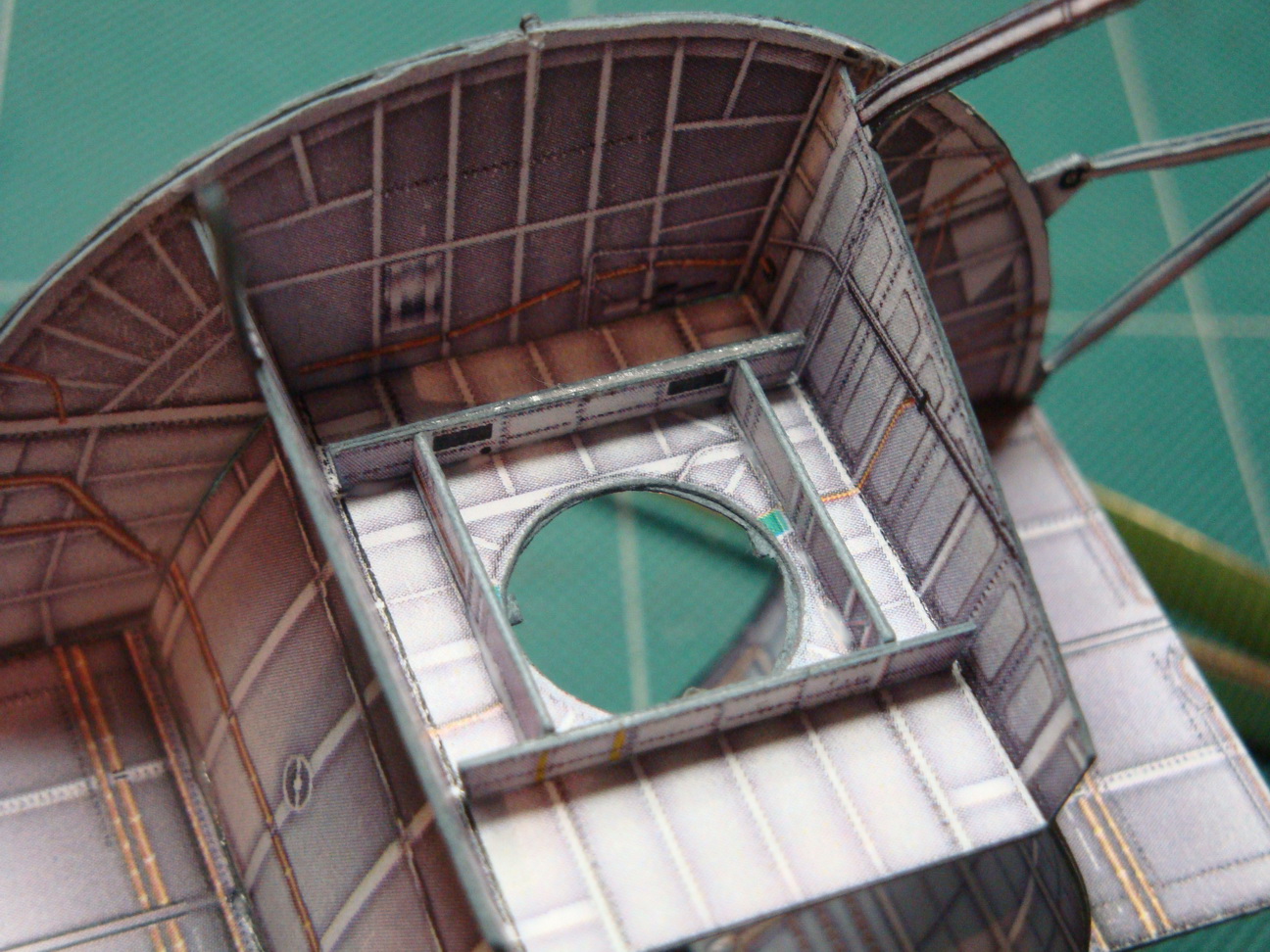

The side walls of the rear compartment.... Cutting work in progress.... Side bulkheads in place

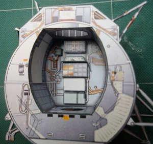

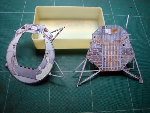

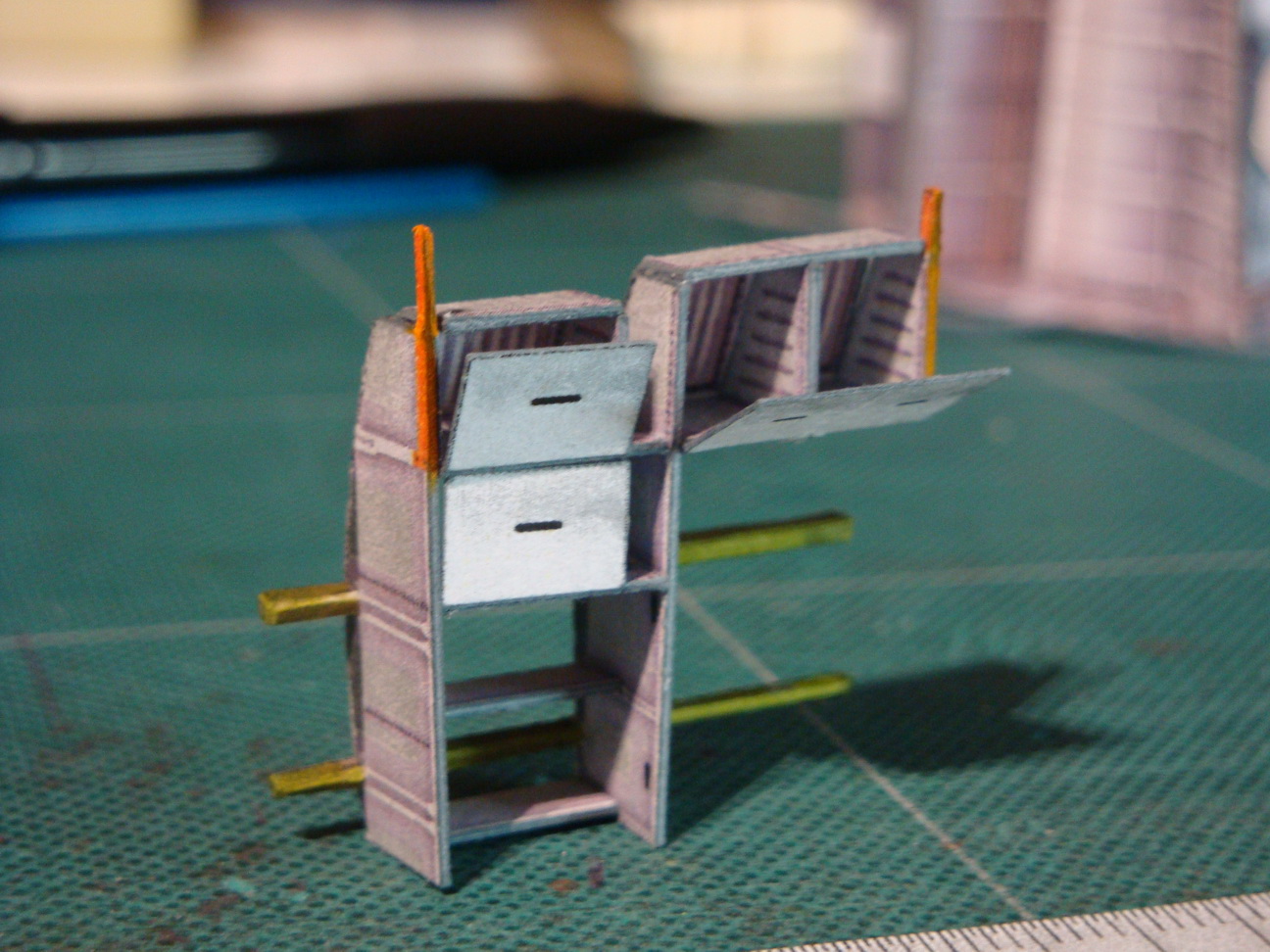

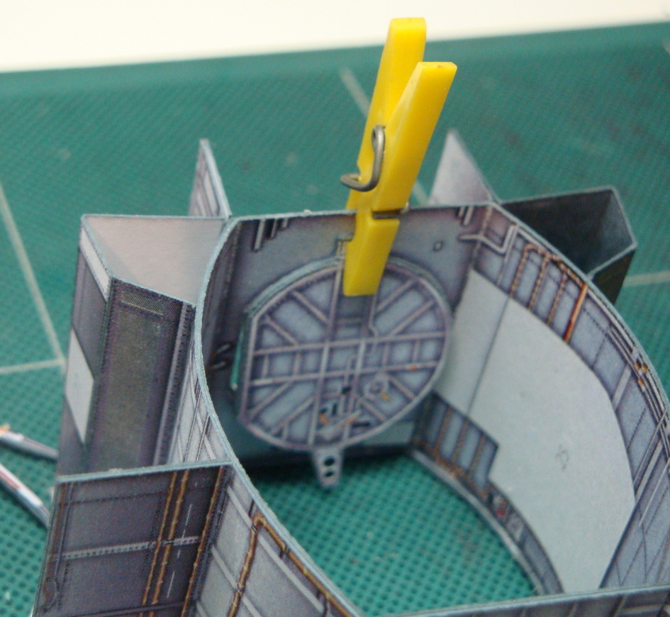

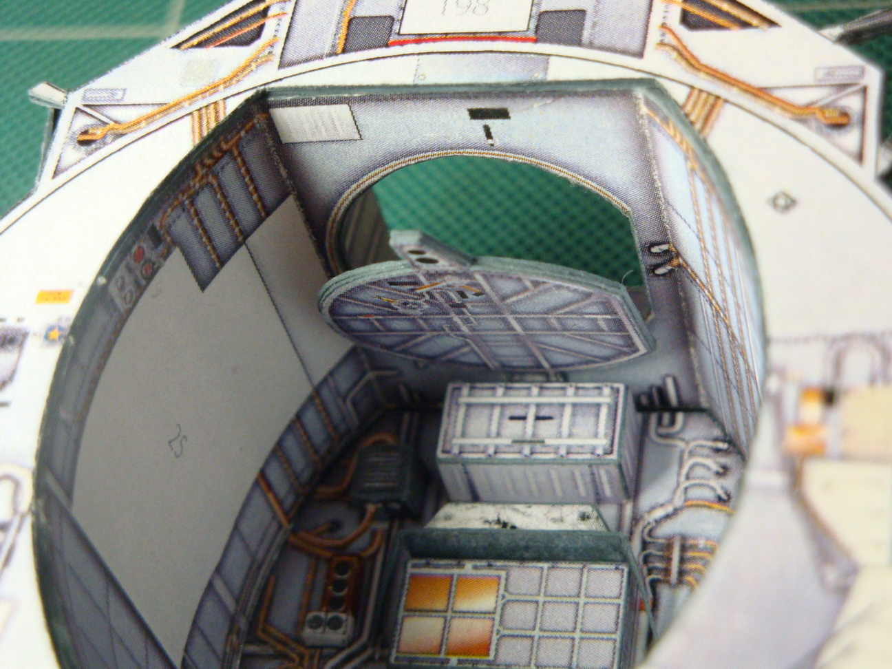

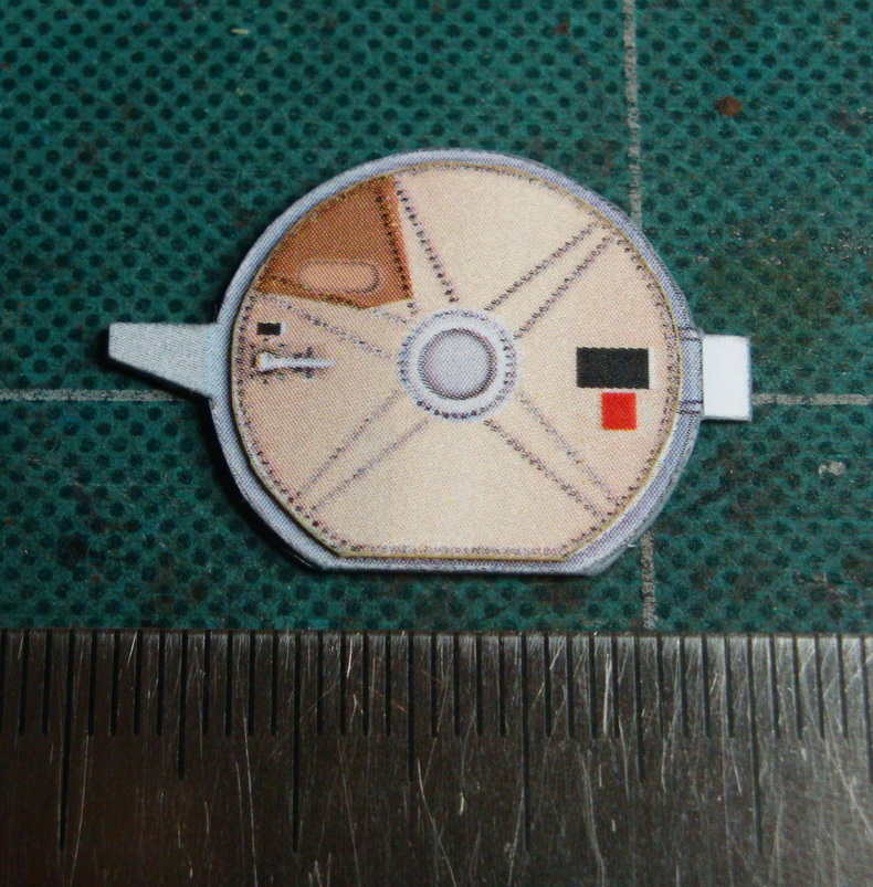

A test fit without glue of the rear wall..... Assembling the upper hatch

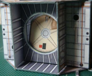

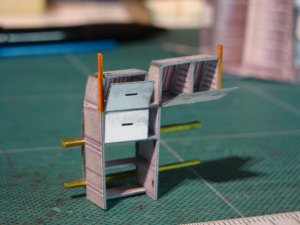

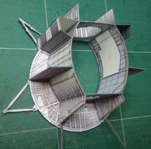

Ascent engine mounting frames..... To keep in place tiny parts you have to invent a lot of tricks

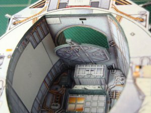

A view of the open hatch from inside and from outside.

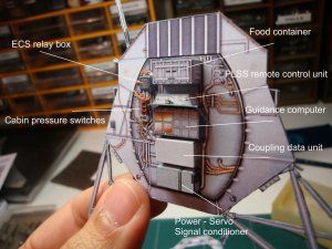

A little update.
Now starts my favourite part of the work: detailing the interior.
There are a lot of tiny parts to build with my big fingers...

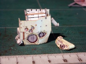

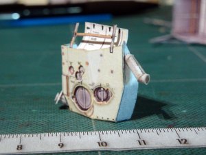

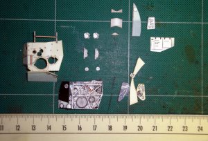

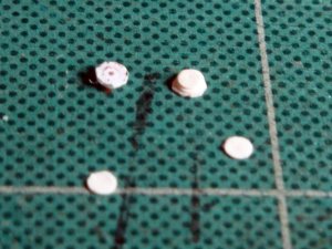

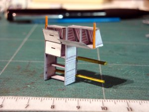

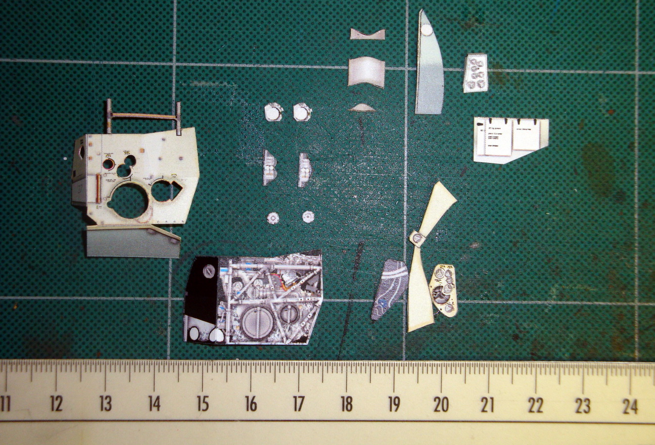

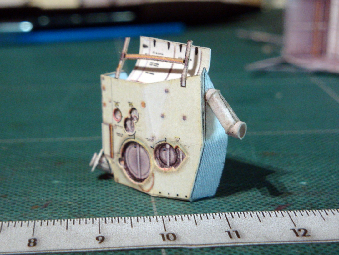

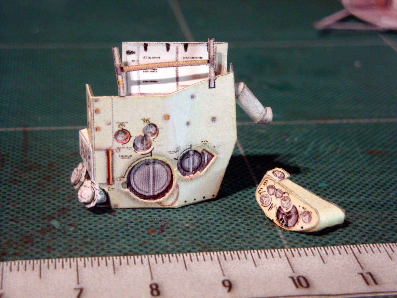

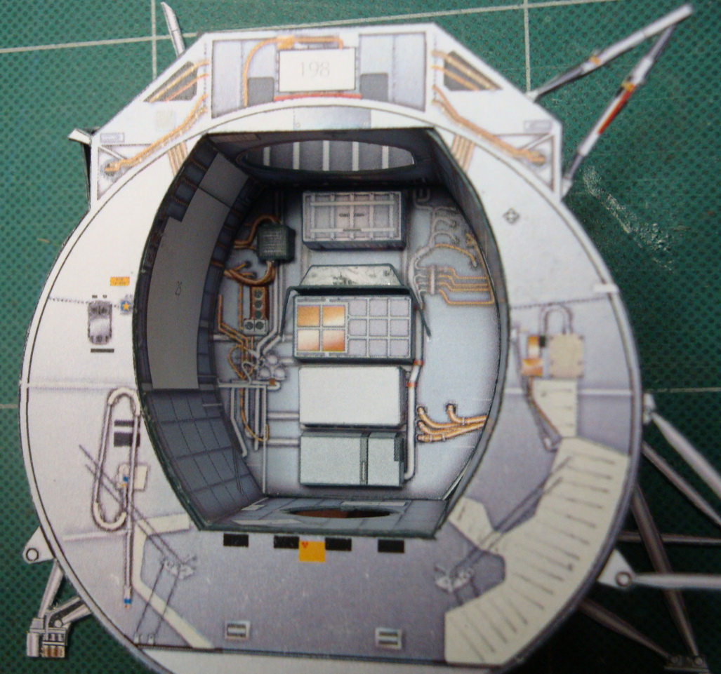

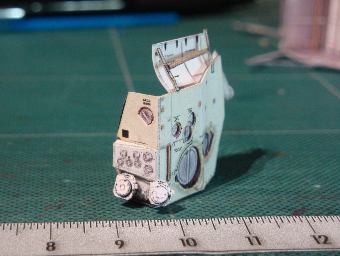

The first challenges are the ECS (environmental control system) and the water control module. Here are all the parts ready to be folded and joined.

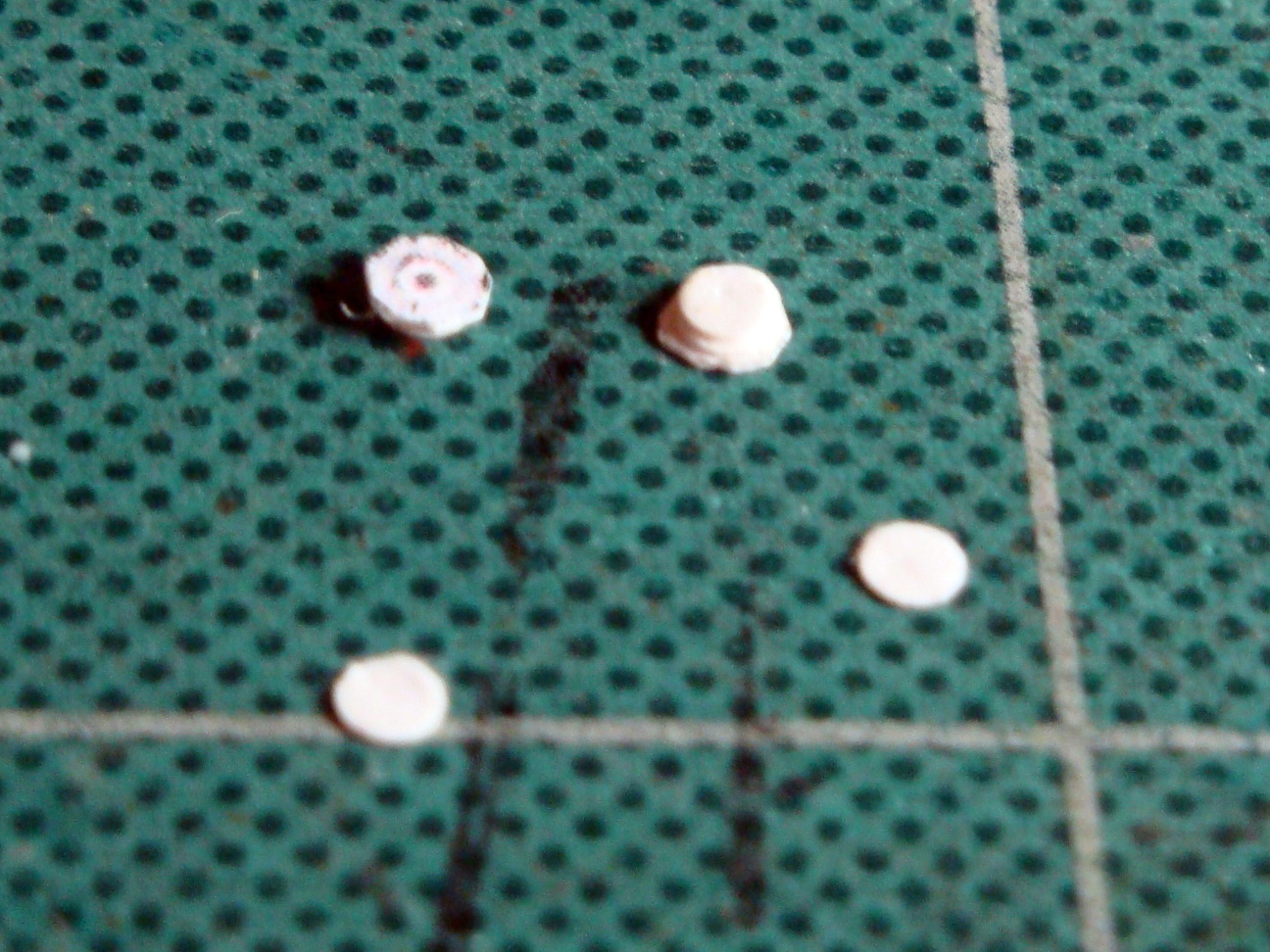

I added - under the knobs - two 2mm. little discs to raise them a little and appear more "tridimensional"

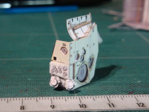

The ECS finished. In the middle photo the water control module, a very strange shape for a very little piece...

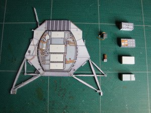

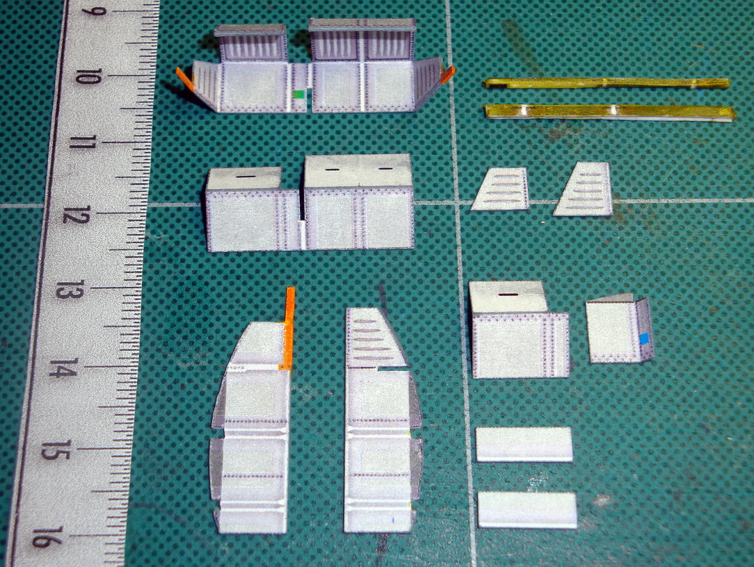

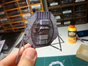

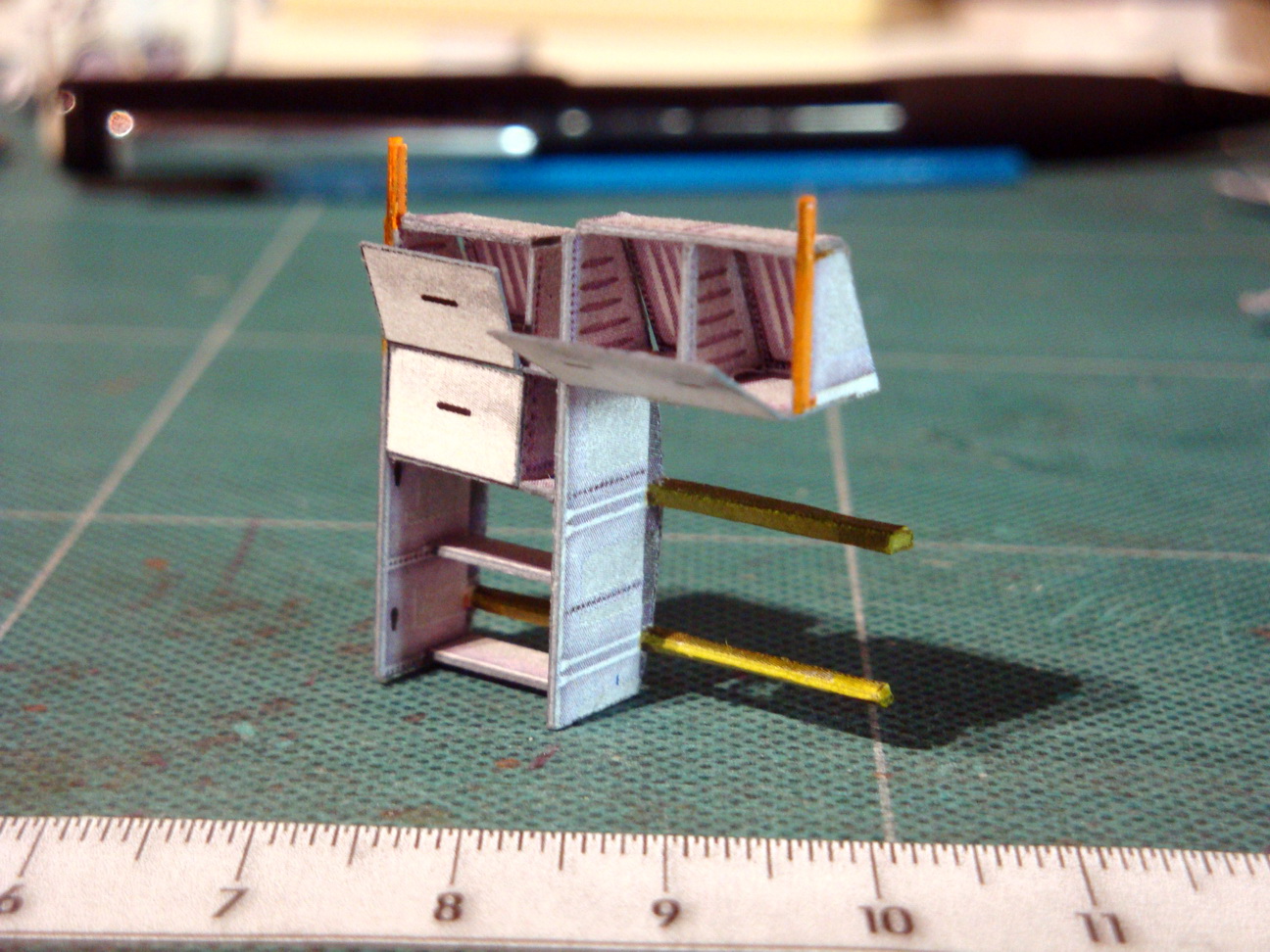

The left hand mid section stowage, before and after some precision work...
Observing those photo I realize that my printer should have a slightly lower resolution than uhu02's one. His parts seems to have a very better looking than mine.
The difference perhaps is so evident only at a very close look. I hope the general appearance will not be affected too much by this "technical issue".
