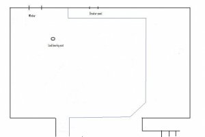

I have been trying, with no good results, to design a track plan. I have tried Xtrk, RTS, hand drawn (which I came close to success with but a MRR guru at the LHS looked at my plan and said it would never work but it looked cool).wall1wall1wall1wall1:curse:
I have basement space in a room that measures 17'x18' roughly. I will not be able to use all of that space because of storage and residential maintenance needs.
Attached is a drawing of the space which is not to scale.
This drawing indicates the useable space, which is inside the blue line. The area to the left of the drawing needs to have 48" for storage, and the area at the top needs to have 40" for breaker panel access and a work area. The window can be covered. I do not have the measurements pertaining to the load bearing post. I will add those tomorrow.

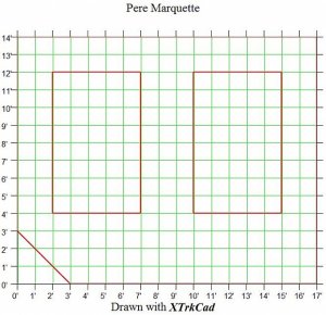

I am considering this design for the benchwork. I don't have it situated in my head where, if at all, I am going to put the helix.
I can't even situate in my head how I am going to compress that yard to fit onto this. I am considering changing the 4' section to 3' and increasing the 3' to 4'.
I need to take my pain meds and contemplate that.

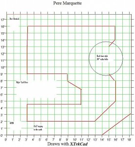

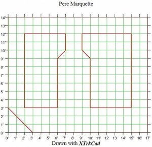

I changed the benchwork picture. Narrowing the top throat of the center section. If I can manage to get the design out of my head and onto Xtrk, or even paper, the narrow throat can be left as an open lift out during operation.
I need to change it again to show the entire rooms dimensions and include the 8'x3' staging section that could be utilized.
I should probably make the narrow throat at least 30", but I don't know how to mark the benchwork by 6" rather than 12.
